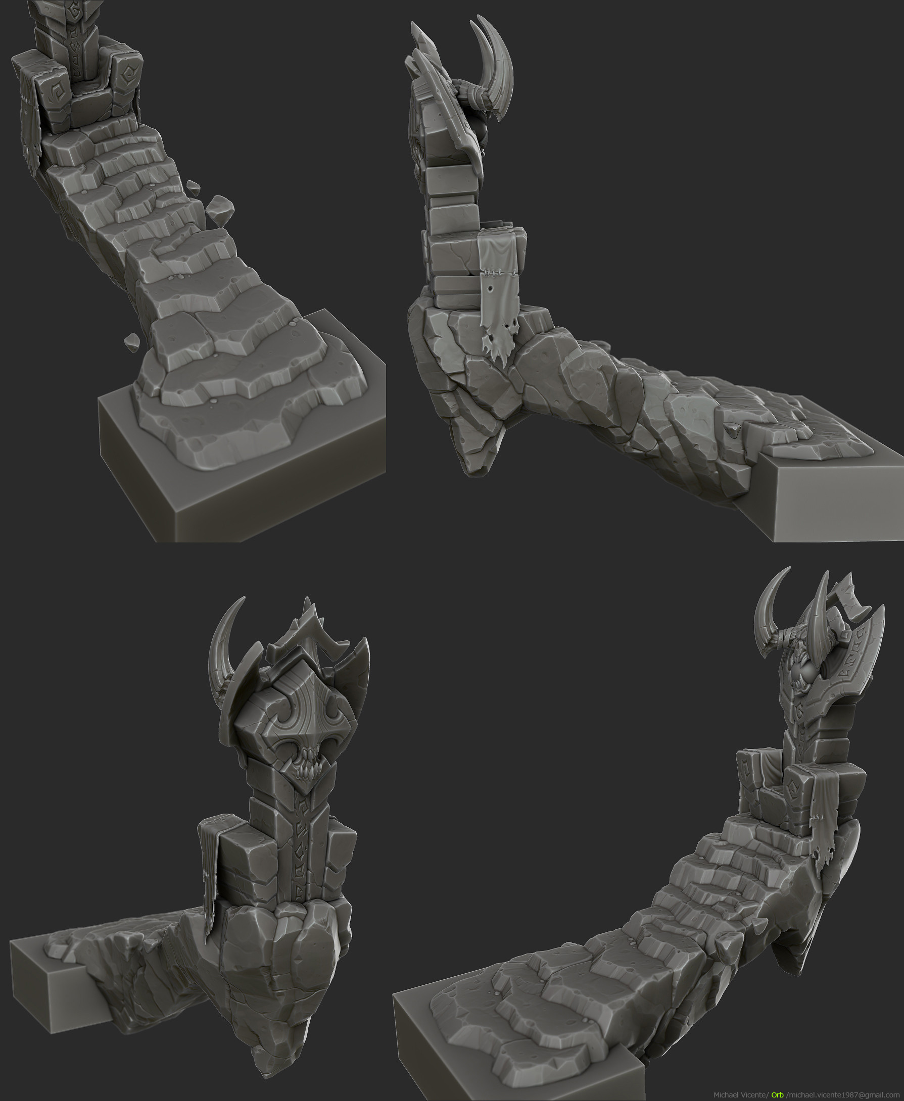

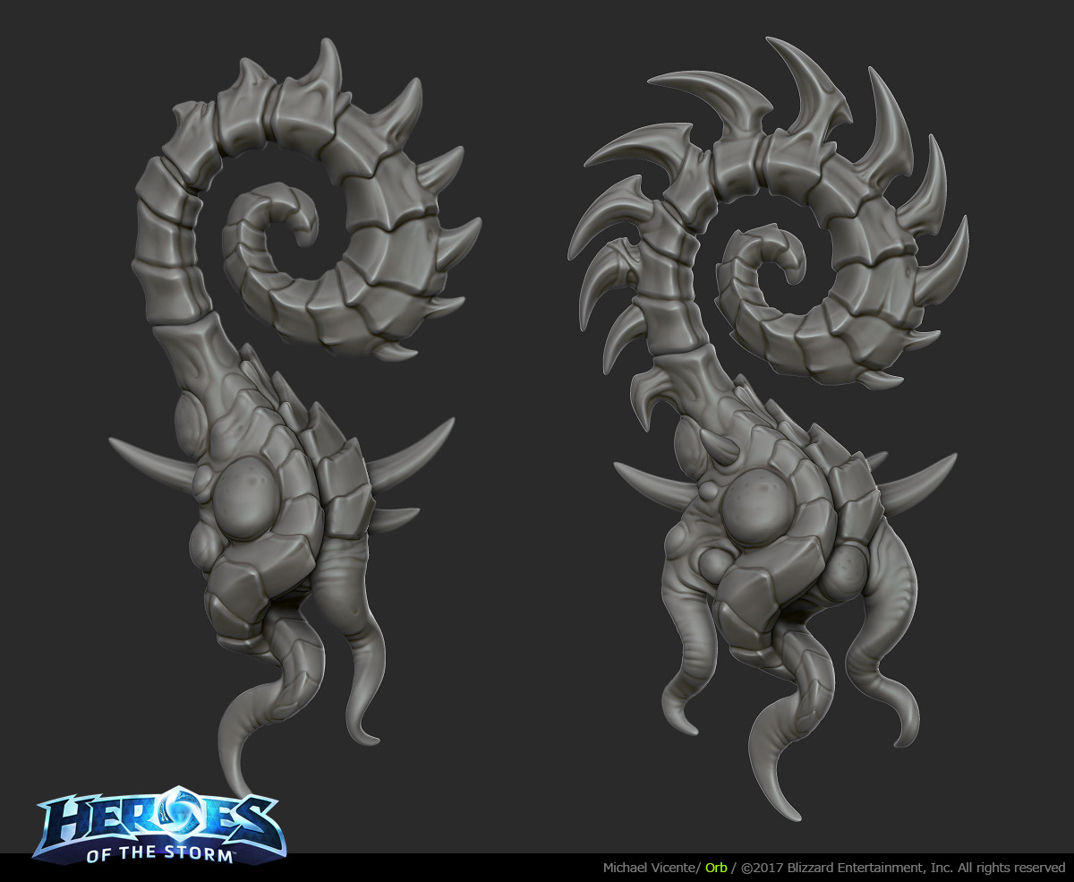

Any tips on how you get your sculpts so ‘clean’… it’s the one thing I have trouble with. All your edges are so well defined and there’s not a single brush mark to be seen. Is it just a case of careful polishing or is there more to it? would be awesome if you could share some insight on how you go about this.

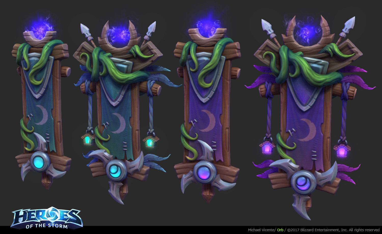

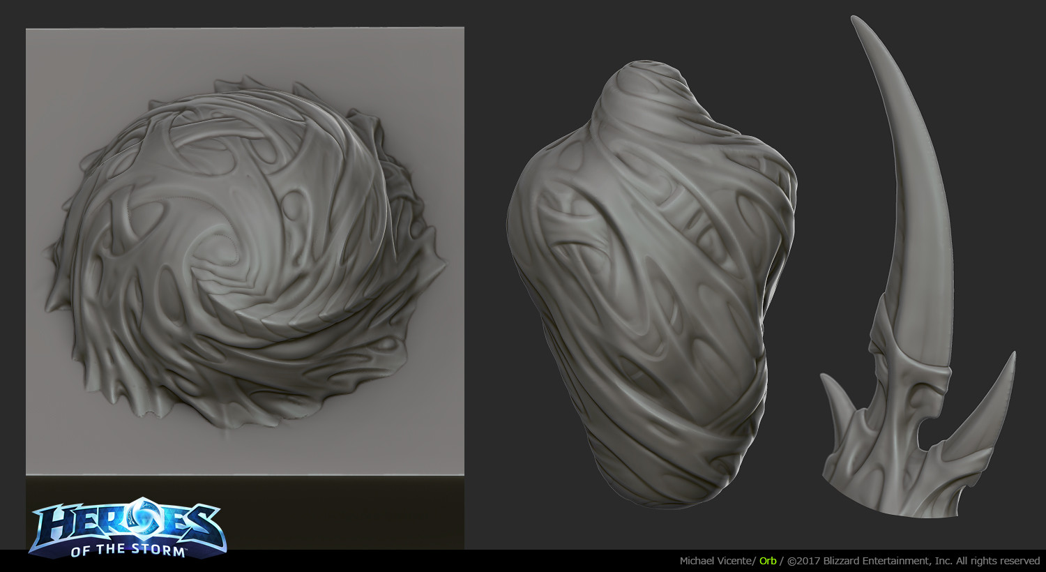

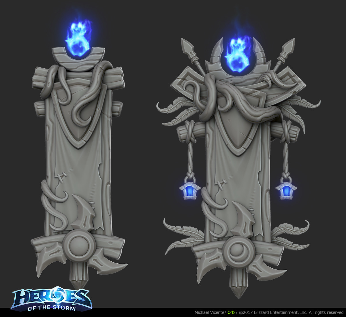

Love It! Great work as usual! I love the overlapping details you acheived with these textures. What were the techniques you used to achieve this?? Thanks!
I love the overlapping details you got in your organic tiling textures! What techniques did you use to achieve this affect?? Fantastic work as usual!

That’s a question I get a lot. I don’t really know I guess I’m very nitpicky lol. My main brush is the flatten brush with 100 intensity. I also use flatten with ALT, I think thats’s what gives me the most clean stuff, cuz it fills the cavities first like a clay behavior. I also just got used to my detailing maybe, I always clean my details with flatten, smooth and planar brushes.
Jazzon3D:
Thanks man, for the overlapping techniques, O’m assuming you’re talking about the “hell creep”, the organics tendons. I used basic alphas shapes made in photoshop to layout the tile, then Its a mix of damn standard, with zsub zadd, to have a “folding effect”, usually the sides of the tendons use zadd so the edges pop out with bevels, just try to draw a couple brush stroke with zsub zadd, zsub zadd next to each other and smooth the top and end, you’ll see what I mean hopefully.

What’s the gray material that you use?

I have another question If I may…

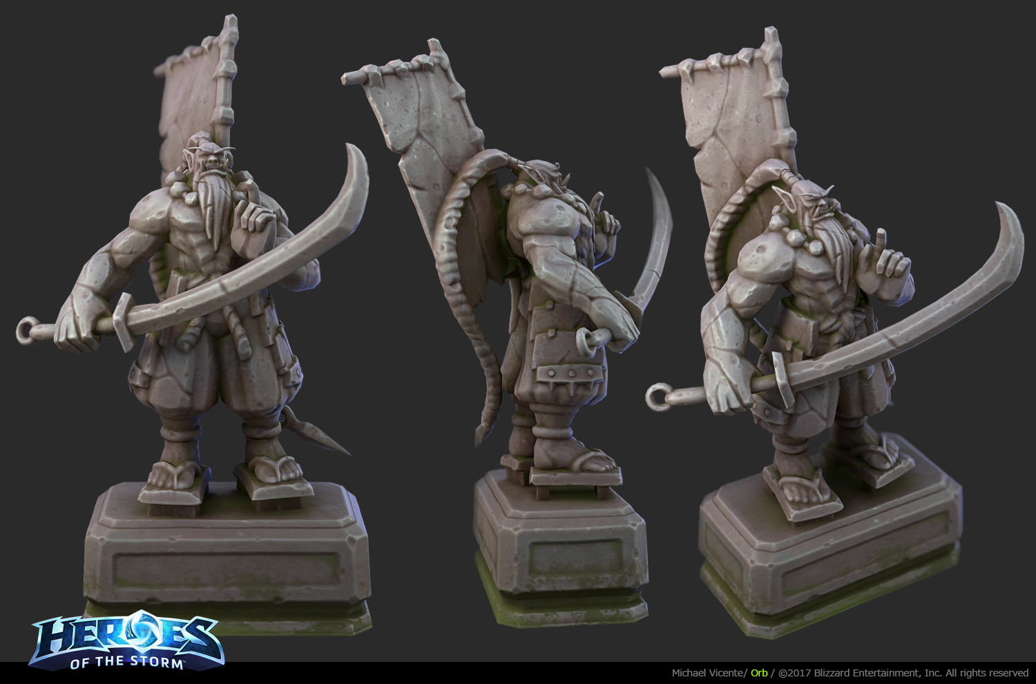

When creating environment pieces such as the modular architecture or props that need to be a specific size / proportions, do you first create a base mesh in your 3D app and use that as reference / base sculpt mesh? or do you create the sculpt in zbrush first and worry about the size later?
With Zbrush having no ‘real world’ unit system this is something I’ve always been unsure about.
I generally import a very basic size reference model and then create as much geo as possible in Zbrush. Just wondered if there was a better way that I was missing.
thanks again for taking the time to reply.

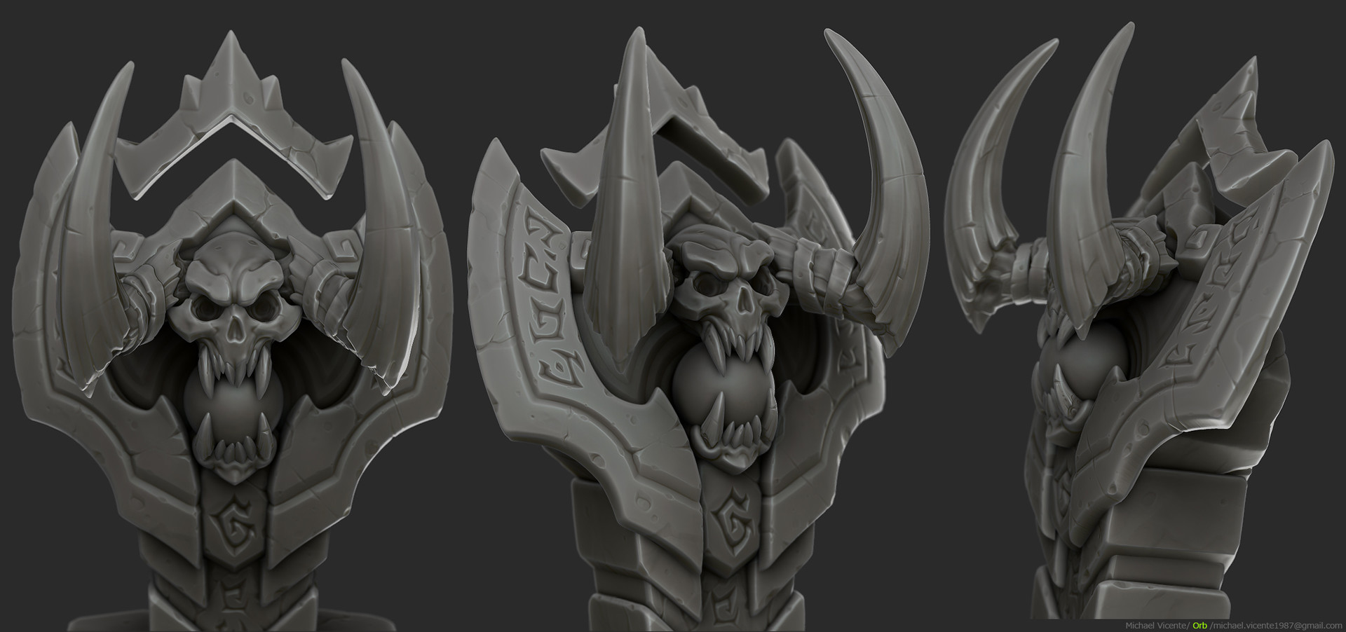

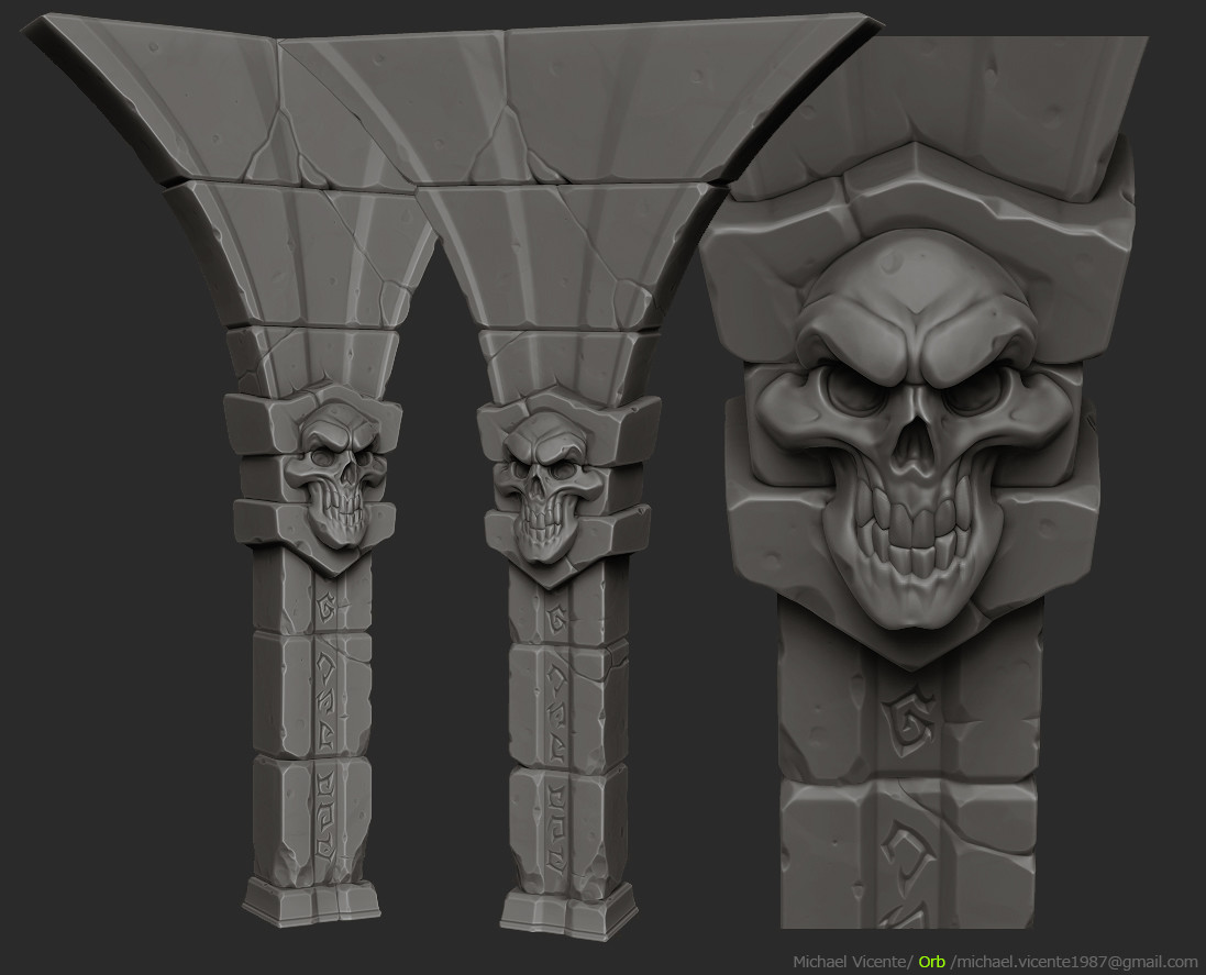

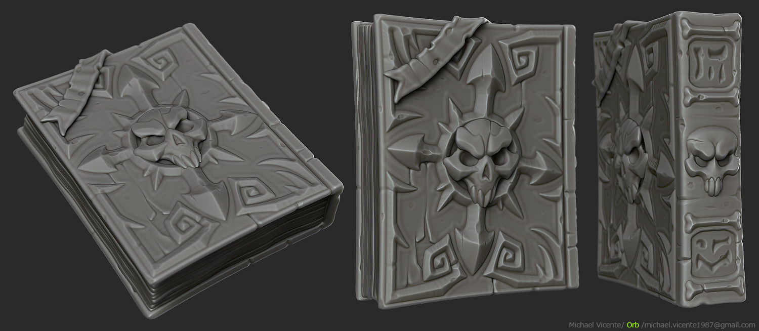

Quick question: how do you sculpt the circular grooves on your reliefs? I always find it hard to do precise shapes (circles, straight lines, etc.) in ZBrush. Of course, it could be poly modeling the grooves instead of sculpting I guess.

sorry late replies!
@rob_beddall:
yes, I try to match a real life scale, because it impacts a lot the ambient occlusion bake, if your mesh is super small you’ll get different AO then if it’s huge, so I try to be relatively correct, at least when I bake.

Not sure to understand, you mean the runes? if that’s the runes, I use a very useful way, and actually very easy, I use photoshop to make the shape I want, and then inner glow effect, with chiseled mode and 100% opacity, then you can basically control your bevel in photoshop, all you have to do is drop that alpha on the model and mask>polish to clean it a bit. Again I’m planning to actually demonstrate that tip on a video, I actually use this a ton.

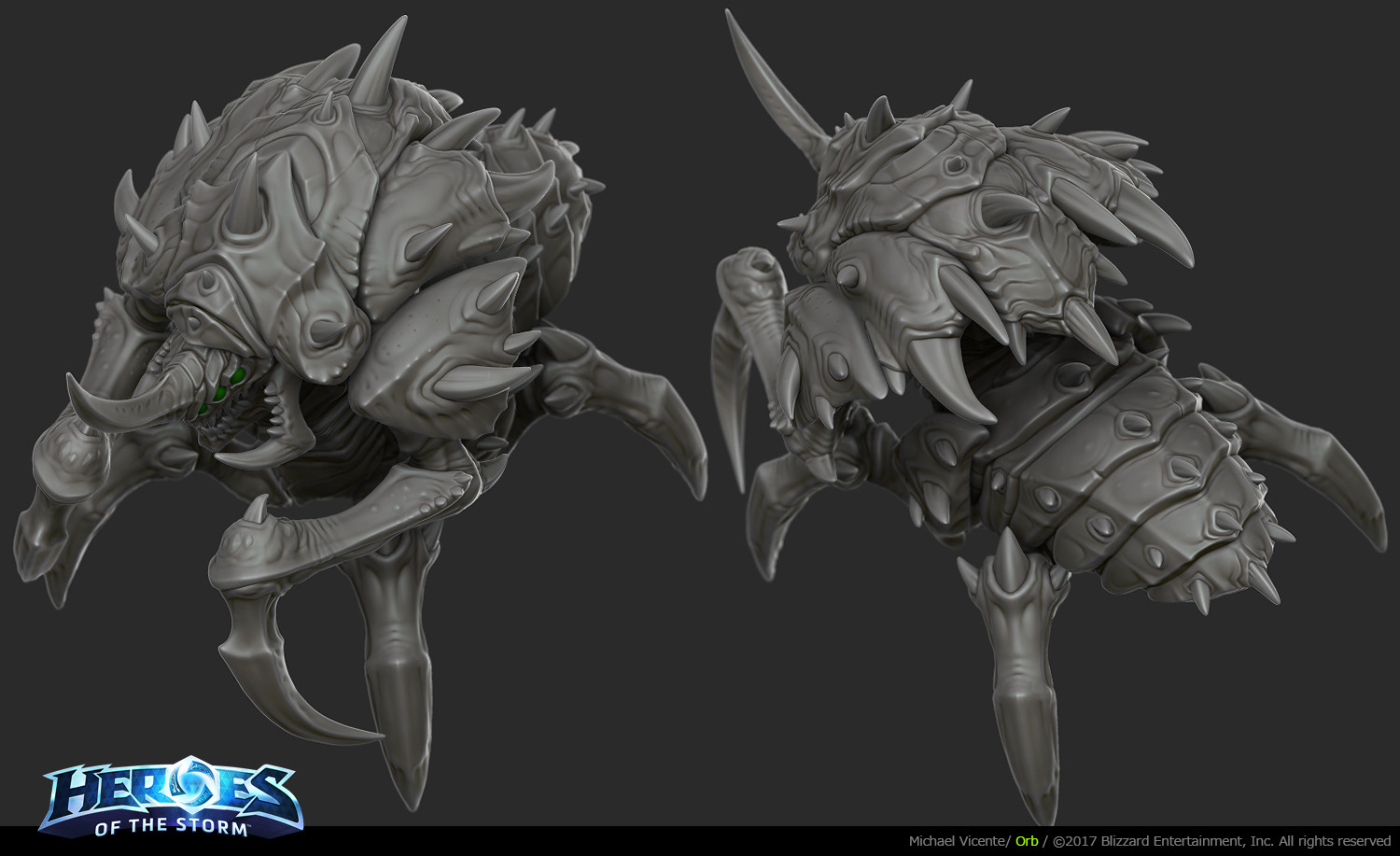

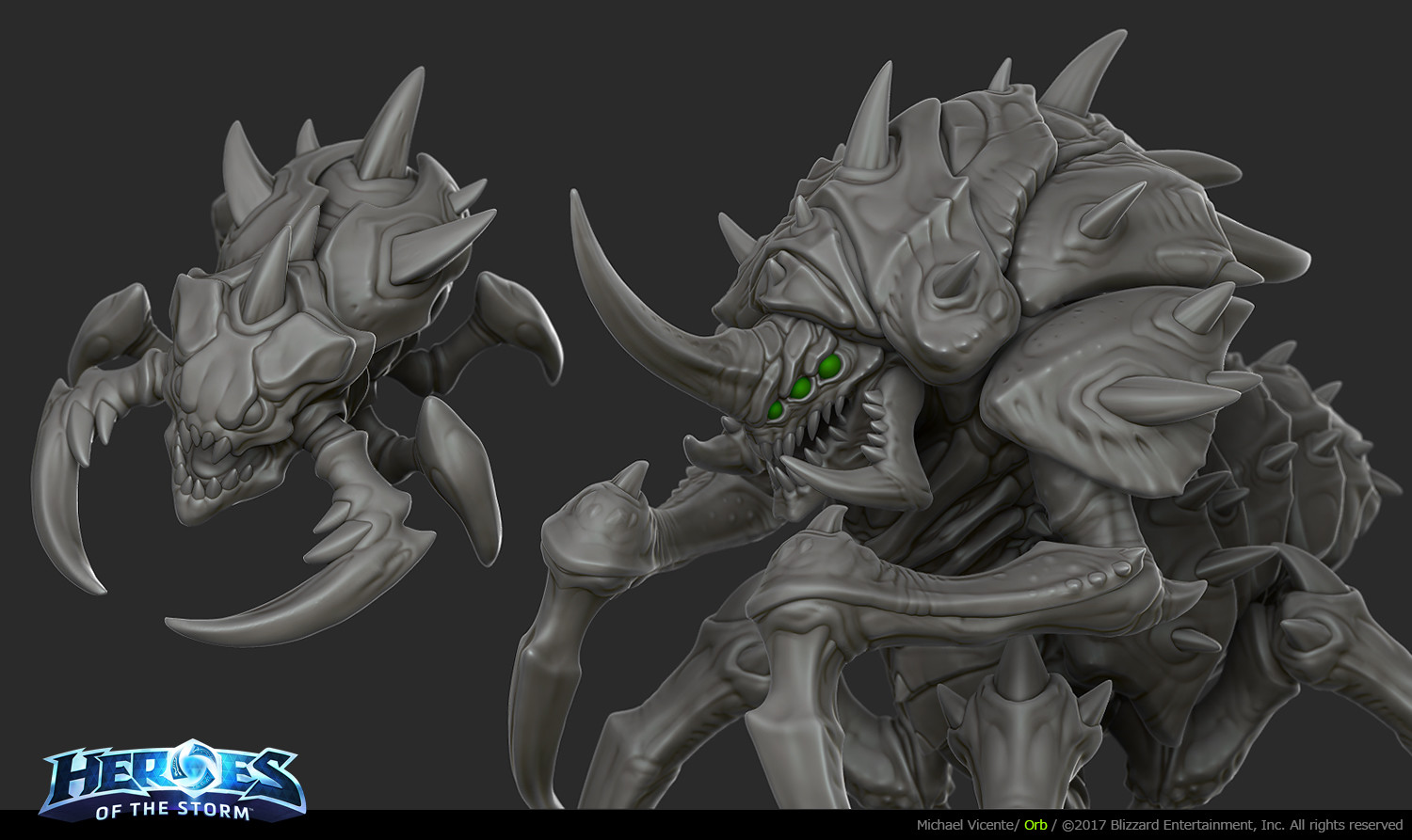

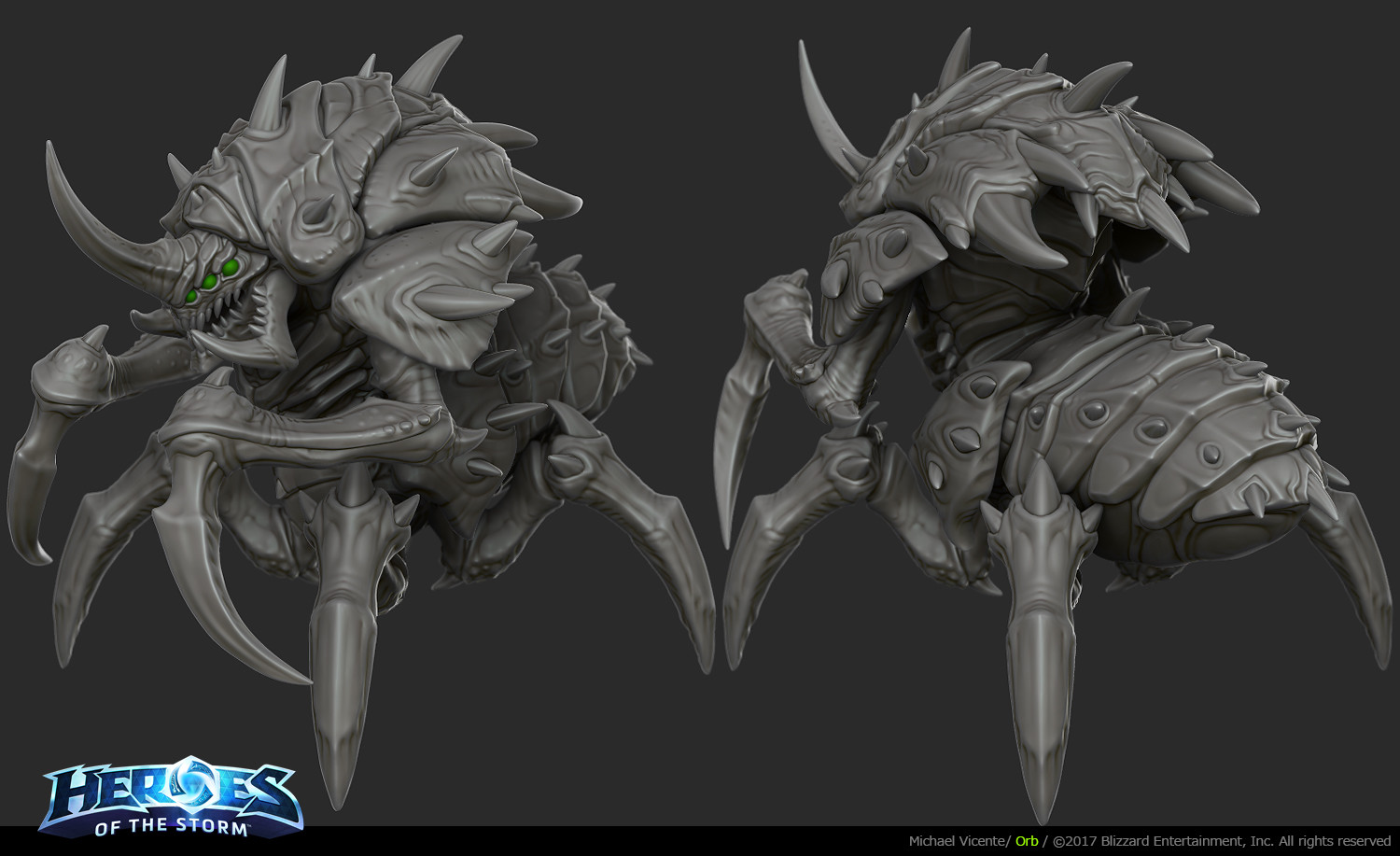

Hello guys,

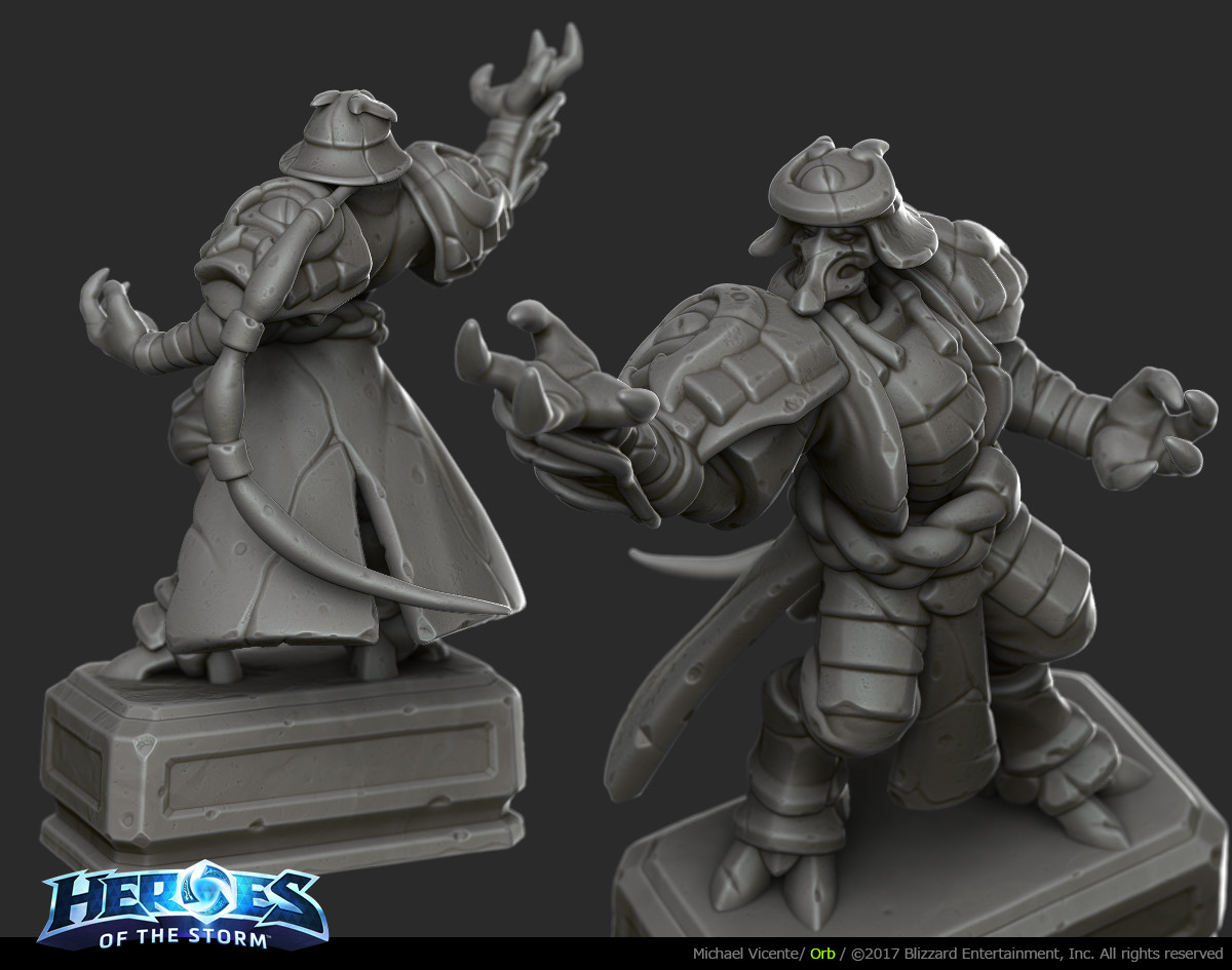

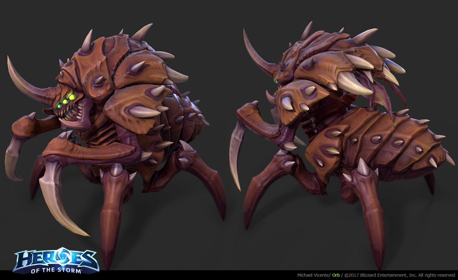

I wanted to share a skin that came out recently on heroes of the storm, something I had a ton of fun working on. For both reasons: I was in love with the idea/concept (from luke mancini “mr Jack”) and also because it was my very first skin in the game (I’m an environment artist mostly, I do some minions but this was my first playable character). I hope you like , it’s a mix of Anubarak and a lurker (zerg unit in starcraft)
Thanks a lot!

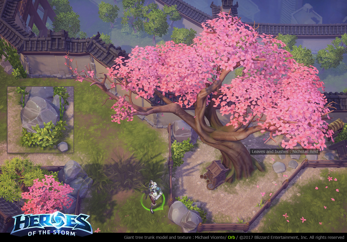

Also adding some of the stuff I did for heroes2.0, so I can mix some environment art for anybody whop likes it
