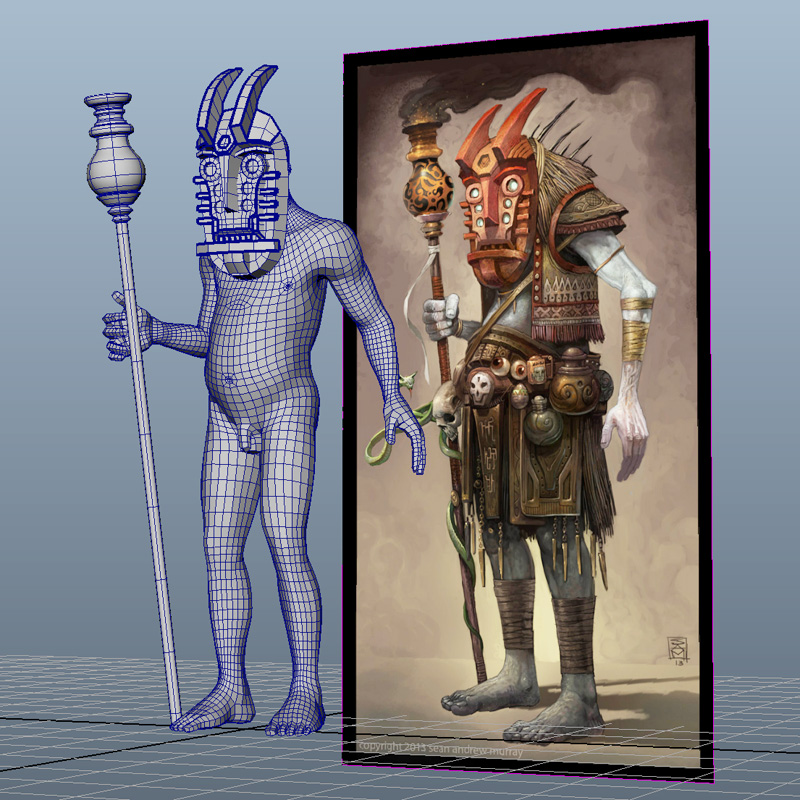

I discovered the incredible concept work of Sean Andrew Murray a few weeks ago and gravitated toward this character. He gave me permission to do a 3d sculpt and I’m using this as a test bed to eventually bring into Modo to do my turntable render.

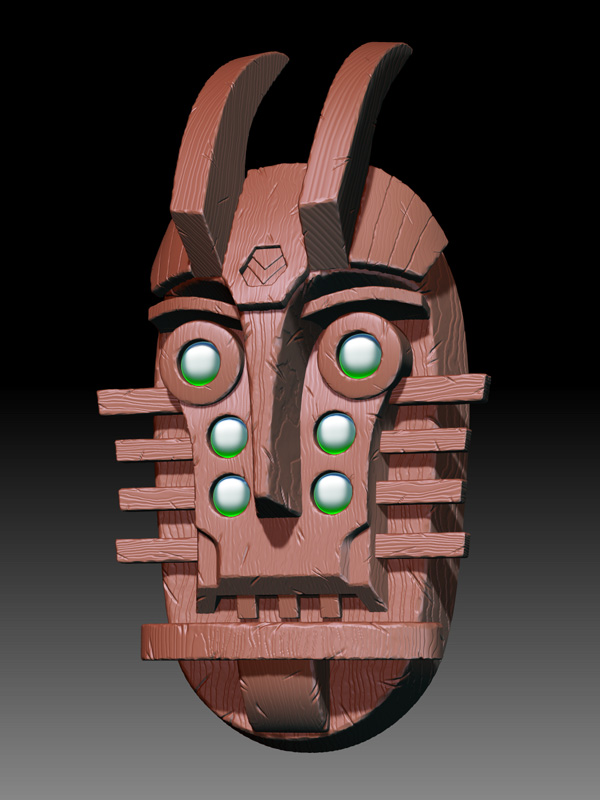

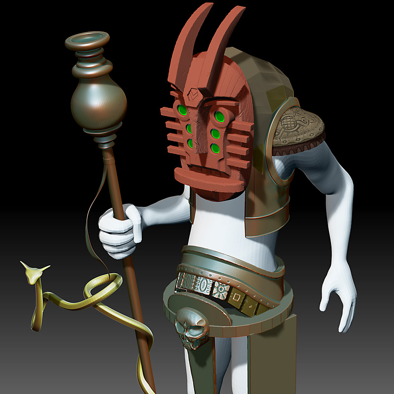

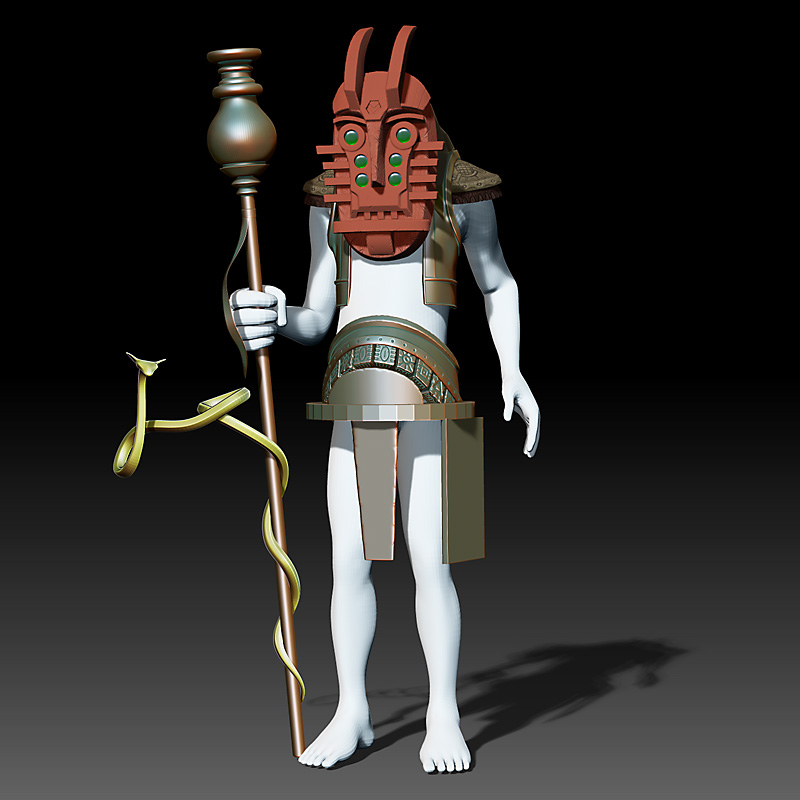

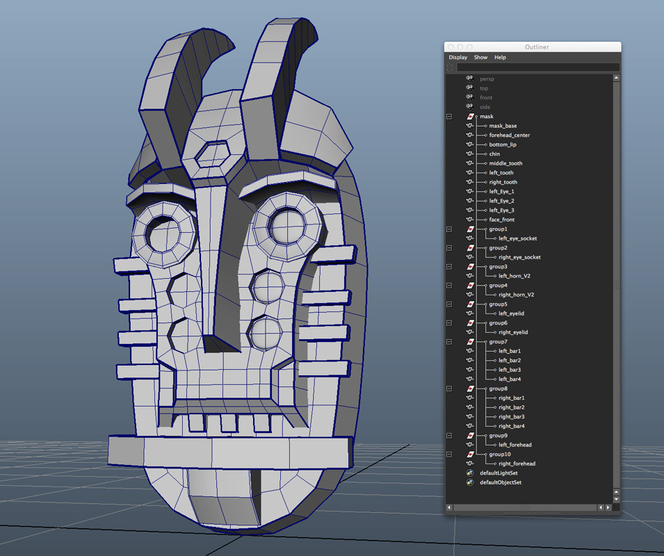

At 27 subtools just for the mask, I’m already hitting 11.186 million(!) TotalPoints. My machine (an early 2008 Mac Pro w/12GB Ram) is holding up ok, but it’s starting to take a long time saving the file and mirroring subtools. I did discover that lowering the subdivisions for all the subtools before performing the needed mirroring seemed to help speed things up.

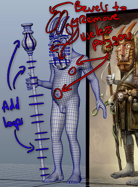

How do people generally go about managing a character this detailed and keeping the workflow reasonable? Do you treat section separately and append them later? I’m attempting to do as much pre-planning before I bring in components to ZBrush. I’m using Maya to create my base meshes and setting crease edges before GoZ-ing stuff over. I just can’t see carrying all of the geometry for this character inside a single ZBrush document. Thoughts? Workarounds? Workflows?

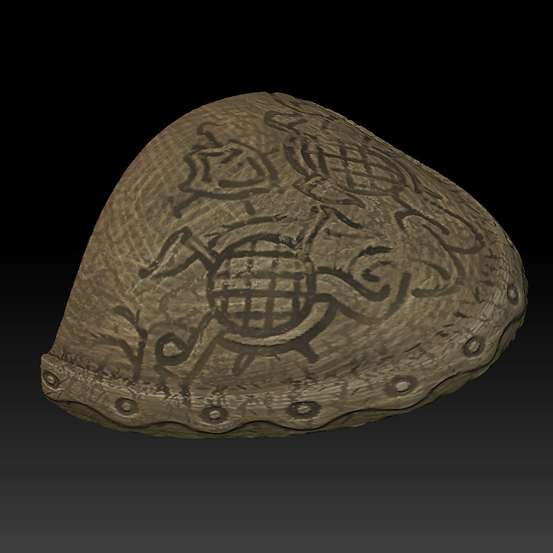

I’ve already learned a great deal just with the mask portion. I’m (finally) utilizing layers by building up my levels of detail - i.e., Layer 1 is wood grain, followed by Layer 2 “dinged edges” and Layer 3 “scratches” for each subtool. Is it typical to carry this history for each subtool, or, is it wiser to bake all the layers once everything is finalized?
After adding this level of detail, will I need to do a retopology pass for every subtool before generating my displacement and texture maps? Or, can I simply bump down to Level 1, generate the maps and use the base geo I had originally prior to importing into ZBrush? I know there are different workflows for this depending on whether the piece will end up in a game engine VS a commercial or film project. I don’t currently plan on animating the character - I only wish to generate a hi-res turntable.
