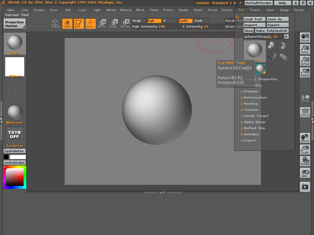

okay I know I seen it some where with working with zspheres although I am not sure if that represented the number of current poly counts or not. but I can’t seem to find it with mesh objects. Where do I look to see how many polys my object has currently?
Sorry if this is in the wrong forum… please move it if it is so that I know where to put this type of question at. Still getting used to these forums here.
Andreseloy
doh okay now I feel like a real idiot…:lol: thanks :smiley:
