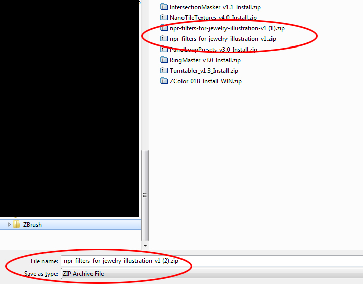

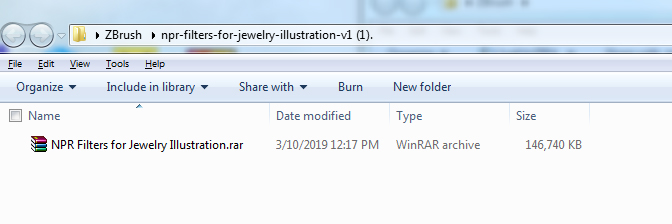

Just a note: the .rar file, that is packaged inside the .zip file for your filters, seems to be ‘broken’ or ‘invalid’ when I try to open it.
Check out you uncompressor, there isn’t any .rar inside of a zip, you just download one .rar file
I tried the download several times
 all that shows is a .zip file.
Opening that shows the .rar file

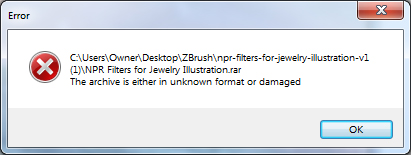

Trying to open that gives the error:
Edit:
I even tried to right-click and change the original download file type manually to .rar format, But it still ended up with an enclosed .rar file that wouldn’t uncompress.
Looks like that you haven’t got the winrar ap installed, here you can download the .zip format: zip
Thank you for the Dropbox .zip file. That worked well, and I have the working ZBrush files now.
(However, I do have the winrar ap, and have successfully opened other downloaded .rar files with it. I don’t know why this case was different, so I just wanted to let you know, so you could check things at your end.)

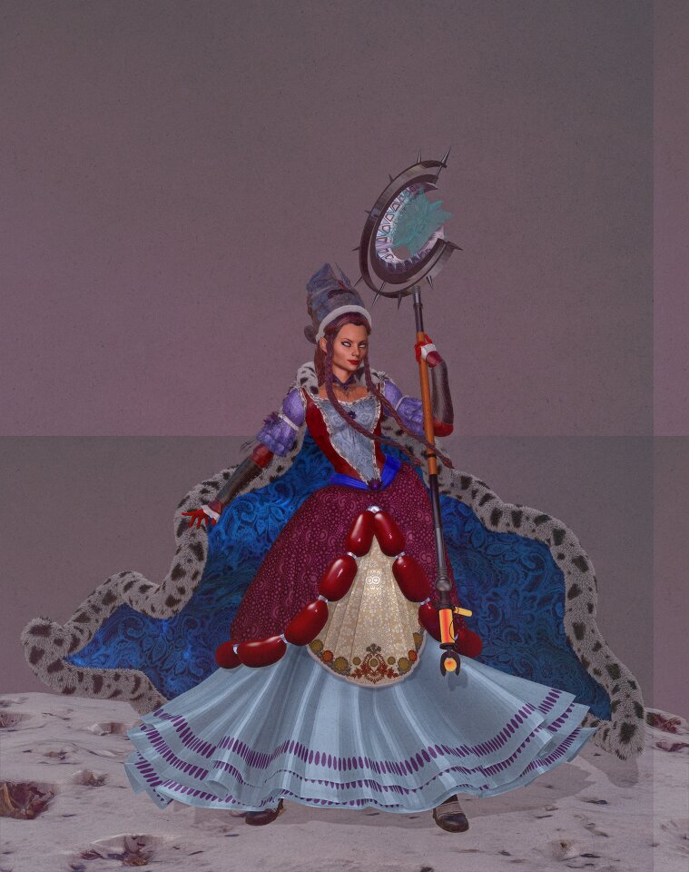

Thank you very much for these excellent NPR filters! I am trying to render an 8K image using JewelryV1 and filter number 7 (cardboard) is tiling:
Where can I find this image in order to resize and rotate it? The filter lists the image as a 23 character alphanumeric file name that’s 4992x3328 pixels - but I can’t locate it
CWR63, thanks! glad you like them! To set up the background image, on Filter number 7 adjust the Texture Overlay value to 0, hope that helps :wink:
That’s what I ended up doing, but that negates an important part of the NPR filter - it doesn’t look as good. I was just wondering whether that image was embedded in your filter, or drawing from texture files that shipped with Zbrush 2019, or was available somewhere on the internet? If all else fails, I guess I could render out a blank scene at the canvas resolution of the texture, but that might be missing some crucial element of the image, like color values.
Unless adjusting to 0 is different from turning it off
which is what I did
