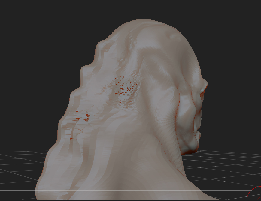

  4. sometimes when i try to smooth a section of the model it leaves certain areas untouched and creates a sharp “spike” in one spot that i cant seem to remove.
  5. sometimes when i smooth an area it will create holes in the surface where it appears that the material has disappeared.

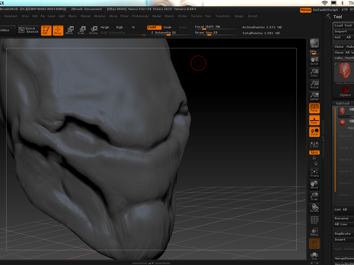

notice how the surface is really smooth on the forehead area but the polys are a lot larger on the chin area. why is that?
The forehead area is probably far more dense in polygons. With sculpting it can be better to have a wireframe/topology that has a more consistent density throughout the mesh ('evenly spaced quads), unless you know there are specific parts of the mesh that will require more detail.
