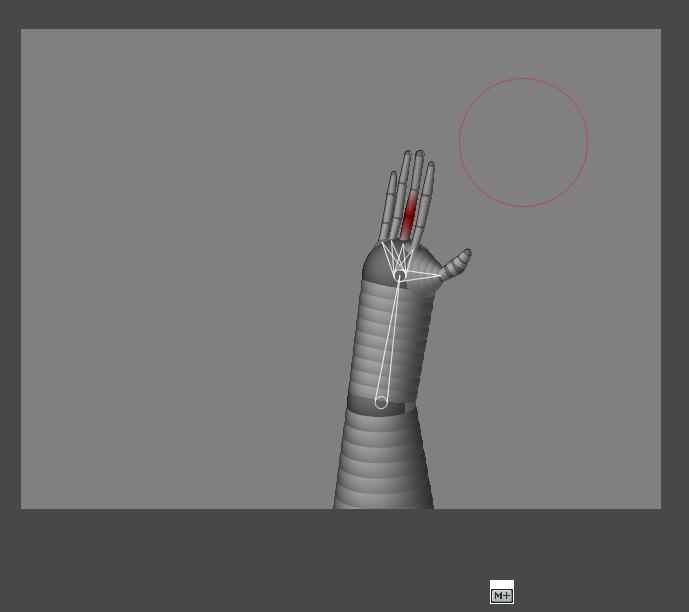

here it is, I was thinking just that, create an arrangment of zspheres which I can control much more acurretly, thx!!
[zspheresH.JPG](javascript:zb_insimg(‘37258’,‘zspheresH.JPG’,1,0))
Yeah, you definitely need to study how ZSpheres work a bit more. Your arrangement there has multiple ZSpheres connecting to the same “face” of their parent. It’s actually what I expected to see from your oringinal post.
Each ZSphere actually skins as a cube with six faces. You want only one child to connect to each side of that cube.
So what you want for your model is to create something of a fork-like structure with your ZSpheres, with each finger being a tine. This will give you a total of five smaller ZSpheres making up the palm, which will resolve the fat hand problem AND give you a much cleaner mesh.
Like I said, be sure to run that forum search and check out other people’s hand models. You’ll quickly get the hang of things. :slight_smile:
is this a proper hand topography then? http://www.zbrushcentral.com/zbc/showthread.php?t=23136
That worked because he adjusted the resolutions of each ZSphere before drawing them. The catch is that you’ll still get that fat palm that would need to be manually edited. If you don’t want to have that, you need a hand that looks more like a fork, with several ZSpheres side by side to form the palm and one finger from each of them.
