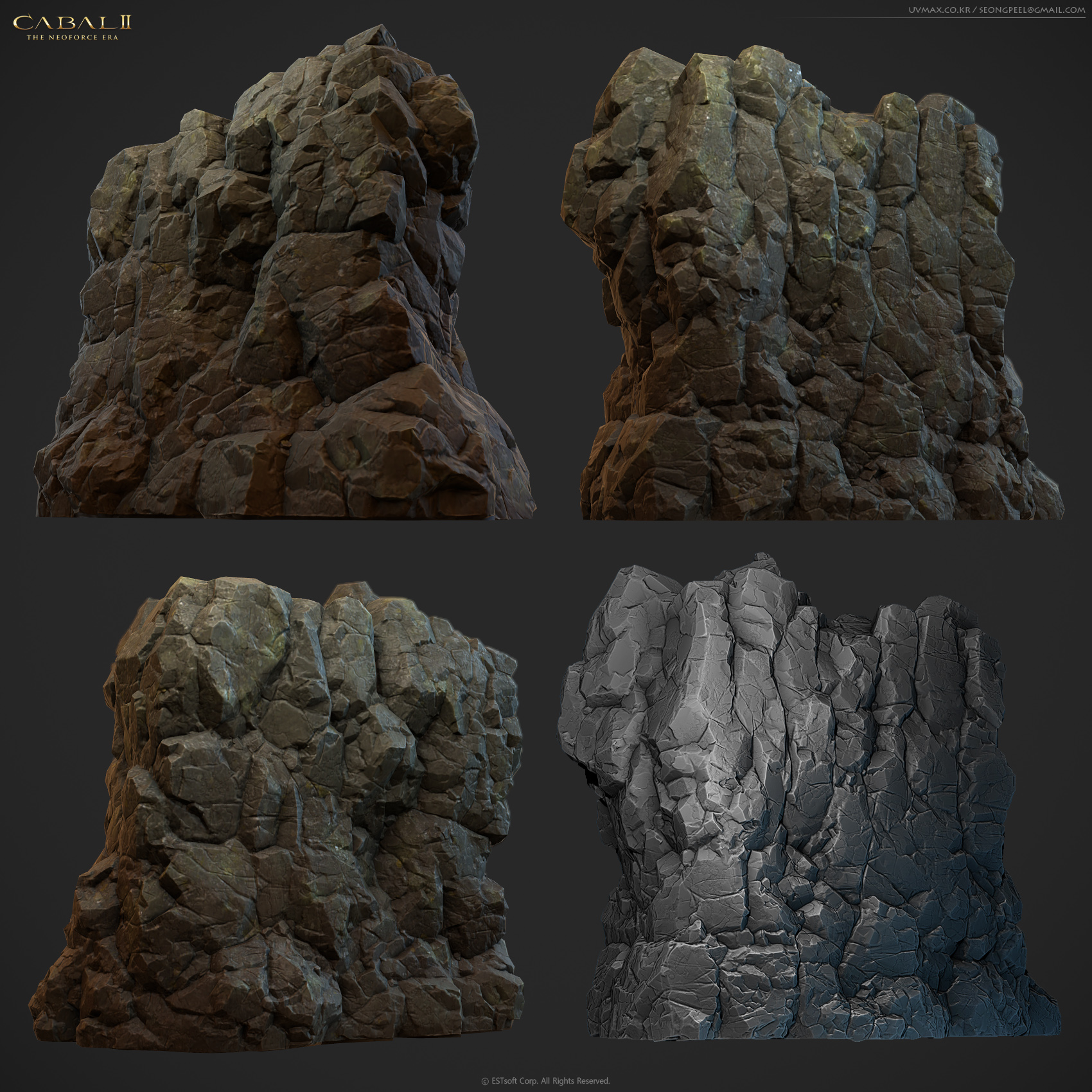

Hello. I wanna sculpt something like that https://pl.pinterest.com/pin/305541155972397702/visual-search/?cropSource=6&h=309.89331698344574&w=530&x=16&y=10 but i dont know how to start. Could You give me some advice? thanks.

Just i dont have idea about this rocks
Ok. Firstly, searching for “sculpting rocks in Zbrush” turned up a wealth of free tutorials, so maybe avail yourself of these resources. This is a very well covered topic.
For a sculptorly approach, the following brushes may be useful:

Try them, and see how the effects they produce might lend themselves to this task. This requires artistic skill, which no tutorial and nothing I can say here will give you if you havent developed it already.
- For a more procedural approach, some users might make use of Nanomesh for this task. Basically, attach a bunch of randomized nanos to a target surface that will generate rocky surface detail, then remesh it all together.
- Finally, the Clay Polish feature in Tool > Geometry > Clay Polish will help give a soft organic form some harder edges and may it look more rock-like.
@Spyndel i just think how to start the base shape. Make one rock then duplicate deform and position or on on the plane/cube make few
