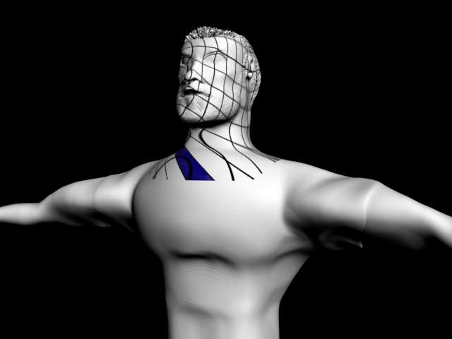

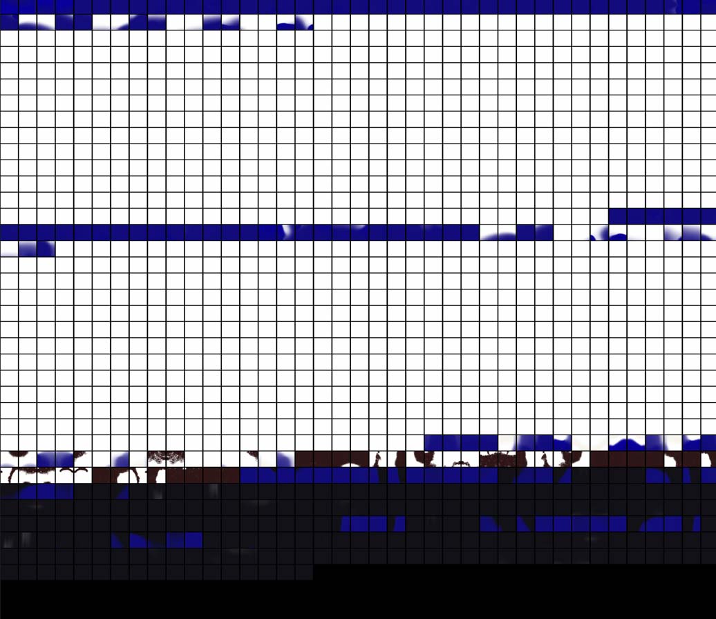

I can even export the obj to max but when I try to apply the texture in max that it created it just doesnt look correctly on the model and doesnt look anything like what i painted…
Are you remembering to flip the texture vertically?
If you continue to have trouble, please show examples. This goes a long way toward diagnosing errors.

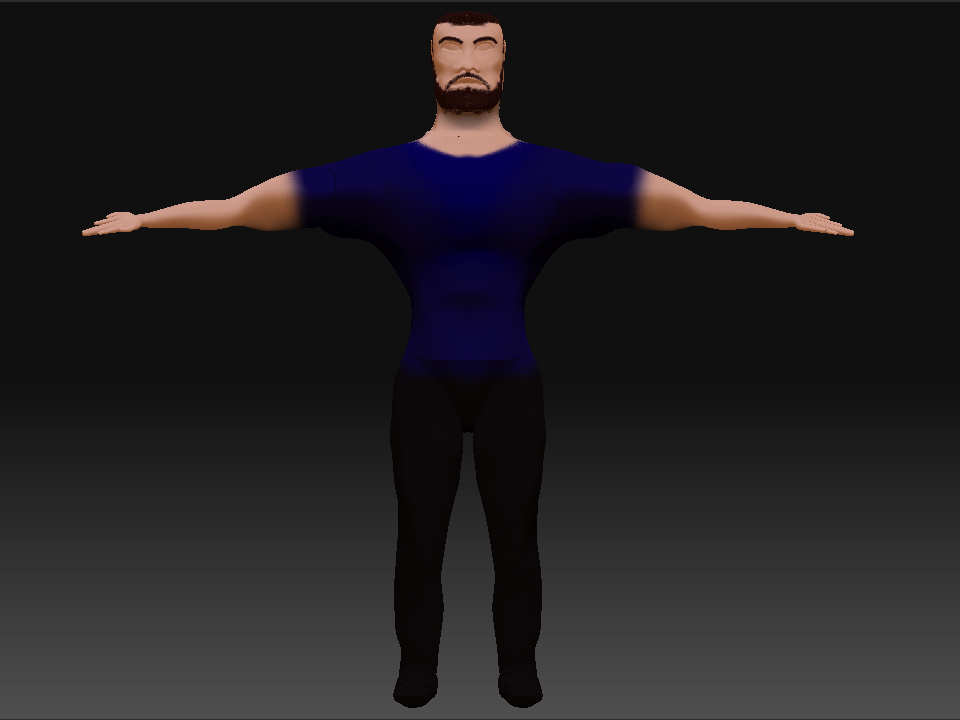

Ok here is a qucik texture I did on my model:
let me know what you think. Thanks again for all of the help.
