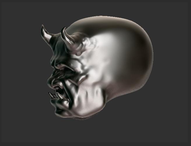

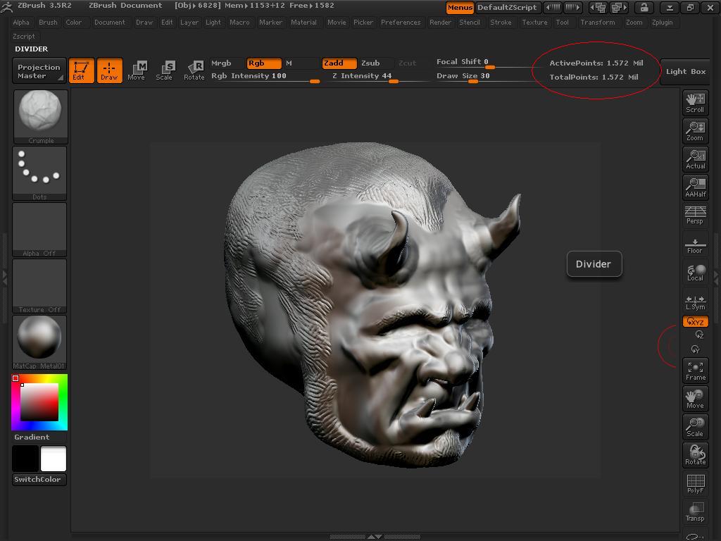

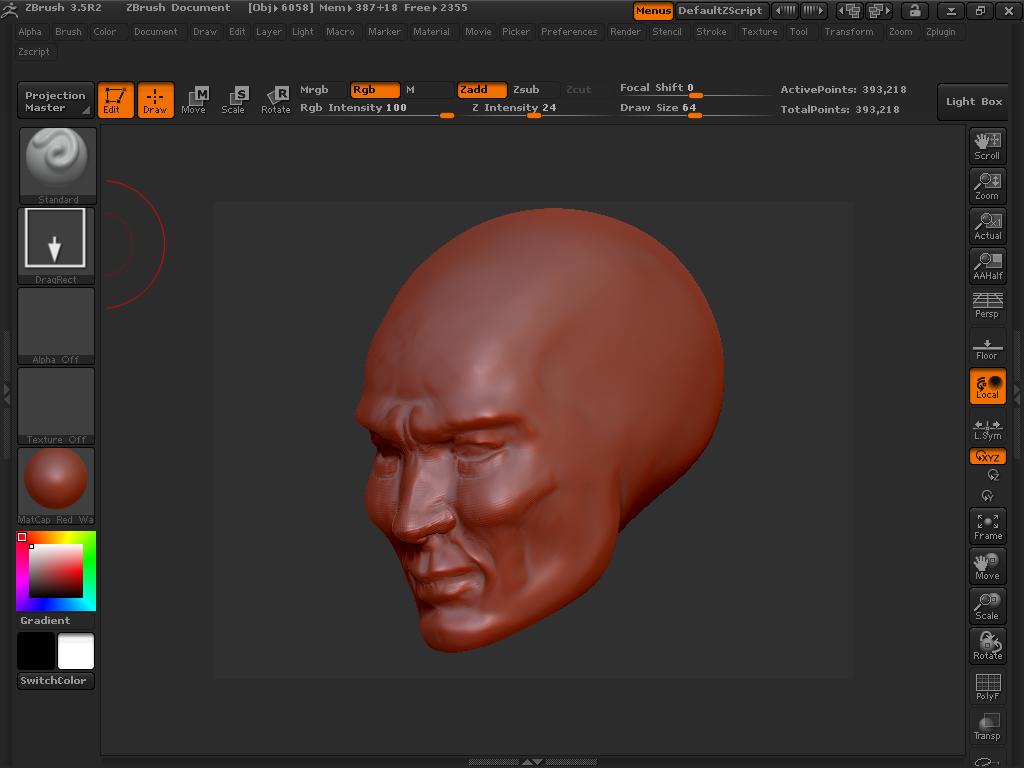

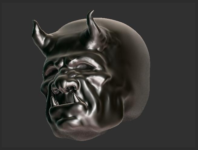

My question goes about the active points management. I’d wish keep working on the troll head but that’s just the head and its over the limits and it’s not even that detailed (the demo head is much better and it’s only 70,000 total points large). The idea is to add neck, shoulders and a jacket but I don’t know how to keep adding details without exceeding that number. I’ve tried to export it to Rhino but it’s far too heavy for it (it didn’t load after 15 minutes, while human head did it in 2). Maybe it’s something easy and obvious to resolve but I haven’t figured it out yet.

Regarding your question, have you tried splitting the model into multiple SubTools? A model with multiple SubTools can have many more total polygons than can be achieved with a single SubTool. You can also divide just the SubTool that needs more polygons so that you’re not needlessly adding polygons to parts of the model that don’t need the additional detail.

ZBrush interface is somewhat new to me, so I’ll check some tutorials about tool subdivisions. So this is time for another newbie question, what’s the difference between active and total points?
(BTW, thanks for deleting the unnecessary double-posting at Tutorial forum, if that was you or any other admin. New threads take time to appear and I read that forum rules after first posting)
active points , probably means only counting the points on your currently selected subtool (- the ones hidden if you hid some).
Total : sum of all points from all subtools I guess.

Ok, images reposted with Internet Explorer. Let me know if you can see them now or if I should keep editing (I still don’t get the thumbnail thing, if I post them first are they going to appear on the post or into a the thumbnails gallery?)
