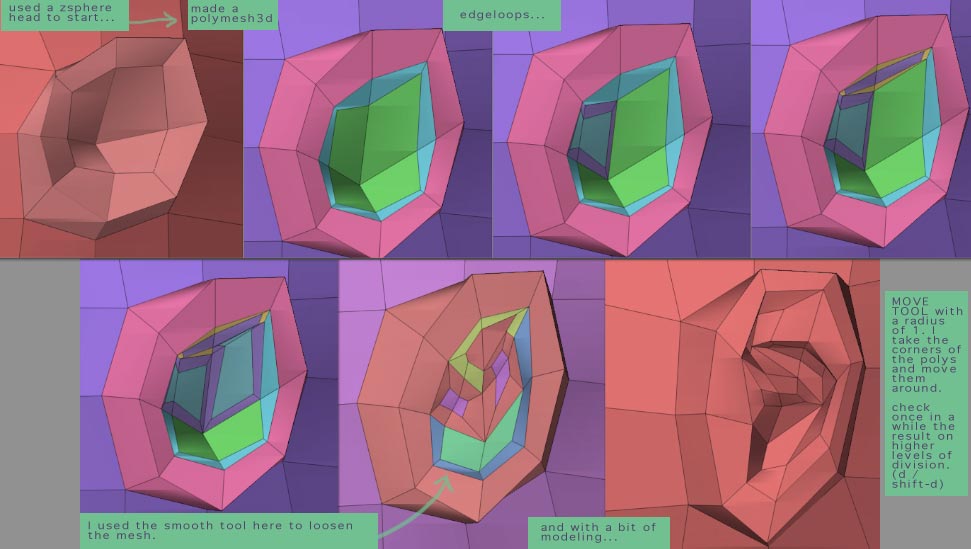

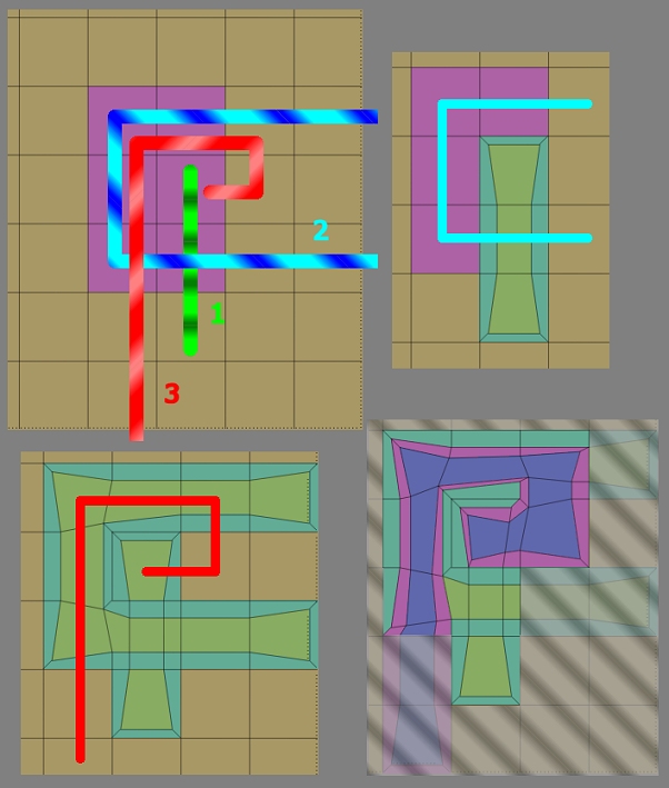

Now, there are a number of ways to make a reasonably accurate ear in ZB. In our quest to learn new tools and methods, the approach I’m using here is with edgeloops and ZB’s method of creating extrusions. An ‘extrusion’, in case you don’t know, is where you move one or more polygons and the software fills in connecting polygons for you. In ZB you hide all polygons except for the ones you want to move. Move them manually or using an option in the Deformation menu (Offset, Size, Rotate, Taper etc), then hit Edgeloop. Connecting polys will magically appear. In the attached script I use this technique to move the ear canal into the head, to raise the bulk of the ear proud of the head, and to create thickened edges.
It is much easier and more efficient to create ears in an external modeller. However, we’re here to learn ZB, eh? I’ve attached some pics of my own ear, which you may find useful. Then there’s a graphic showing the method I’m using in the attached script to get the initial polygons for the ear. The 3 edgeloops shown will give a decent start … after that, it’s all a question of adding detail, and moving vertices and edges into a nice flowing mesh.
