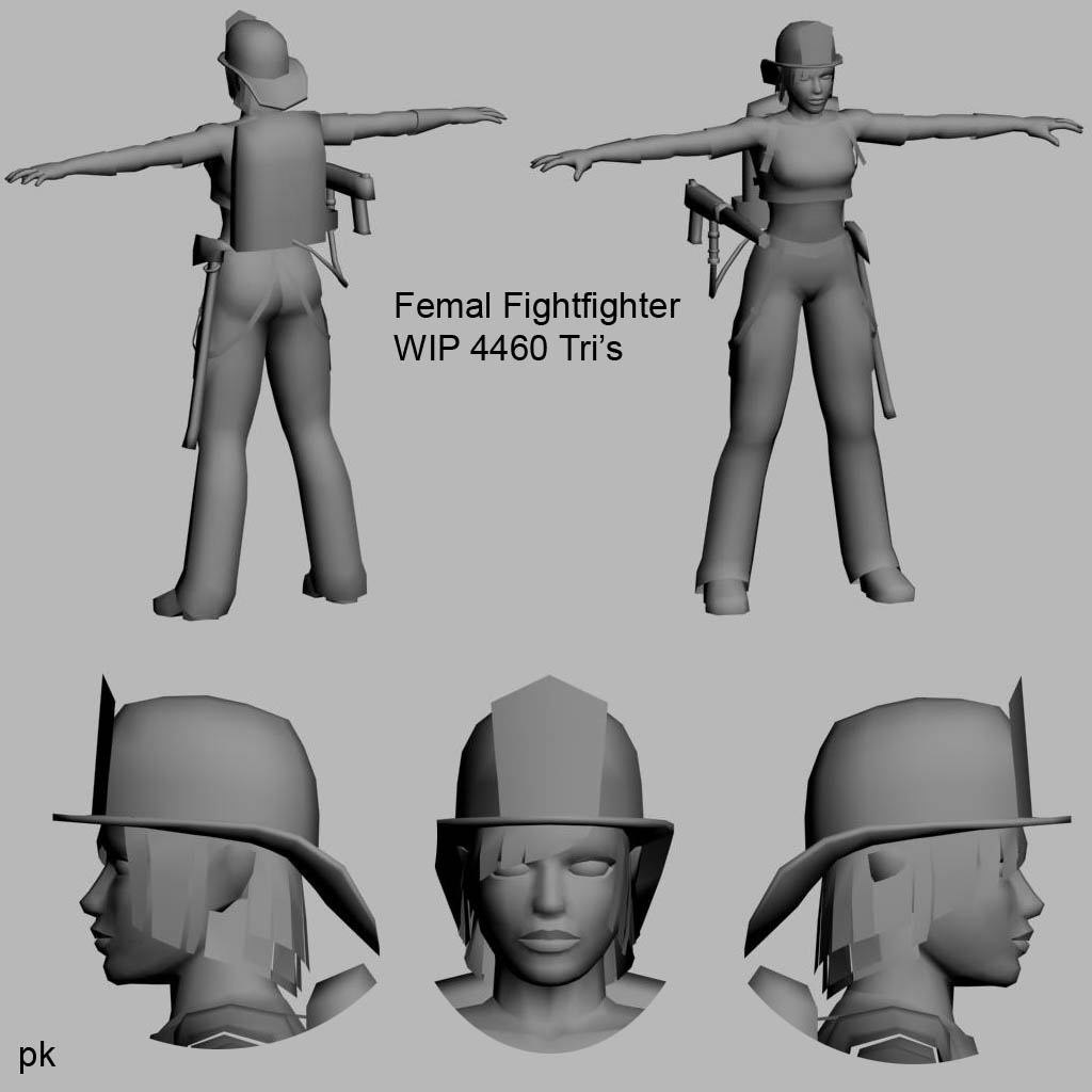

Have attached pic of lopoly model from max.I have detached the eyes and the planes for the teeth(which again will use opacity)The accessories will be taken into zbrush seperately and will have their own normal map

Yeah you probably want to unwrap your UVs before bringing it into zbrush it will just be an easier process in the long run.
all you have to do is store a morph target before adding your details if you’re worried about the low res changing shape. Changing the shape of the mesh doesn’t change the UV coordinates (correct me if im wrong).
as to the hair I dont have a great answer for you. you may want to consider taking the hair and adding it to your accessories normal map.
you could always detail everything seperately and piece the normal map together in photoshop so long as your UVs are already layed out.
hope this helps.

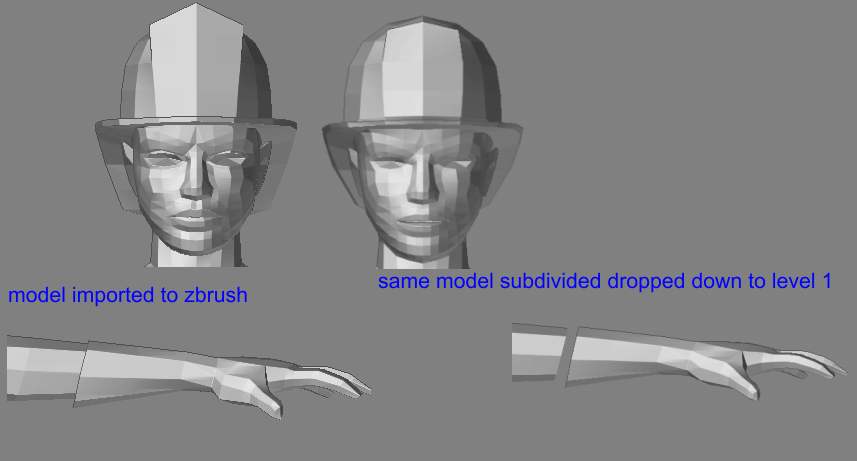

I have MAJOR problem-Above is screenshot of same model.
Image to left is the model imported to zbrush ready for some sculpting.
The image on the right is the same model but it has been subdivided to level 2 when i drop the level back to 1(shown) i am left with an altered model(yet no sculpting has taken place).

How is it the model has changed and how can i get it back to orig.
Let me explain further.
The front of the hat will have a number and other detail added to it but i cant do this as the shape has changed.
The glove is another example.There are no faces connecting the arm to inside of glove and as screenshot shows it appears to have pulled away leaving a gap.

Hey bodybag your problem is most likely that you dont have the arm attached to the glove I dont know what they call it in max but in maya the polygons are merely combined and not merged or welded. When ZBrush SubDs the surface its averaging the distance between polygons and because your arm and glove are seperated they are being calculated seperately.
You can go about this two ways, you can divide your mesh with the SMT modifier turned off or you can detail the gloves seperately.
a third option may be to go in and weld the points together. that would increase your polys dont know what kind of bugdet you have though.

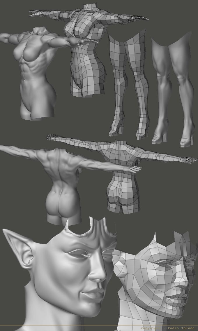

phew,giving myself a headache, i have posted a pic from another artist called Pedro(who i have contacted asking his advice)
it shows his lopoly and zbrush model>i have asked him (waiting on reply) and i would like to ask you guys how did he manage to sub divide and stll keep shape especially on things like lips as when i subdivide my lopoly the lips change shape and size.

The female torso looks very cool. Very nice job, cant wait to see the finals on this one. :+1: Keep up the awesome work.
