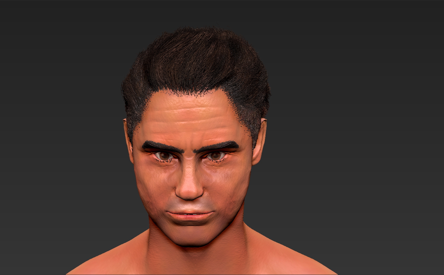

First of all, hello everyone. I’ve been using Zbrush for the past week and there are some things I already now and some things that I still have difficulties on.

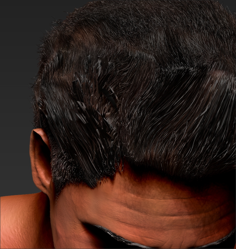

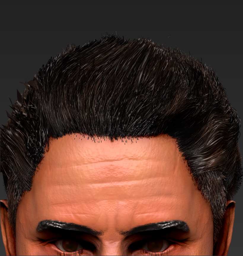

  1. One of the problem I’m having is that whenever I render (BPR), the hair looks really fake and some part of the hair are too thick and flat. I haven’t done anything to the hair except paint it and move it to certain direction. Somehow, some part of the hair are wider than other and that shouldn’t happen because I set the settings the same for the whole Fibermesh. The “hair” is too shiny when rendered and I can’t change the texture. If I try to the hair will turn to a flat color unlike the skin color texture.

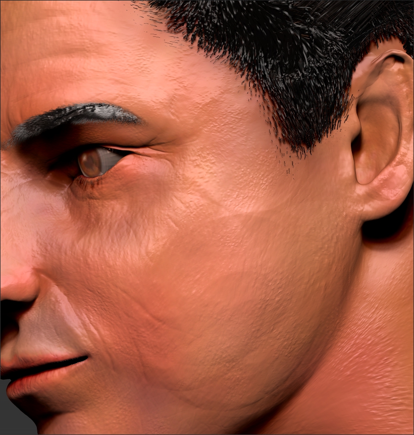

  2. Now the other problem is the skin. Whenever I render it looks like a cartoon and the lighting doesn’t reflect like real skin does that much. I’ve seen some zbrush sculturethat were rendered within the program and they look good. I tried to mess with the settings but nothing works.
  3. The final problem I have is regarding the polycounts. Somehow I have over 11 MIL Total Points. I did do a lot of divide for the head sculpture, maybe that’s the problem (I wanted to have it really smooth so I can get better details). So, now when it autosaves or if I save it manually, it takes more than 4GB.
Here is the picture of the model.
ZBrush%201 ZBrush%202 ZBrush%203
Hi Joe. There’s a lot to unpack here, so bear with me.
Some of those strands appear to have had their geometry stretched, possibly due to excessive grooming. Make sure to use the various “Groom” brushes for styling–they will respect the geometry of the strand much more than say, the “move” brush, which will definitely distort geometry when used.
In the meantime, try smoothing that problem area. It may relax those strands back into shape. You may want to reduce the intensity of your smooth brush for a lighter touch. To adjust the smooth brush settings, you hold down shift to activate smooth mode, then adjust the brush intensity like you would for any other brush.

Rendering is a broad subject and an art in itself. I can give you no simple answers here. Realistic skin tones are usually the result of a bit of labor in any program, requiring a blend of attributes and flattering scene lighting.
That said, because Zbrush doesn’t feature a layered texture system like many traditional renderers, the best rendering results in Zbrush are often achieved with multi-pass rendering and compositing. Different maps can be applied to a model to highlight different aspects, and then composited together post render, allowing a high degree of control over the final image, without the burden of having to get everything perfect in a single render.

See my tip above about using the Groom brushes. Any brush that starts with the word “groom” is designed to be used with Fibermesh. They will respect the length of the fibermesh strands, and are much more forgiving in terms of distorting the hair mesh. The move brush has no such constraints, and will easily deform the underlying strands if care is not taken. Grooming brushes should also be accompanied by frequent smoothing, to relax the strands as you style.

I got the texture fixed. Thanks, the tips helped. However, I can’t fix the hair issue. I tried smoothing it multiple times and still some part are too wide. The Grooming brushes are not doing anything. They are just adding more hair and making it even faker. I tried every single grooming brush and it looks like they are doing the same thing which is add more hair. They are not doing what they are supposed to expect for the twist brush one.
As for the excessive memory consumption, I have around 10 subtools. Each of them have at least 1 Mil polycounts. Some have 2.
The Grooming brushes dont add hair, though they may make the hair seem fuller as a result of twisting the strands to catch more light. Just think of them as a “comb”. Most of the grooming brushes will not extend the hair, they will only comb it out.
If the Grooming brushes (with the exception of the extender) are not behaving like this, and are stretching and distorting strands with no limits, then at some point your hair subtool lost its “live” status and was converted to a pure mesh. Exporting and re-importing the hair subtool, or altering an individual strand’s topology with the zmodeler brush are examples of things that could cause this.
If your subtool is in this state and you dont have a backup from before it was converted, I’m not aware of anything that can be done at that point.
If the other strands besides those distorted ones are behaving correctly with the groom brushes, I can give you a couple of ideas, but It may be that your strand topology has become so mangled, there is no good easy fix for it at this point. If It won’t smooth out, I’m afraid I’m not enough of a Fibermesh expert to offer better advice than how to avoid ending up in this position, hence the Grooming brushes. If it were just a few strands, I’d probably zoom in, try to isolate and delete the problem ones. But the damage here seems significant, and that would require intermediate program expertise.
It’s important that you’re actually getting at the problem strands. Zoom in, and shift-ctrl draw a selection marquee around the problem area to highlight it in green, then release. This will hide all but the strands that fell under the selection box, making it easier to zoom in and improving performance.
Try enabling Brush> Automasking> Topological while holding Shift Down. This will make it so the smooth brush basically only affects the strand it first makes contact with, so reduce the brush radius and really try to get in there and find the vertices on the offending strand that needs smoothed. The polygons on those strands have become very stretched–you have to get the smooth brush on the points.
You also may get some use out of the pinch brush, also with topological masking enabled.

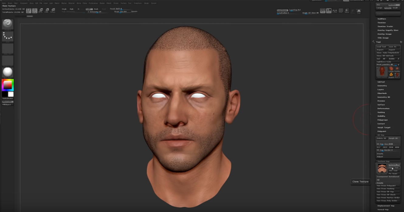

One last thing, do you know how or which texture makes the ‘skin’ of the model look better when render. I only see the one called matcap skin3 (something like that). I tried using others but it doesn’t give that real look. I’ve seen some models that even before they are rendered, they still look good. Mine just looks too cartoonish and plastic.
For example, this model isn’t render yet and it already looks good.

Off the top of my head as the most general critique, I would say your color is too saturated, the specular is too high and too uniform, and the surface skin detail is a bit off. Looks less like porous orange peel and more like stretched and wrinkly avacado skin in places like the cheekbones. All those things will detract from realism.
You can tweak the color and reduce the specular a bit on the material. The surface texture may be a result of distorted topology. Hard to say without wireframe, but evenly distributed quads as close to square shaped as possible are the ideal topology for quality sculpting and painting.
Beyond that, you would be better served looking for tutorials on multi pass rendering and compositing in Zbrush. It’s a much broader subject than I can cover here, and an art in itself.
