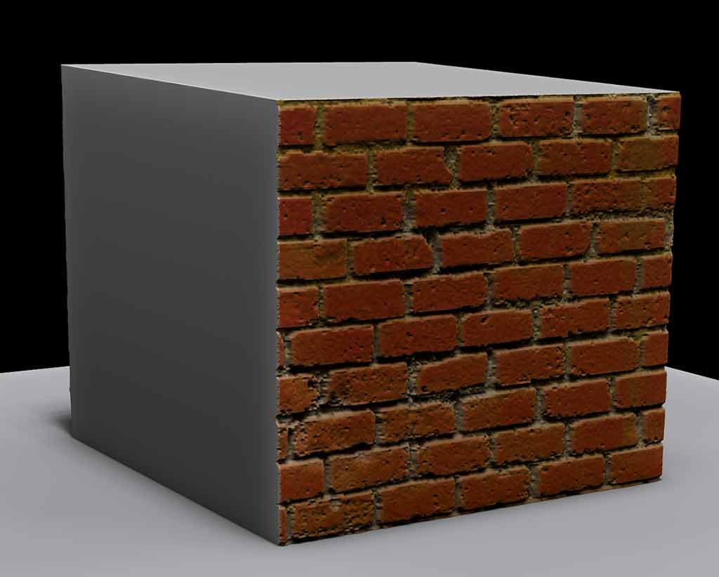

Extremely basic workflow example:
  1. Download the Brick 11 texture from the ZBrush website. This is a nice, fairly uniform brick texture.
  2. In ZBrush, load a polymesh 3d cube, and subdivide it several times to a level sufficient to capture the incoming detail.
  3. Fill it with white color with Color> Fill Object while the RGB channel button is active.
  4. Load this image into ZBrush and add it to Spotlight.
  5. Position your texture over your model. Set the stroke type to the standard brush at its default settings to “drag rect”.
  6. Again make sure that the RGB button is active. Since we want to inset the lighter values, start in the center of the image and drag the stroke out while holding ALT to invert the displacement. This will draw out both color and displacement at the same time with a circular application starting at center.
  7. Disable Spotlight. You can see the brick color has been stamped into the mesh with pretty reasonable results for the default settings. Disable Tool> Polypaint> Colorize to switch off polypaint, and you can see that the bricks were also displaced at the same time.
Have fun! :slightly_smiling_face:

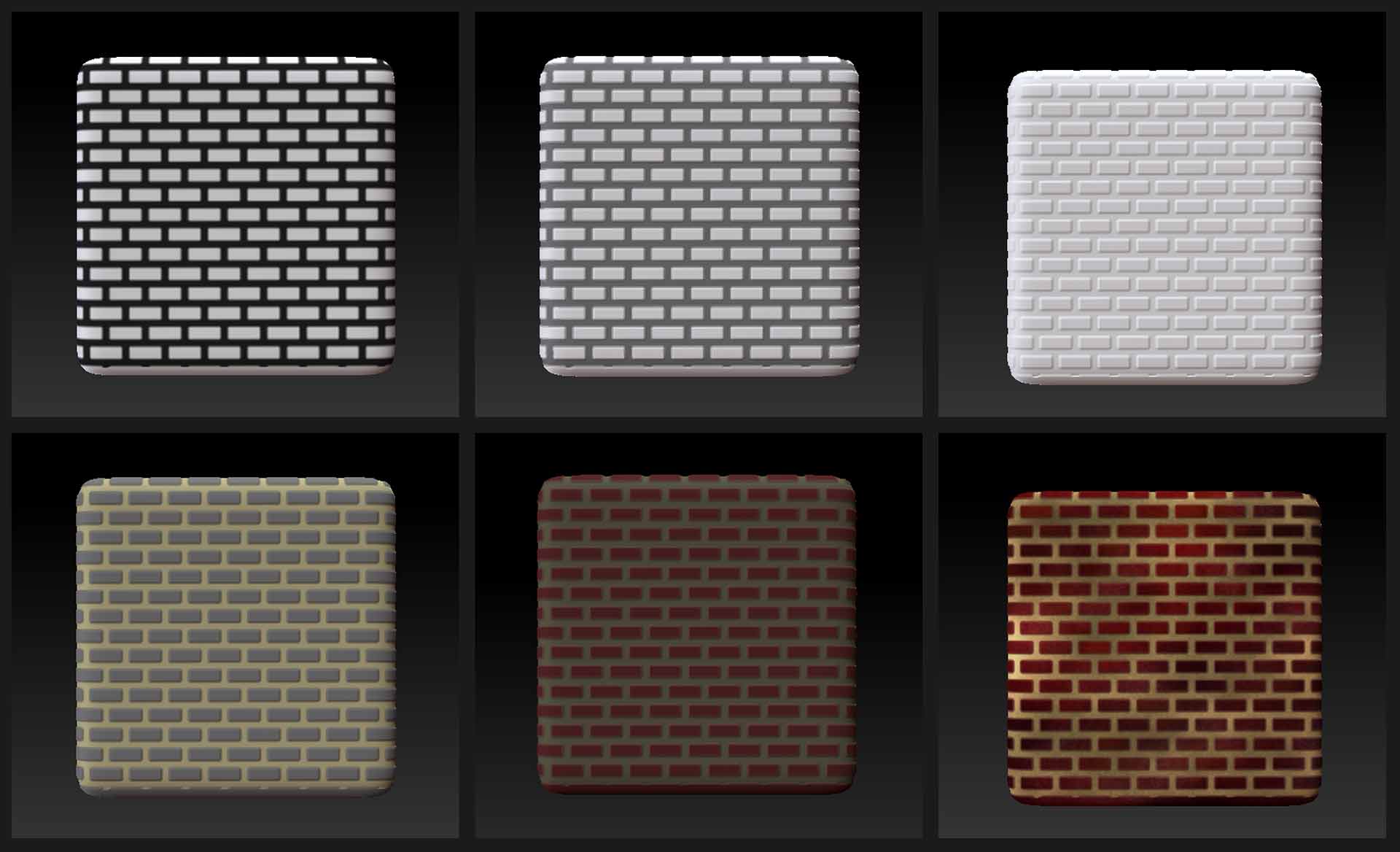

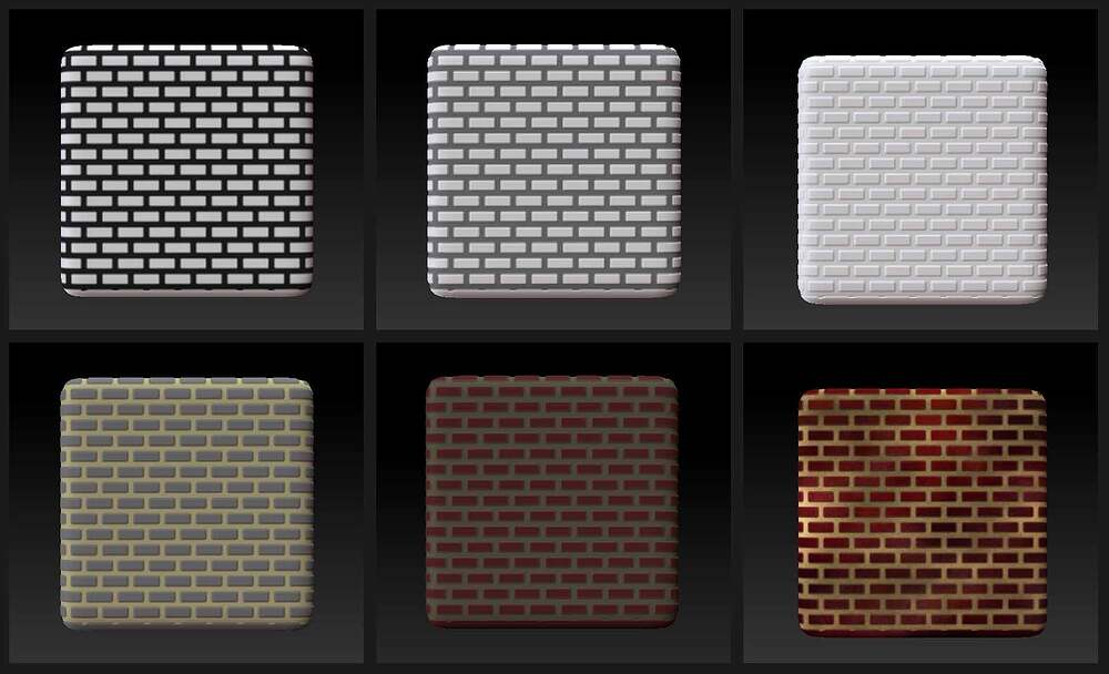

Please see the following illustration of the basic principle. I have applied the simple brick pattern that comes with ZBrush as polypaint onto a cube. That polypaint can be converted to masking with a variety of options in the Masking palette. I could have also simply applied the alpha as masking directly, but this way is more Spotlight friendly.
Once I derived masking from the pattern, I used Tool> Deformation> Inflate to inflate the bricks. This could also be done with alpha displacement or Spotlight.
Then with the masking still intact, I used Color> Fill Object with the RGB channel button active to fill the brick portion with one color. Ctrl-clicking in empty canvas quickly inverts the masking and I filled the mortar portion with a separate color. Ctrl+H toggles off the display of masking while keeping the effect intact, and a hotkey can be assigned to Tool> Polypaint> Colorize to quickly toggle polypaint display on and off.
As long as that masking is intact you can keep inverting it or modifying it with mask-shaping options in the masking palette to target different areas. If you create UVs for your model you can save out polypaint as textures or masking as alphas so you can re-apply them at any time.
In the event that you did not plan the process out this way from the start and merely have surface displacement detail, the Masking palette also has options like Cavity and Peaks and Valleys, which may allow you to create masking only in the recessed areas after the fact.

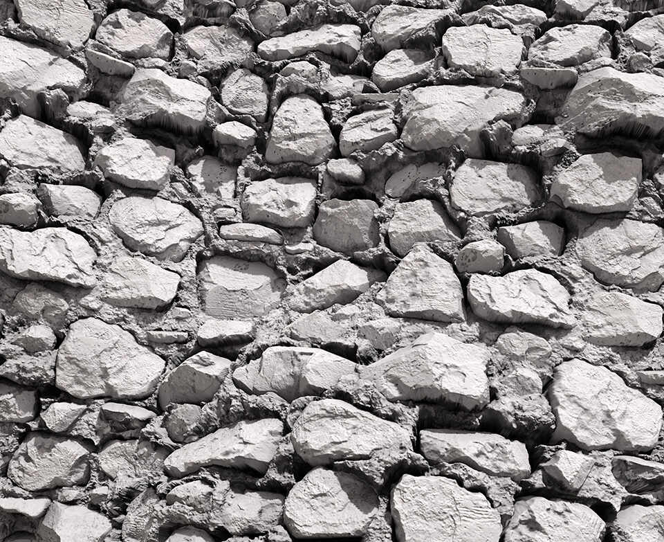

Here’s the problem, now I have images to attach. I have a sculpted wall and I have a texture I like and I wanna use, sculpting the wall from a texture is not an option because of low quality result and when sculpting I rely on a ton of different alpha and brushes and techniques. So once I got a cool result, I wanna texture it with a specific texture from megascans, how do I go about this without painting stone by stone?
wall_sculpt
