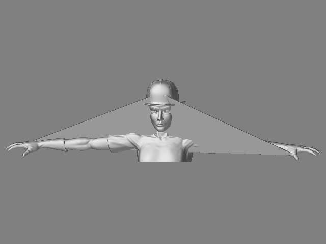

have been working on model only using edit mode,i work my way up sub divisions adding detail and hide parts of body and work on a small section at a time.

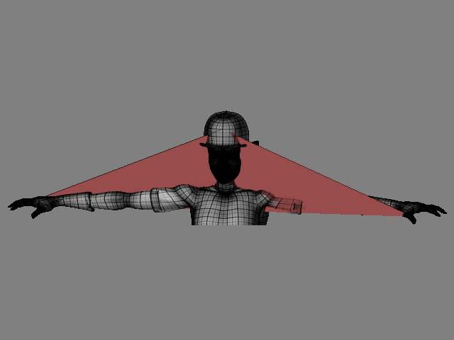

i finished at lunchtimne and save file i have been working this afternoon and unhide all before i saved and noticed this big triangle even when i drop to level 1 there is still a problem(looks like a point has been dragged all across screen)
How did this happen?
And how can i correct this please?

Asuming one side is perfect you need to mask sellect the good side right down the middle ctrl + drag over this area. One side should show grey the good side.
From the tools menu open the tab deformations. Be at a low sub division level and press Resym then smart resym. Go up to the next higher sub level and again press resym then smart resym. Keep on doing this untill you reach the highest level or to the point you see the bad deformation vanish. Its worked this way for me many times.
I also normaly resellect the half I want again on each sub level just in case not all the avalible polygons for the next level up got sellect correcly down the centre line of my model.

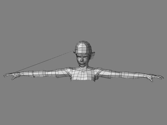

whilst waiting on tez, i decided to export sub div level 1 model back to max.
the triangle present turned out to be a vertex from her little finger that somehow had attached itself to the front of her hat.
I fixed this and imported back to zbrush replaced old level1 with fixed one,

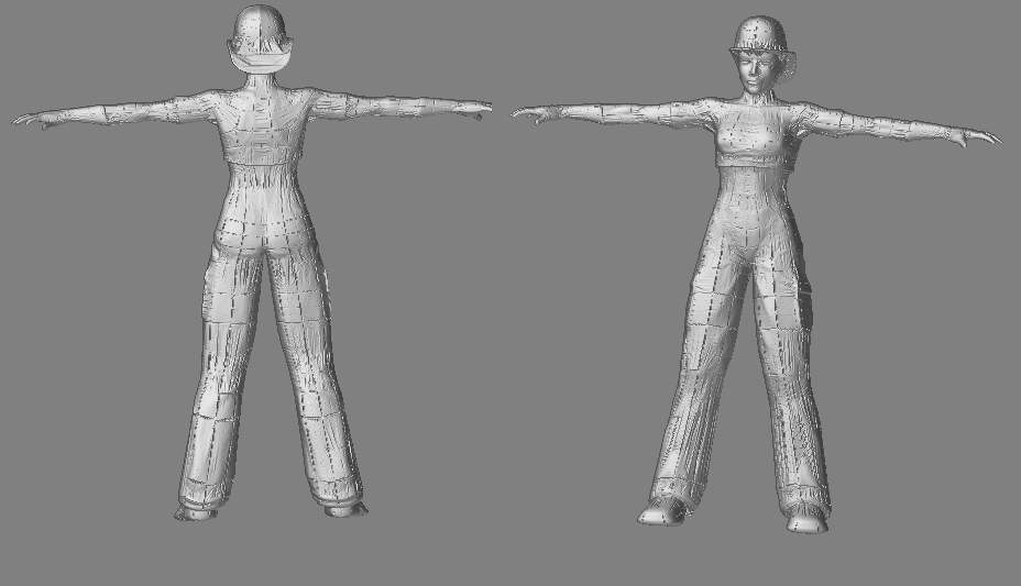

however when i went up through the sub div i got weird results as sceenshots show-

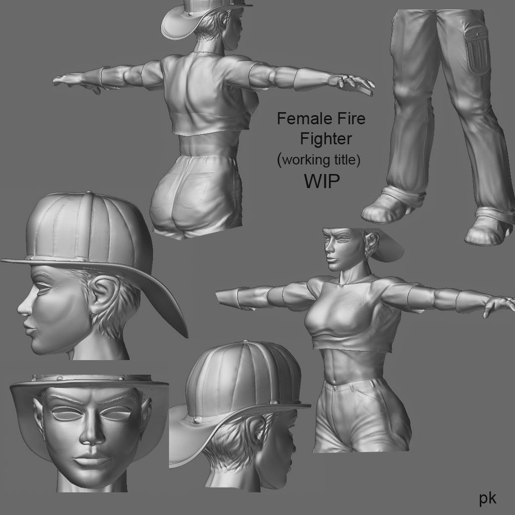

finally,back on track.Thanx for all your help(shout to tez)
Here is update of work.2nd time using zbrush,quite pleased so far only just started using projection master,working on face first,will be adding more detail all over
One question - can i use material in zbrush on this model?This level 6 will be the normal map for my lopoly which i will create diffuse and spec maps in painter and photoshop(also looking at a good skinshader i just got,getting ahead of myself)
.Lots to do.
