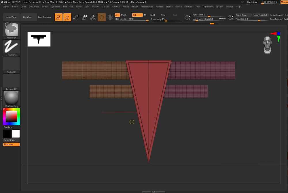

Hi there i am trying to make a necklace curve brush out of this mesh i made:
any advice or help would be greatly appreciated
Thank you

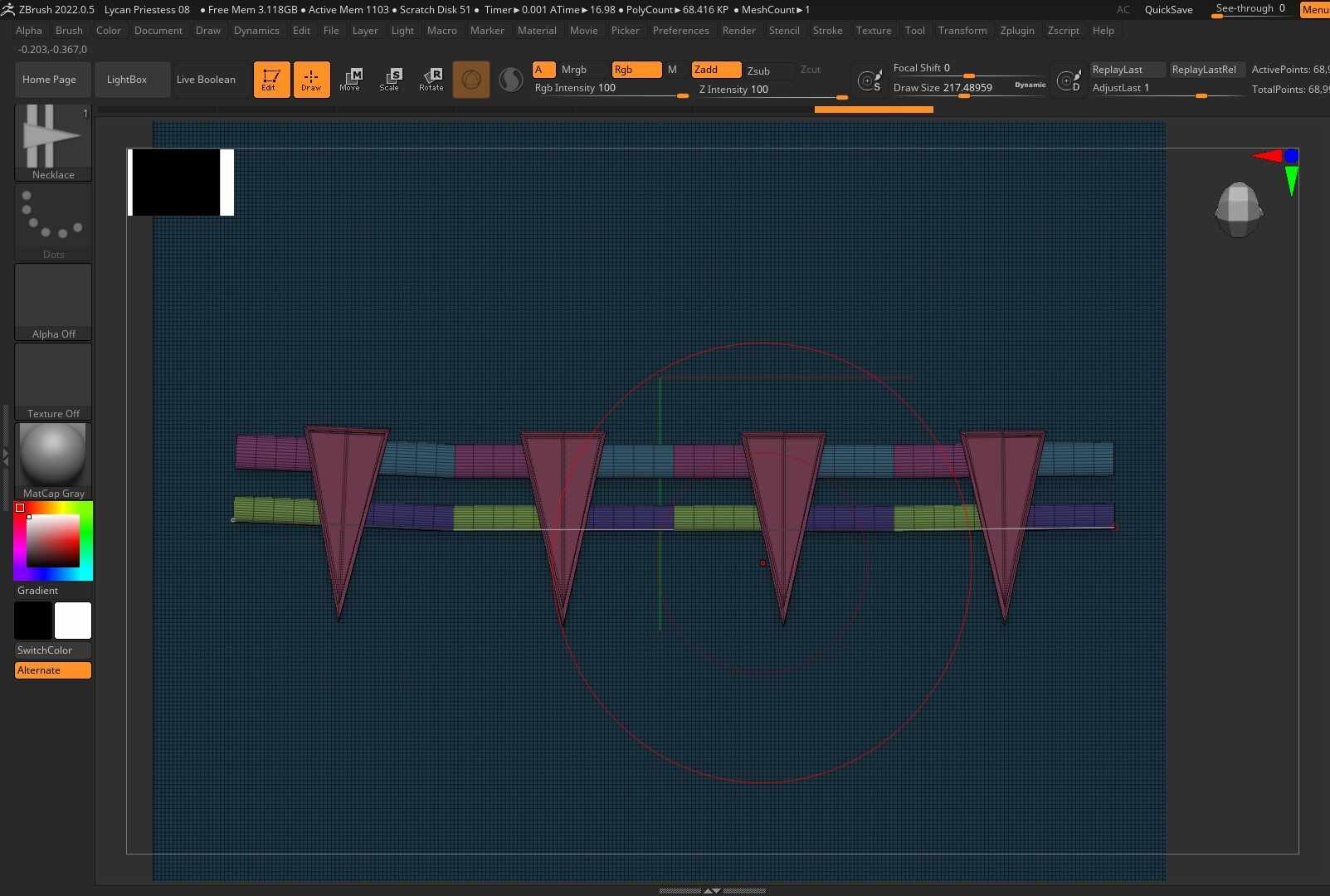

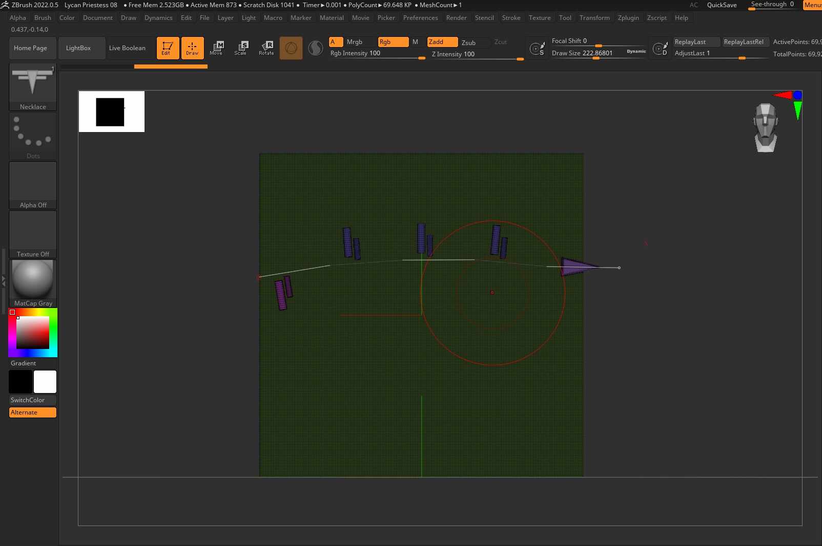

if it helps i have turned on weld points and this seems to be the result:

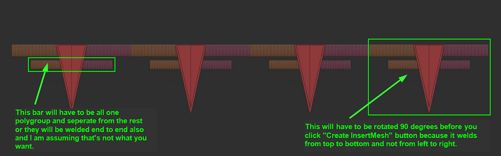

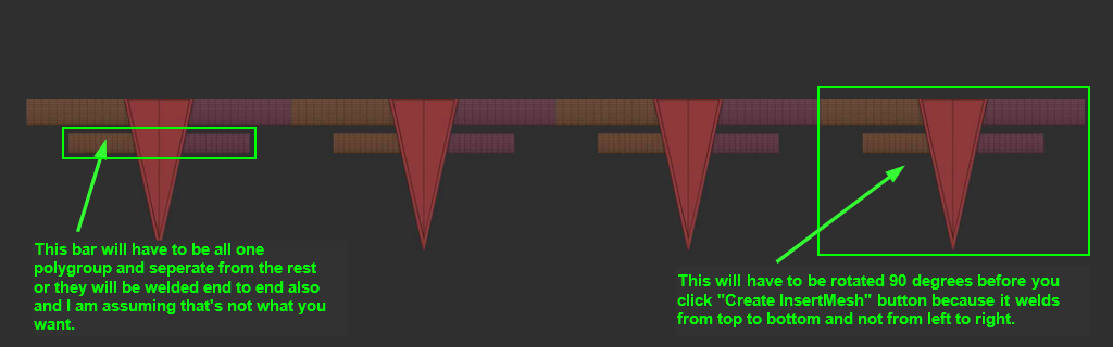

I presume you want it to look like the image below. Your mesh orientation is wrong. It will have to be rotated 90 degrees before you “Create InsertMesh”.
Thank you so much that seems to have worked perfectly
