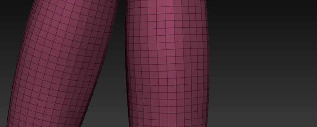

Hello, After Rigging in Transpose Master, my model is distorted like a ladder layer during movement.
While creating my model;
  1. I’ve rendered the Shape3D object.
  2. I activated the DynaMesh option and edited the polygons continuously.
  3. I did modeling.
  4. I gave the final topological distribution with ZRemesher.
  5. I Rigged in Transpose Master and my model broke while I was moving it.
I couldn’t find any solution to this. There are many videos on the internet and I watched them. But even with dense topology they don’t face this problem.

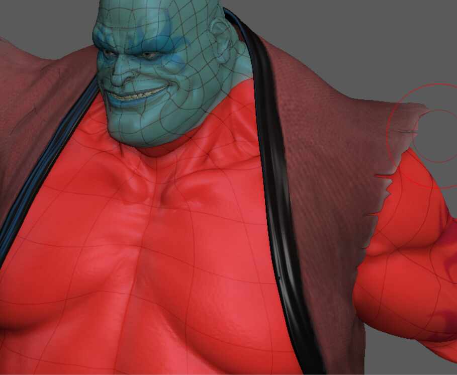

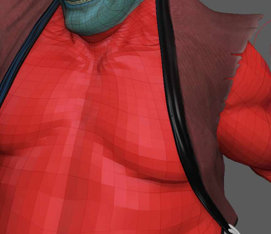

@SPYNDEL Yes, I am aware of that. But there is a problem. When I make low polygons as points, there are very sharp transitions. I did a review on the character in ZBrush. However, in the image below, the polygon or point frequency seems too high. If I model with low polygons and points, I cannot enter details. Very dense polygon is created when I do it with Dynamesh or ZRemesher. When I do the least, the details disappear anyway. I am also implementing a project. But the details I want still do not occur. I did not understand this situation. Except for Dynamesh or ZRemesher, then it is only necessary to model with ZModels. I do not understand.!

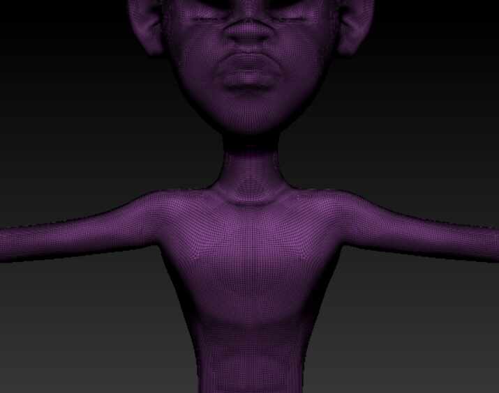

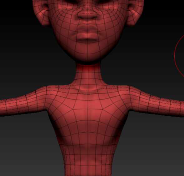

@Spyndel I struggled for hours. I reduced the number of polygons as in the image below. While performing the “Rig”, there were undulating distortions like stairs again. I still don’t understand. I could be doing something wrong somewhere. I watched videos online. Do you have a video to recommend? Or it will be a special request, but can you shoot a 5-10 minute video for it? I really want this because I can’t move forward anymore and I’m stuck with it. I have to.
I haven’t exactly edited the polygon distributions in places like eyes and mouth. I put the images for example purposes. There may be many errors.
High polygon count:

Low polygon count:
Screenshot_115
