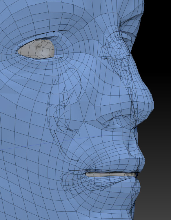

Another thing that I found weird is that models has this kind of “Hide Line” that I don´t know how it becomes like this.

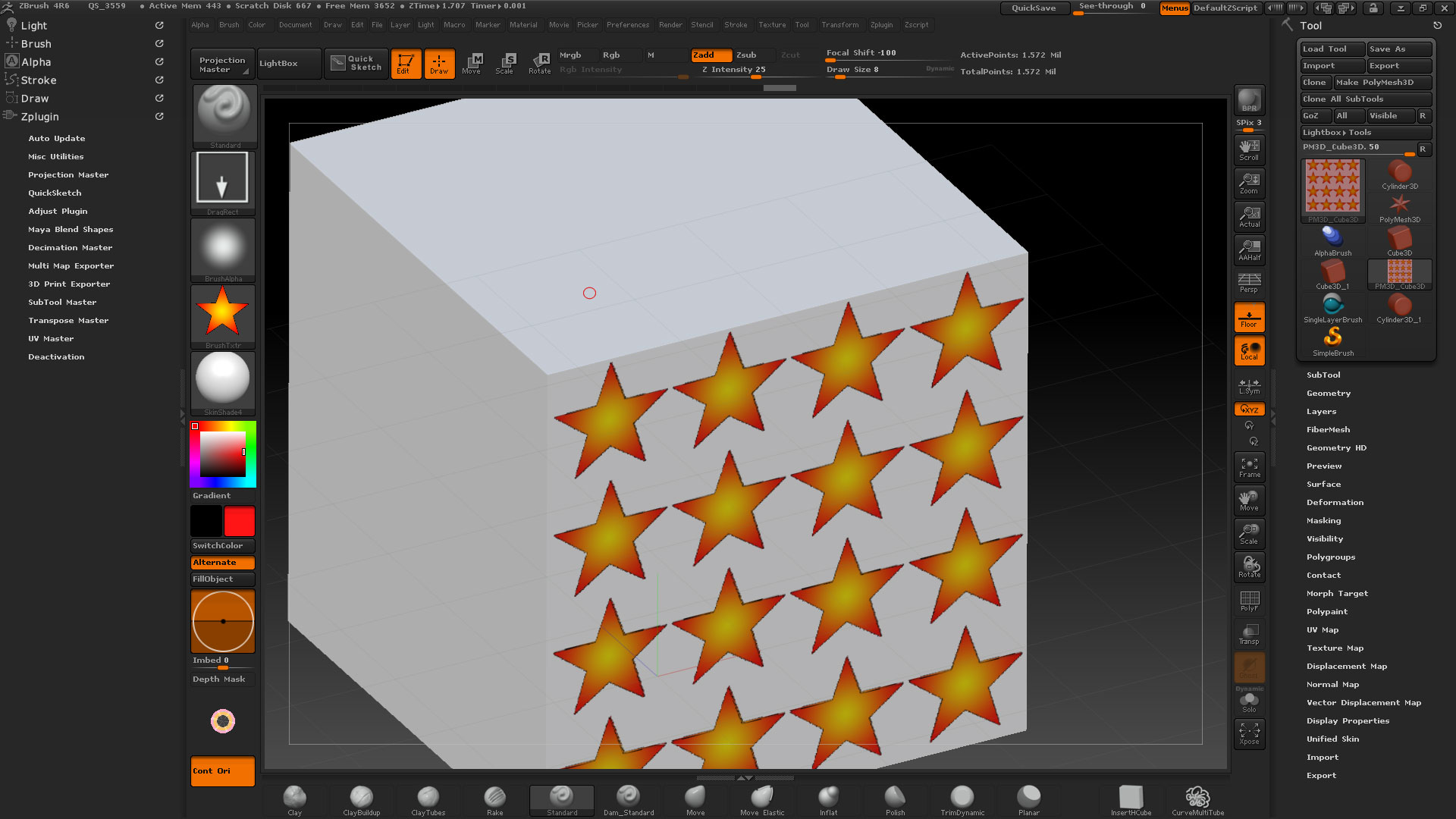

I’m guessing the problem is one where your z intensity switched before Projection Master reentered edit mode.
To fix it: Exit edit mode and clear the document. Make sure your RGB and ZIntensity are fully set to 100 (even a value of 99 can result in the behavior you described). Once they are set, redraw the tool and enter edit mode again.
Can confirm that this worked for me. Not sure what I did with Projection Master but this fixed the issue. I must have changed my Z intensity at some point not realizing it to 25%. Thanks for the advice!
