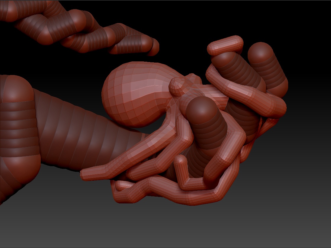

It sort of looks good but its not, if I move around like zooming in and out the octopus slides out of the hand into random places so I have to stay at that level of zoom… and by zoom I mean scale I think.
Honestly I’m totally lost, I spent over an hour rotating the octopus and moving it from inside the chest to where it is now, hundreds of tedious little movements (and 3 crashes) and the result is not permanent, I can only use it at this scale/zoom or what ever. Is that normal?

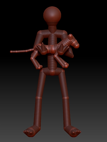

BTW, I started my positioning by going into deformations and hitting “unify” for each subtool. Then I scaled on all axis in deformations to make the dog small. And finally I “offset” the dog in deformations on the necessary axis’so it was in the position to be held. Lastly I used transpose rotate and move to position the arms of the person. It does take some getting used to the rotate, scale and move transpose tools with zspheres, but once you get the hang of it you’ll find it gets pretty automatic. Same with transposing with Deformation, expecially now it’s in real time with ZB4…a fantastic new addition to ZB, I might add.
MORE ABOUT MY POST EDIT:

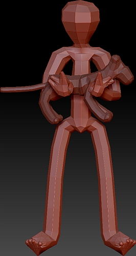

After posting this I tried hitting “A” and playing around with the adaptive skin density and sculpting on the preview mesh. I was snag the sculpted preview as an adaptive skin and it didn’t seem to corrupt my zspheres. I tried setting each subtool to its own density level, sculpting, making adaptive skin, switching back to zspheres, etc. Nothing broke and the sculpting stayed put, which is odd…my faulty memory tells me this failed for me in the past. In any event I’m really curious why your mesh exploded.

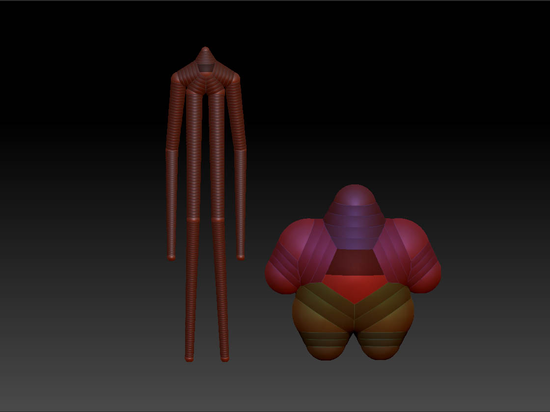

For the sake of demonstrating this I made a new document and two new characters, nice simple ones named BubbleBut and NippleNut.
This is them standing happily next to each other in the land of Z:

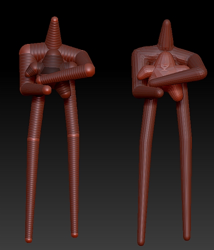

This is a very strange problem Mealea. I can’t think that either your program is corrupted or you are including some step without realizing it.
I copied your forms and followed your process and got this:
I wish I could figure it out…very challenging problem which I can’t seem to repeat. I’ll keep trying though.
(btw, if you keep the largest dimension of your inserted pics to about 500 px its easier to both view them and read your text, otherwise it requires zooming in and out to read and refer back to the photo :slight_smile: )
What exactly do you mean by “I saved him as a subtool”?
I made each part and then cloned it for extra reassurance I wouldn’t lose it, then hit “T” to drop it to the canvas. Then I redrew a zsphere and repeated this for the other form.
Finally I cleared the deck, chose one (clone or original, doesn’t matter) and appended the other.
Is this what you meant?

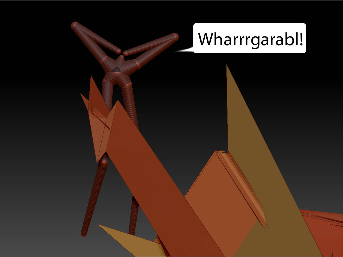

Yeehah! Three of my own posts in a row…but I think I may have figured it out.
you wrote:
“The transpose tools simply did not work, (all three little circle things and with symmetry on and off) as a preview mesh it was destroyed, distorted and mangled him beyond anything anyone would even want to survive, (very sad. We hid his body next to Jimmy Hoffa’s).”
You do not want to use the transpose tools on a preview mesh that has an associated zsphere armature. The whole point of the zsphere armature is to create and pose the basic mesh. It seems to be ok to sculpt on the preview, but you don’t ever want to move/scale/rotate the preview with transpose or deformation tools or as you have probably noticed , you move the mesh out of sync with the zsphere armature.
Always go back to the zspheres to make these types of adjustments, or alternatively create and work on an adaptive skin that is disassociated from the original zspheres.
