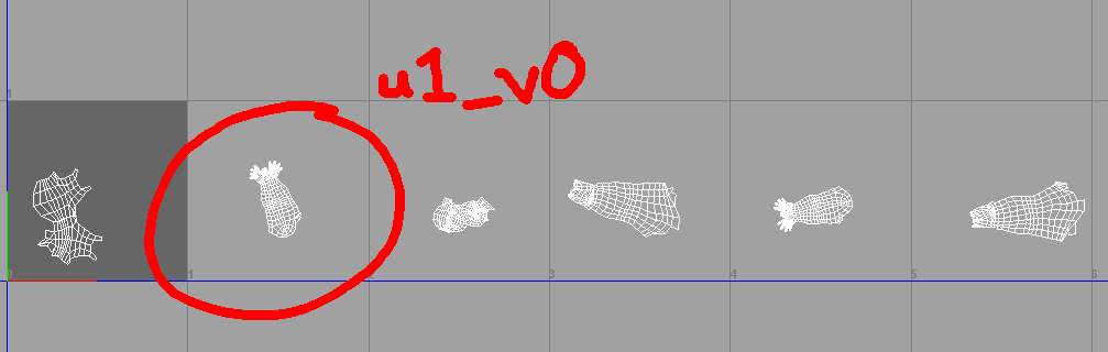

OK. Just so that I’m clear on this: that’s presumably the lower end of the range for a tile? In other words a tile that was in the 1-2 U range and 0-1 V would be labelled u1_v0 (see image)?
