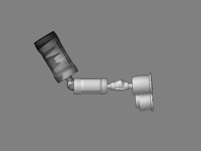

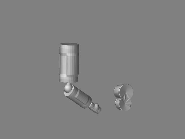

I"m having a strange problem when redrawing two tools with the multi marker. When i draw the position of the tools changes on the canvas and a part even disapears.leg1.jpg Any advise very welcome… T.I.A.
The piece that’s disappearing is the first one that you marked, and this is a known issue in ZBrush 2. A workaround was posted shortly after Z2 was released, which consists of simply placing a dummy piece on the canvas first and marking that, then proceeding with your real model.
