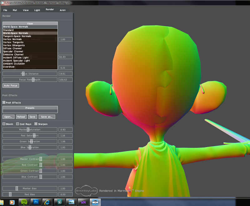

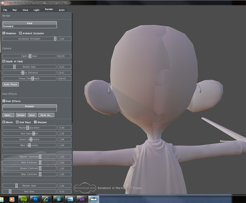

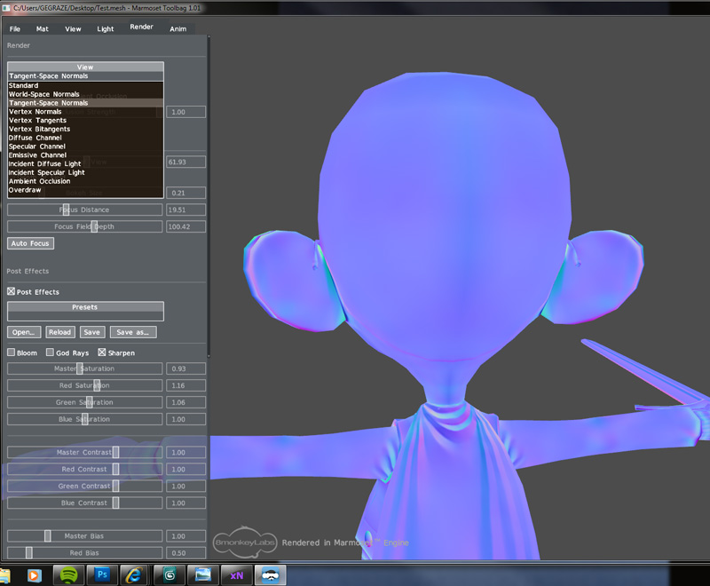

Hey guys been around for some time but here is my first post. unfortunatly its not a beautiful top row image its actualy a nasty seam that im getting on my current model. ok so here is the normal map viewed in different settings. im not sure why there is this strange seam, becos technically the seam should be in the centre but its really random. only when i turn on tangent-space normals does it show the seam how it looks in photoshop. hope someone has the ‘win’ button for this problem cos i dont have any idea what to do.

it’s because you have a tangent spaced map created, so it should only display correctly when the shader is set to tangent spaced.
I guess I’m confused as to the problem you’re having? Is there a specific reason you want to use a different normal map type?
I don’t know how or what you used to make your normal map, but seams on a normal map can come from several issues. smoothing groups, not enough uv padding, your green channel needs to be flipped, you tampered with the normal map in photoshop and messed it up, or you have vertices that aren’t welded together and its your geo and not your normal map, those are just a few man. To figuring it out quickly you would have to explain how and what you used to make that normal map. Hope that helps.

PolyHertz: i havent tried veiwing it in any other program yet but i will try that out now.
goast666: i dont want to use a different Normal Map type, the standard veiw is how marmoset sees it, the tangent space normals is how they should actualy look, and the world space normals is how the normals are being shown, i want it to show them as tangent space so how do i change that?
3dMob: well i used xnormal to make the NM, i also used photoshop to edit a few artifacts. i checked the rest of what u sed and its all fine, this shouldnt be happening argh lol its only happening on the head tho. and it al stil doesnt explain why the seam is totaly wonkey, apart from the smoothing group issue.
SadamHu: i didnt use transpose lol i modled most of it in max and just made it a little nicer in zb adding wrinkes and other details but i didnt change any of the overall forms.
does any1 no how to make marmoset veiw tangent space normals?
