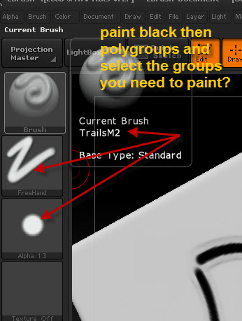

I had a look at the trimBrushes already before and they do exactly the opposite of what I need. They paint everywhere but on the hard edges. Which kind of works I just need to reverse-paint. My first instinct was to try and get the opposite effect using ALT but when I do this there is no RGB Info painted at all.
another option?
