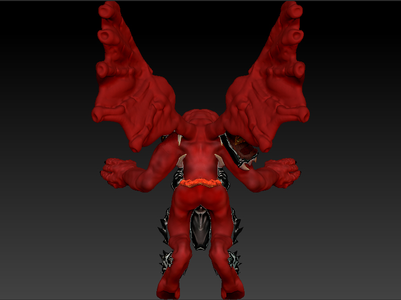

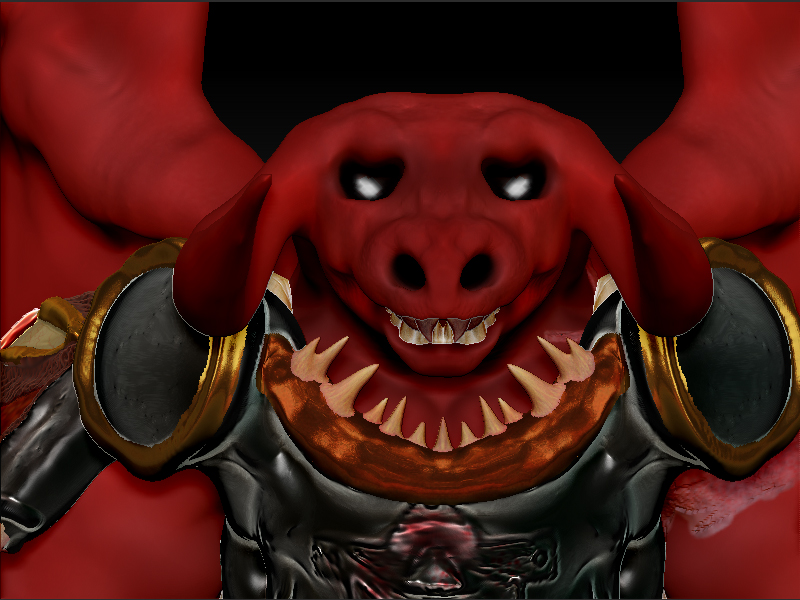

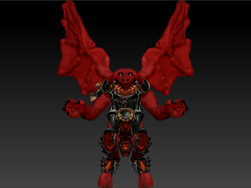

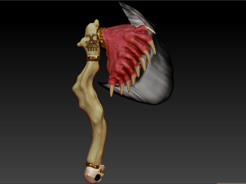

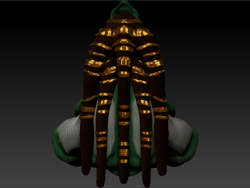

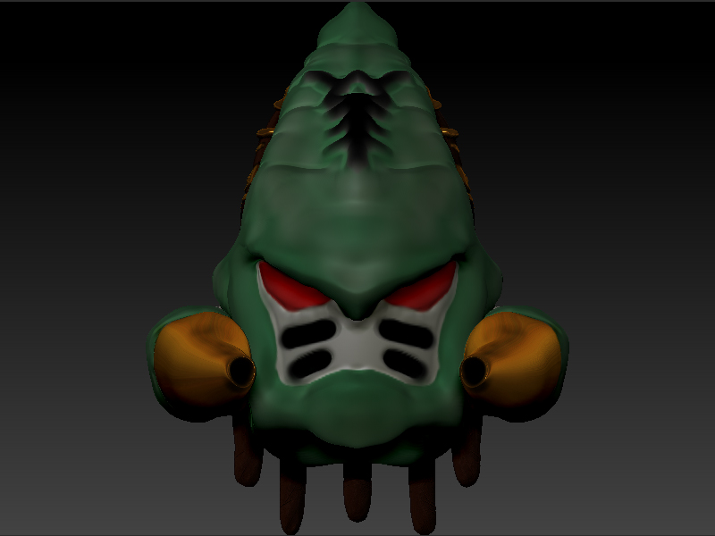

These are some models im working on for a mod called Retribution the Great Game mod for Dawn of war 2 Retribution.
These are some of the images of WIP models
Bloodthirster
Front

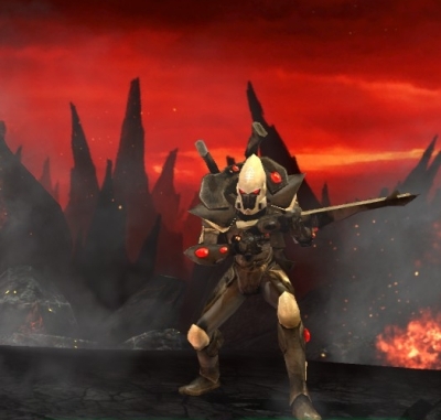

The Bloodthirster is WIP and the Eldar striking scorpion’s grey is all team colorable.
Any comments or suggestions would be greatly appreciated.
Link for the Mod in Relic News forums http://forums.relicnews.com/showthread.php?259351-Retribution-mod-The-Great-Game(WIP-need-help

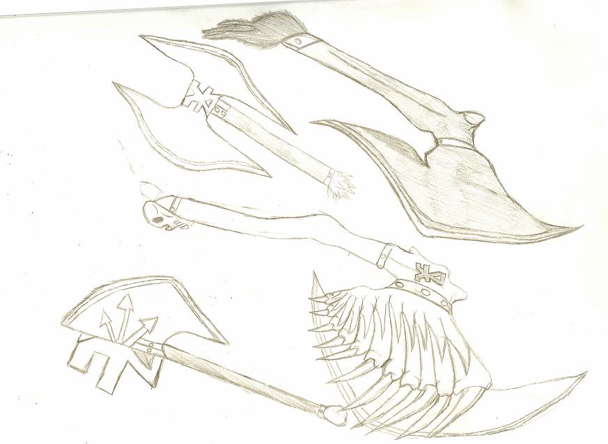

I will be uplading some of the conept art that I used as a basis for the Bloodthirsters Axe and for the Striking Scorpion Helm
Okay here are the concept images

I have honestly seen FAR worse. The key thing I'm seeing is that your models seem to look kinda "blobby"; not any definable 'edge flow' or smooth silouette, so to speak. Do you use a drawing tablet like a WACOM? If not...get one. It will improve your models instantly. In order to 'smooth out' your blobiness problem, try using the Smooth option (generally, holding down SHIFT). Another method I use to 'smooth out' parts of a model is to use the Clay Tubes brush and brush in and around the depressions (or where I want to build up mass), then use SHIFT to smooth it out. Works best for organic models, like your demon. For inorganic, take a look on the Classroom pages here at Pixologic for the 'hard-edge' modeling tools. I think they had some video tutorials that show the making of a helmet and a car (?). One more tip; don't bother with any texture/painting at this stage. Just focus on the model. Once you get better at modeling, then you can up your game by getting into polypainting and whatnot. Learning the cool brushes and tools in ZBrush is more than enough to start with. :) Keep at it!

especially if you’re plan is to make something usable for a mod. the models you have made now are more then likely not gonna be suitable for use in a game engine as there’s no clear edge flow and animation is gonna be really really rough on it
before you start even getting into the painting you may be better off trying to learn retopo and how to create uv’s . in order to get this model into a gaming engine you’re going to need well defined edge flow and edge loops. a poly count below 10k per piece with significant details and necessary movement in it. extremely well defined UV’s so that your eventual coloring can be converted to texture… so that your high poly details can be converted to displacement and normal maps… etc etc.
i’m gonna go on a limb and guess that at the moment your model is somewhere around 3-5 million poly’s with all details.
consider the edge flow in this guy’s models face :
http://www.zbrushcentral.com/showthread.php?p=886305#post886305
the high poly he has is still probably under 1 million polys and the low poly mesh is 8.5k tris. this could be animated and fit in with a game engine well. if you tried adding what you have now into a program that could be used to rig a mdoel for game animation then you’re very likely going to melt your cpu trying to do so :wink: … the thing you have to always always always keep in mind with zbrush is that you’re not working in 3d. you’re working with pixols/voxels presented in a 2.5d format. this saves your computer from meltdown situations by offloading alot of the math to the cpu and ram. Say you were using 3ds to create a riggable mesh and unreal editor as your animation system (not sure what engine dawn of war is using but i’m unrealed is a good place to look at for what an engine can handle… and you can find it free now) in 3ds you’re working in 3d so you need a gfx card that can handle pushing the total number of polys in yoru mesh at all times… as well as the cpu power and ram …
think of it this way… if your legs each have about 50k polys in them… to animate them as is, if just for a simple animation path… the cpu will be calculating over 5x more per animation then what it will take to animate that face from the link i posted. and a face is supposed to be one of the more heavy hitting animation areas in cpu and gpu strength. now imagine that scaled up to your full model. if you like playing your games at 1fps then it’d work for you :wink:
if you want a healthy comparison point to see where what you have now stacks up… try seperating just the head of your mesh into it’s own subtool. clone it to a seperate tool. make some texture maps from it. and then run decimation master on it until you can get it down to 8k polys. see what all your detail and if you did textures fine what your coloring comes out to look like. it probably wont be pretty. Now decimation master wouldnt be making your models game worthy dropping the poly count like that… but it will show you your deficiencies and if you learn how to use the retopo tools, it will also give you a lower poly count mesh that you can built your new topology over and be a little bit closer to what you would need for a game engine
i would never tell someone not to post things until they got better as i was in your shoes not too long ago with that… but i will say this much. if you have big plans and want to use zbrush to get them done… in those cases make sure you understand what your doing before bragging about the plans or you will find a lot of hecklers in the audience. game design is not easy, not even when just making a game mod. And zbrush in the very beginning makes you feel like a design god… cause you THINK you’re producing something awesome that you wouldnt have any problems using for a game mod… but there are an amazingly large amount of considerations that you need to make before you will be able to do anything using zbrush within a production pipeline other then producing some nifty artwork for yourself. By the time you actually learn zbrush enough to produce ANYTHING that can be using in a mod for an existing game engine, you will almost with 100% certainty not be working on the same thing you started your idea with. By the time you make a model that would work you’re gonna turn around and look at this one and repeatedly shake your head and wonder what the heck was i thinking there?
i dont want to sound harsh with my crits but its something you really need to consider. when you’re working on something for a game or movie or even just personal artwork you need to divide your tasks up either to yourself or among others. The first and foremost task is character design. what do you want your finished product to resemble. Then after you have that built you need to have it destroyed :smiley: … its a sad fact but the most ridiculous character creators in the industry can do amazing things with millions upon milllions of polys… but then when that model gets in a game 99% of the detail gets thrown away into a texture file, and as close to the original as it may get the underlaying structure… isn’t really. You basically will wind up making your model and then making a hollow box shaped like your model to project the details onto. shapes like it and organized so that areas that will be animated can be animated without looking ugly as sin. THEN after you have that you can worry about getting the high poly high quality details you have into the various bits and pieces of textures that the game engine uses … making sure those textures apply correctly to the model as it’s animated. make sure that if you plan on letting players assign colors… that the model will actually allow it.

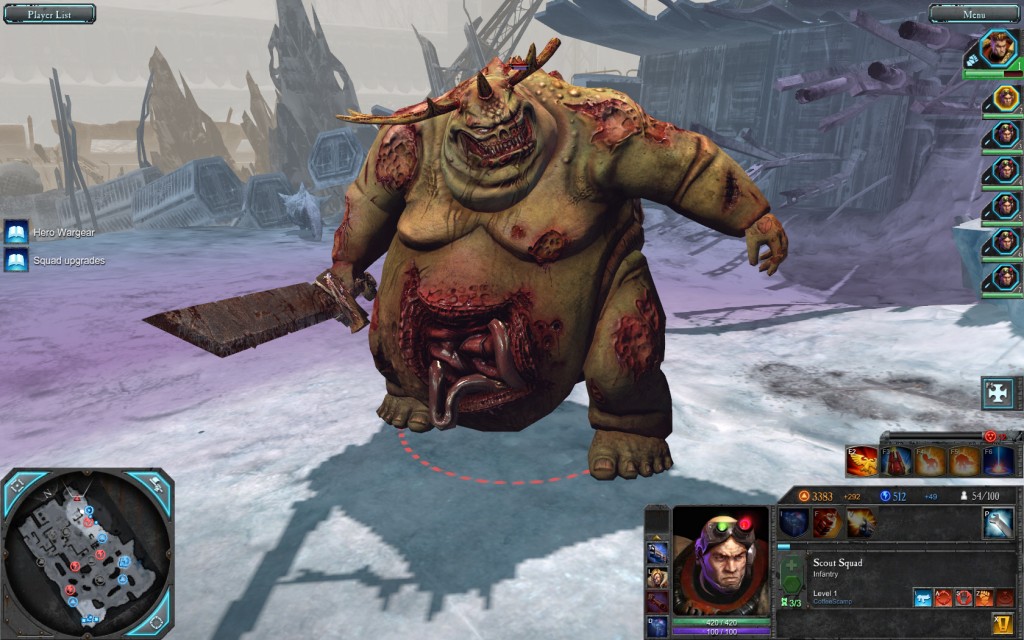

The top one Im trying to make as detailed as this Super monster in game a 3v3 game can have three of these monsters in it.
hehe you do realize though that that high quality model in that image is an illusion right? :wink: … for all it’s detail the whole model is still probably no more then 20-24k poly’s/tris. … all of it is done with displacement and normal maps and other such techniques which is what makes the ram size of video cards so important. higher the ram size bigger the textures… more the illusion works.
thats why is so important to get your models organized well from the beginning because it lets you play magically with the final products detail levels.
I know a good majority of that look is an illusion Ive seen alot of peoples work that theyve done that style for games but you get what Im tryign to achieve its better to try then never try at all.

You really need a tablet and to work on character design and rendering. The design and flow of that character at the top in not appealing and the anatomy isnt really working either. Not trying to put you down though just thats my honest opinion.
