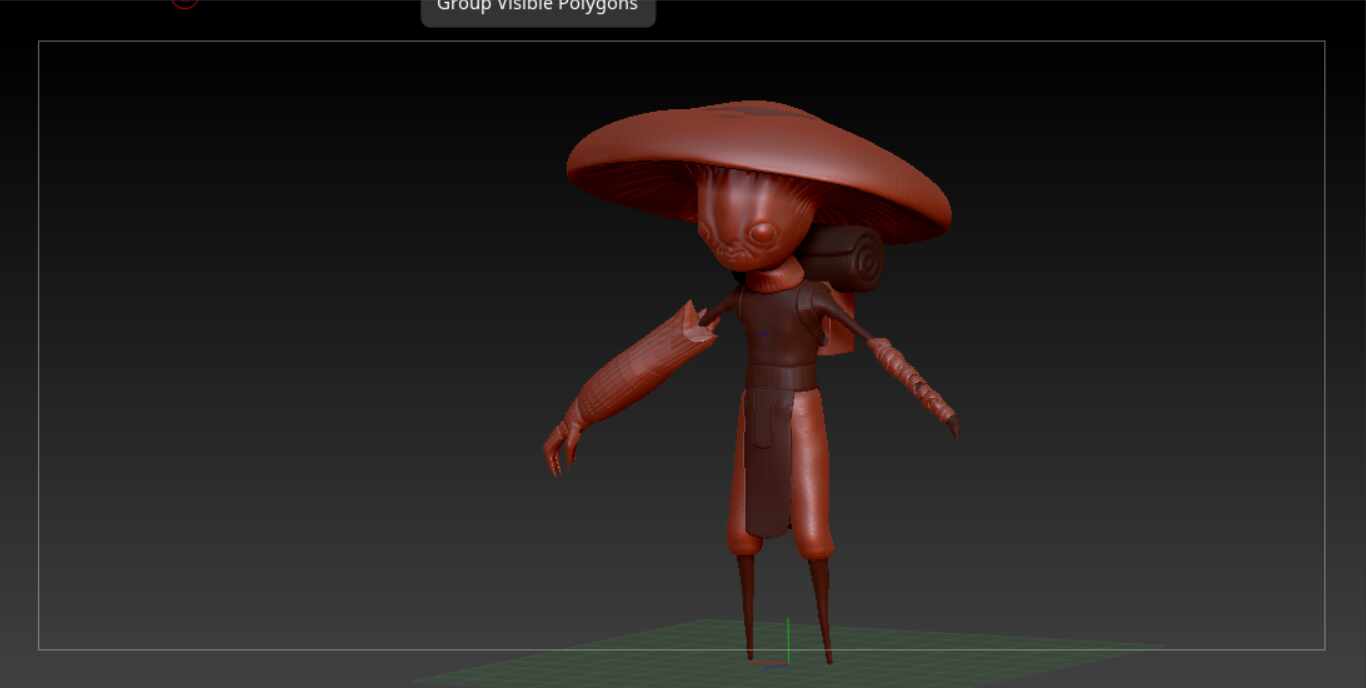

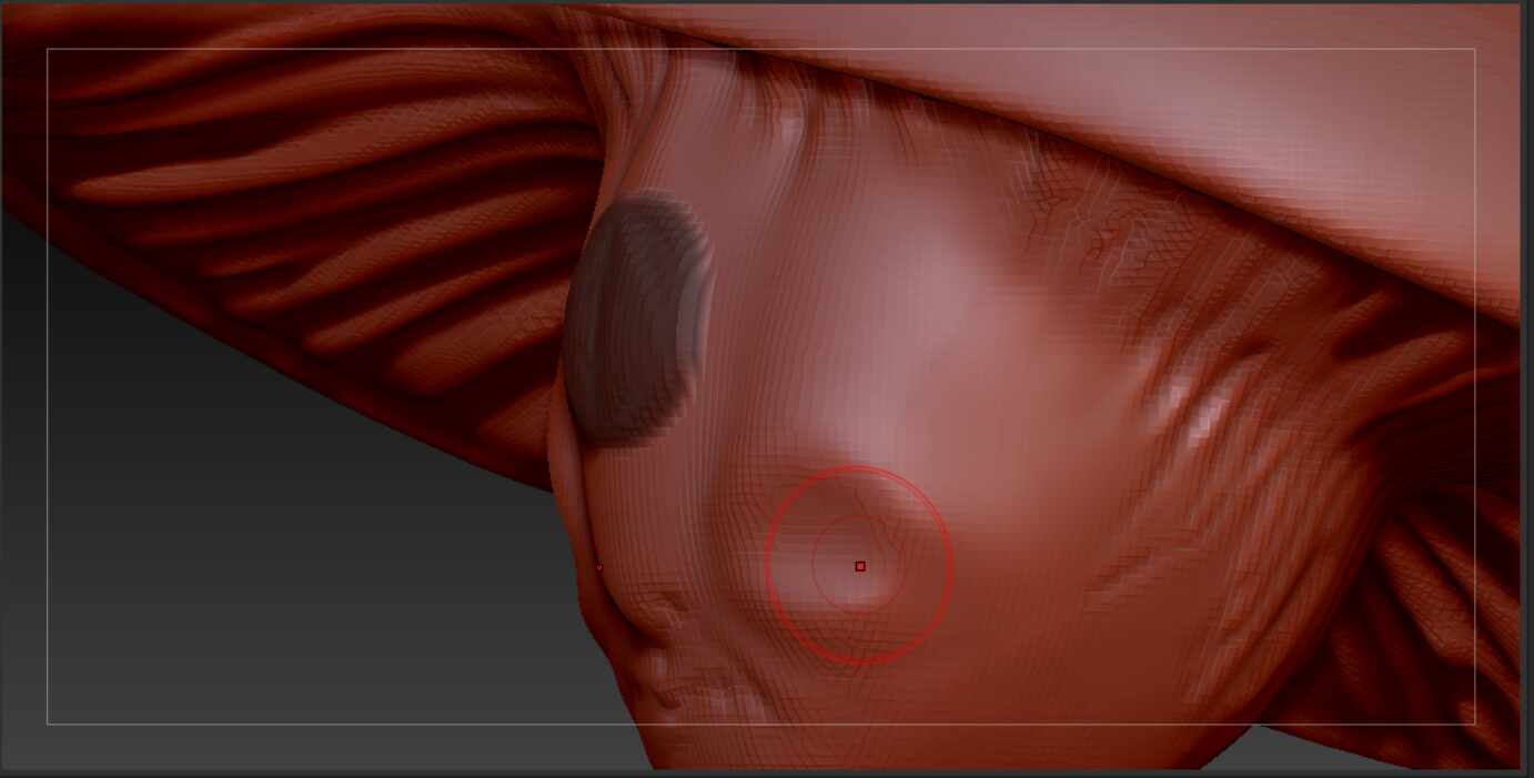

I’m super new in zbrush and this happened. some parts of my model have gotten darker like its masked but its not. and now when I try to use clay brush its darker than my model too. by the way its not because of my v button and the texture is off as well.

i tried your solution .reseting my brush didnt do anything but when i toggle of the colorize in polypaint it turned my whole model darker and when i used the brush and toggled it on, the resault of my brush was same color of my model.
however problem doesn’t seems to be brushes fault because some of my subtools were completly darker than the rest and i didnt know when that happened
in those subtools my colorize soloution doesnt do anything and model stay dark no matter what i do.
