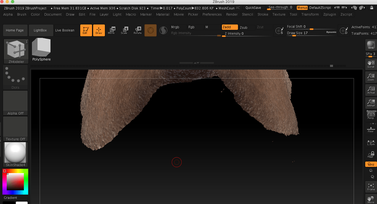

I have a model of a face from photogrammetry and want to close the chin section a bit. Here is a screenshot of the model
What I want to do is “close” this area that is surrounded by the three sides of the model (does it make clear what I mean?)
I played around with the Zmodeller brush a bit but this brush assumes holes that it can fill. Can anybody give me a tipp, how I can add a planar surface to this area of such a model?
Thanks
Norbert
Do you mind sharing a more complete screenshot of the mesh in question? I need to see if there’s a logical “hole” to the mesh that zbrush could close or trim, or if it’s the common situation with photogrammetry that what you really have is a distorted plane that will require more extensive reconstruction.
What you may need to do is project the detail from that face onto a more manageable, closed mesh and sculpt it into shape, rather than trying to construct something directly from the current mesh.
