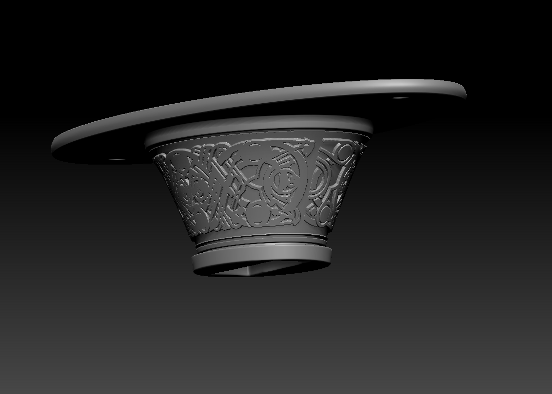

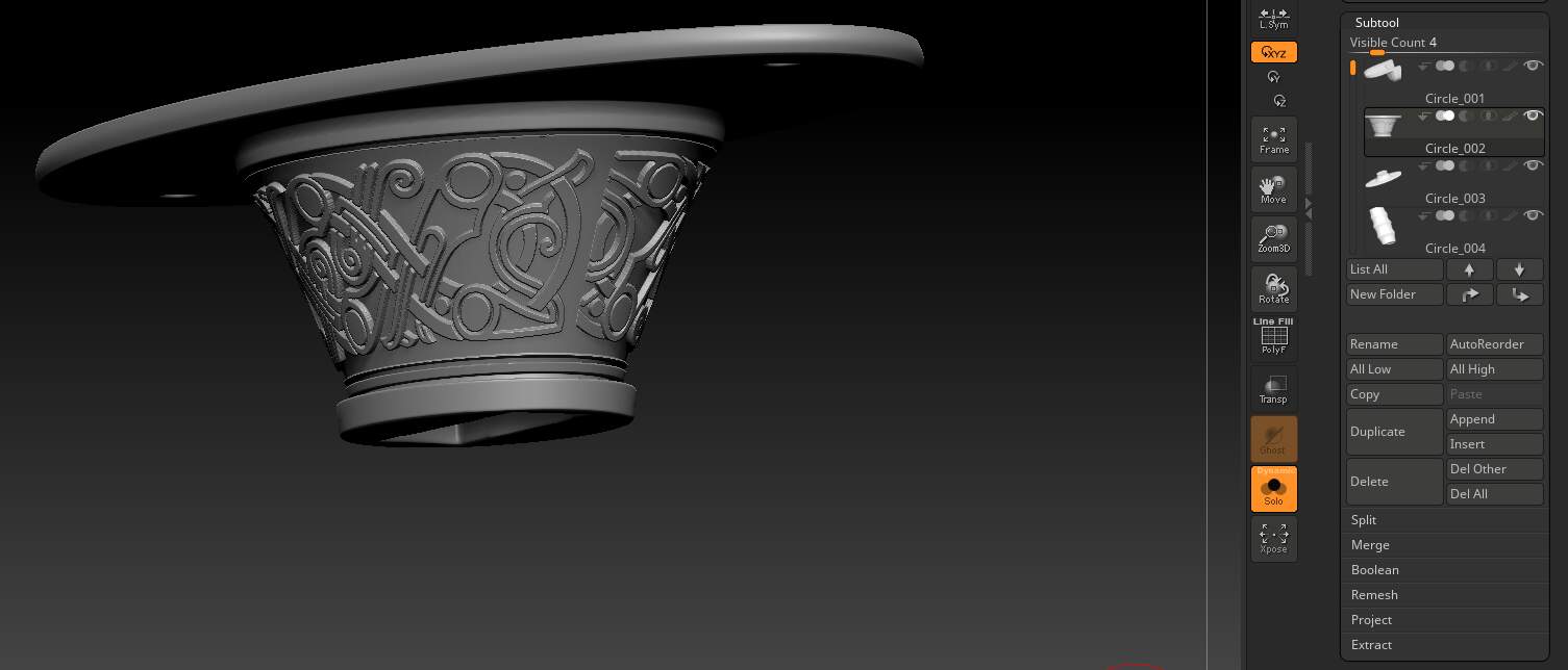

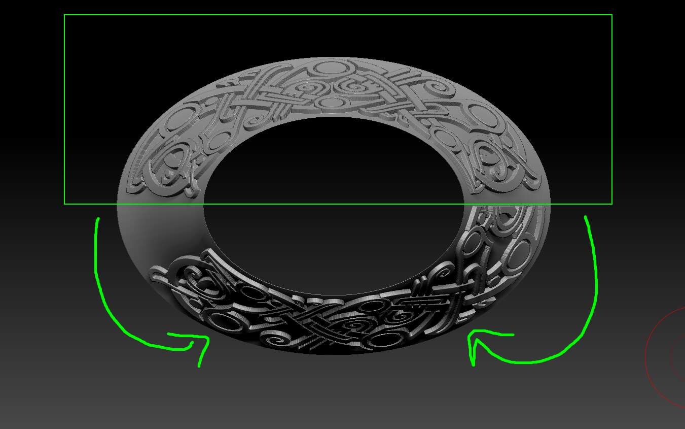

How do I mirror the side where the ornament is aligned to the other side? This cylinder is part of a bigger subtool. I tried using the mirror function but this created undesired results.
Hello @Howzer,
Assuming your mesh is centered in the worldspace (you can preview this by enabling the floor grid with the relevant axes, and making sure the elevation in the Draw Palette is set to zero), you can use the Tool> Geometry > Modify Topoloy> Mirror and Weld function set to the relevant axis.
Note that this function works in one direction, so you may first need to flip the geometry to the other side with the the Tool> Deformation> Mirror function, in order for the correct side to duplicate on the other side of the axis plane.
Good luck!
That worked nicely! thankyou.
