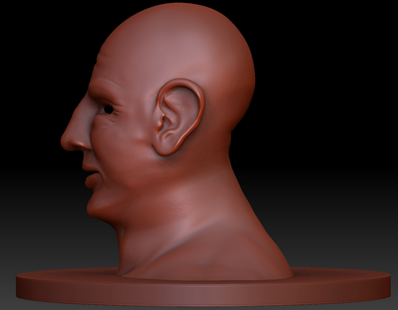

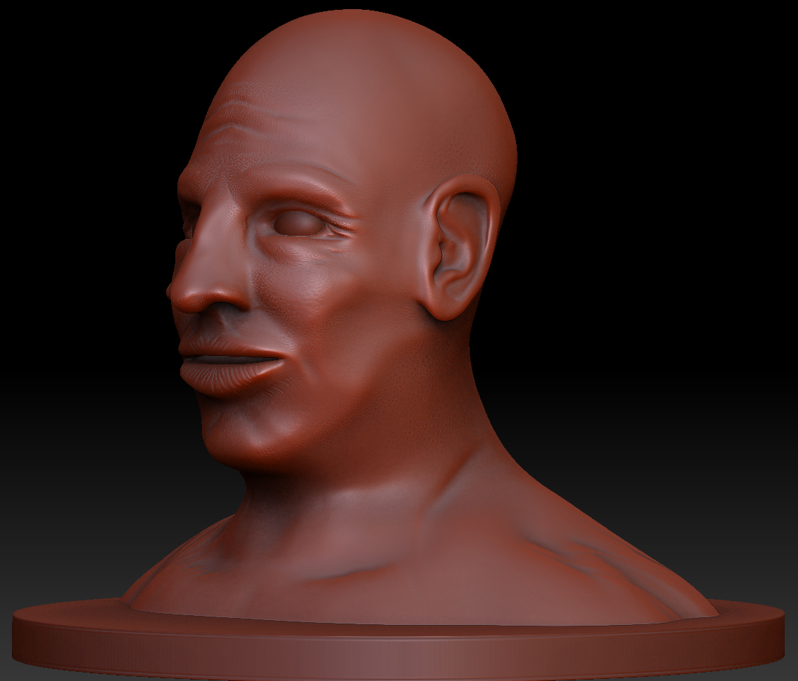

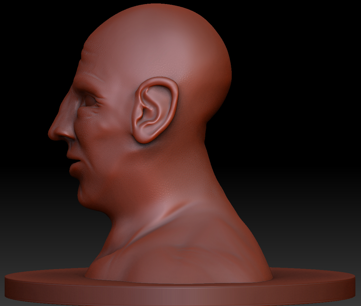

this is the finished head from a game character i am currently working on.
for this I looked at the digital tutors tutorials, they are really great and helped me understand and create the head with the right proportions along with using specilist brushes in zbrush
C and C welcome an needed to imporove this skulpt
check this space for the fully finished character along with a group a different characters im creating for this project
The cheeks don’t look quite right.
The lips need more work and the wrinkles in the lips need to be more subtle .
The ears need more work, they need to blend in to head more where the ear meets the cheeks.
The back of the head looks wrong, it needs bringing forward and so does the forehead.
The eyes need to be more pinched in the corners.
thanks will start correcting tomorrow its all part of a full character which i need to finish, this is my first human form based character and i am using one of the tutorials from digital tutors to create the character

I dont mean to be harsh either, but its the only way to improve. I am in no way a phenominal artist but sculpting a head is very difficult because its soo easy to pick out issues in a model, I mean we are soo familiar with the human body that you need to be very accurate and precise.
Like said before the lips need a ton of work. They do not blend into the head at the corners but feel like they were put on like a mr potatoe head. The overall shape of the ears is ok, but the placement really needs to be worked, there is no blending between the ear and the head.
The clavical doesnt run correctly into the shoulder it is sort of half done.
I would really go to your base mesh and rework the overall shape of the cranium and jaw/chin area. The jaw line looks like it starts going back correctly but then it starts making this weird J type shape when it reaches the ear.
I think there needs to be a bit more of a temple then you have right now.
If you are going for an African American man then the nose is a bit more correct but if this is a caucasian individual I’d say the nose is pretty wide to me.
Its hard at times when you start working on something and really get into it, but really step back and look at it, youll be able to see all these issues that we are pointing out.

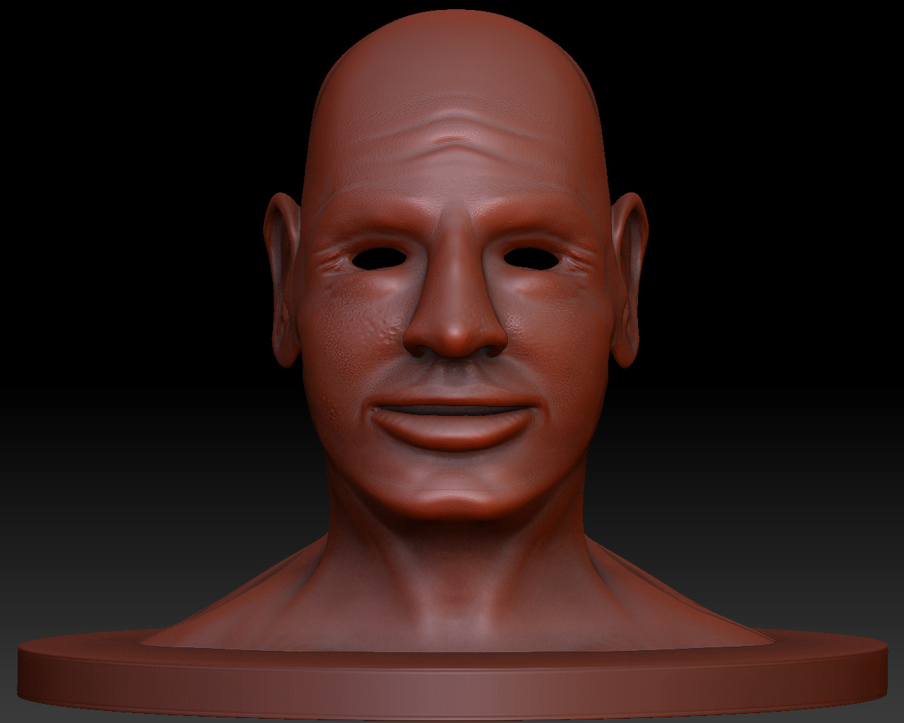

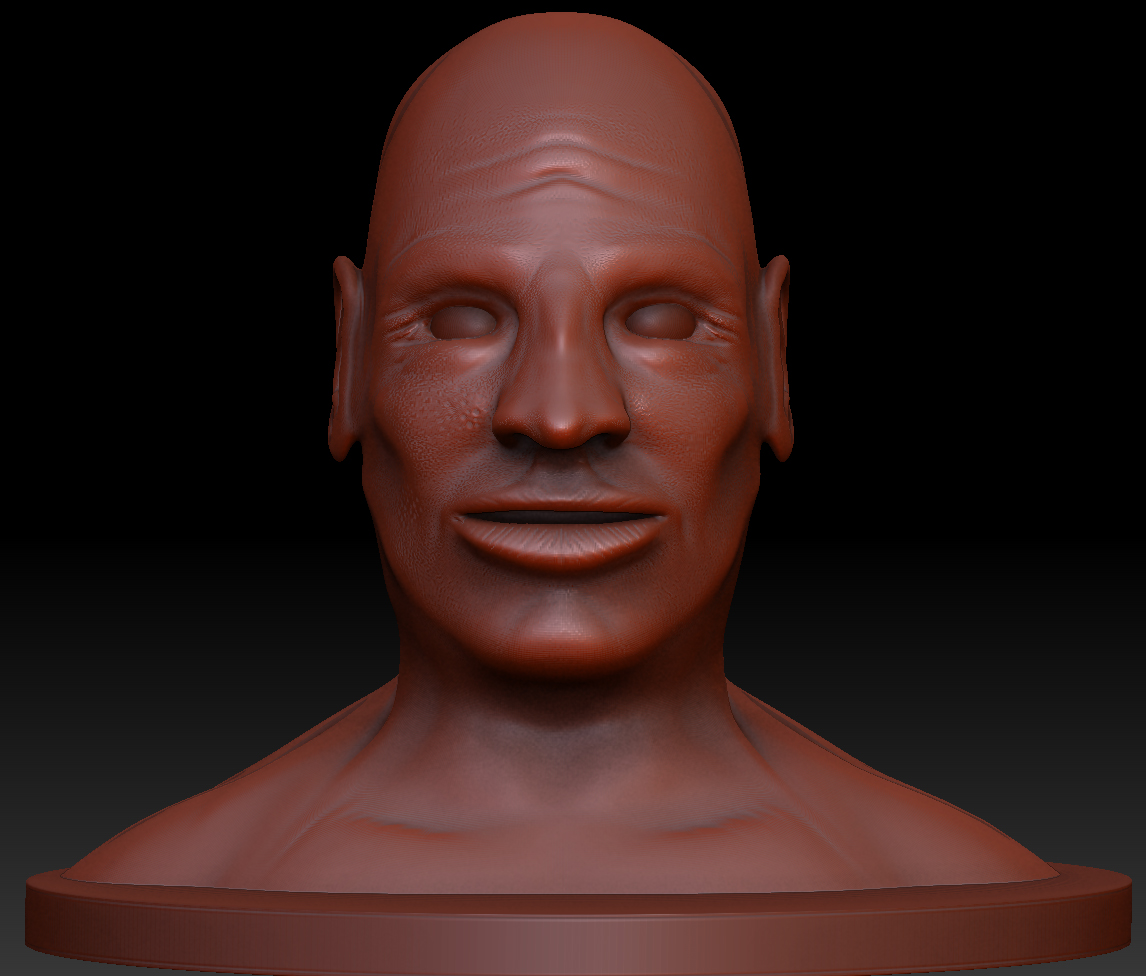

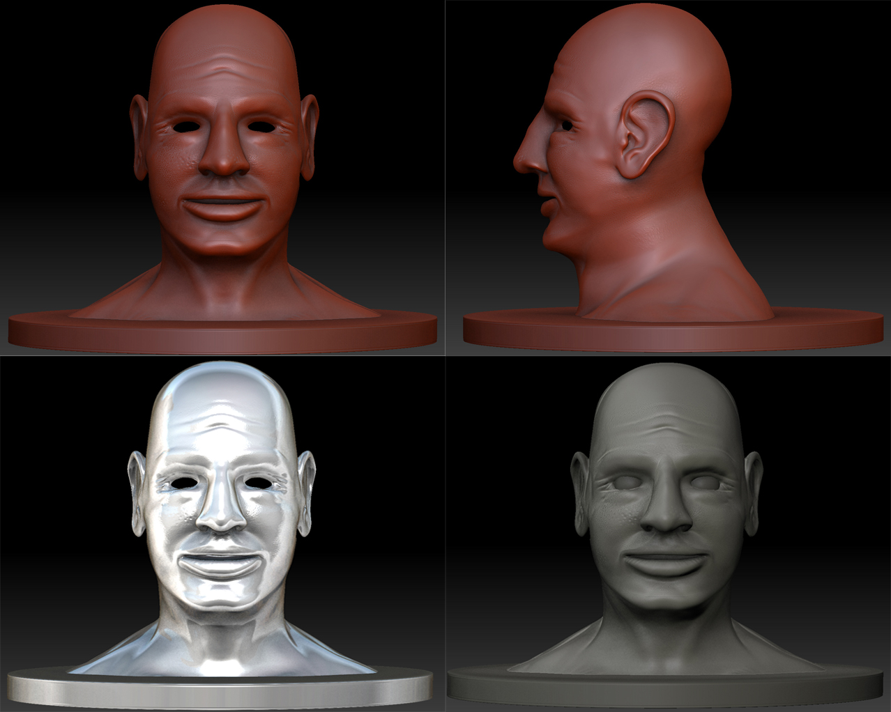

this is my V2 of the head
definite improvement
the things that strike straight away is the wrinkles on the corners of the eyes need smoothing down and redone, and the corners of the lips need a touch up and looking at the side view bring his top lip out slightly

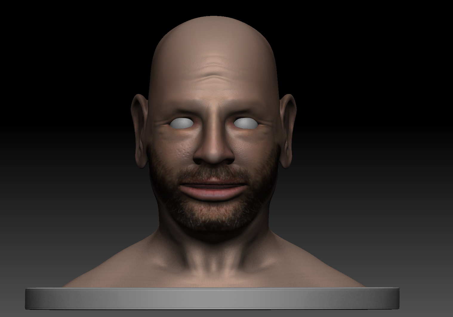

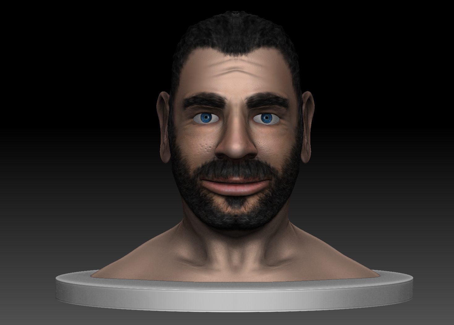

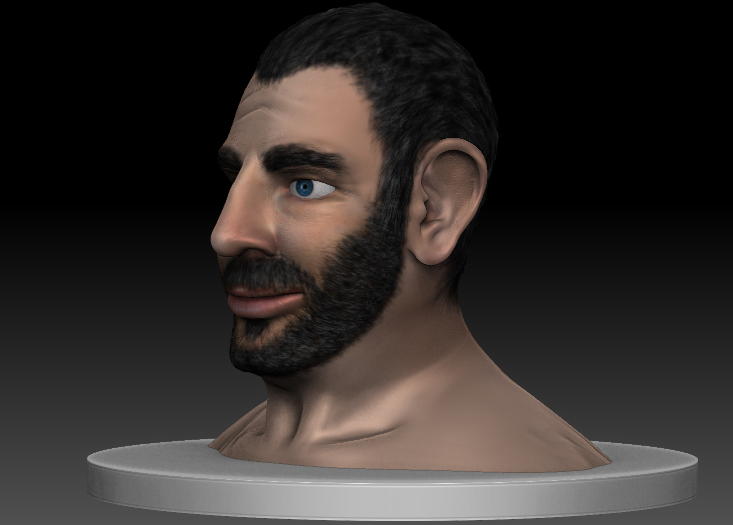

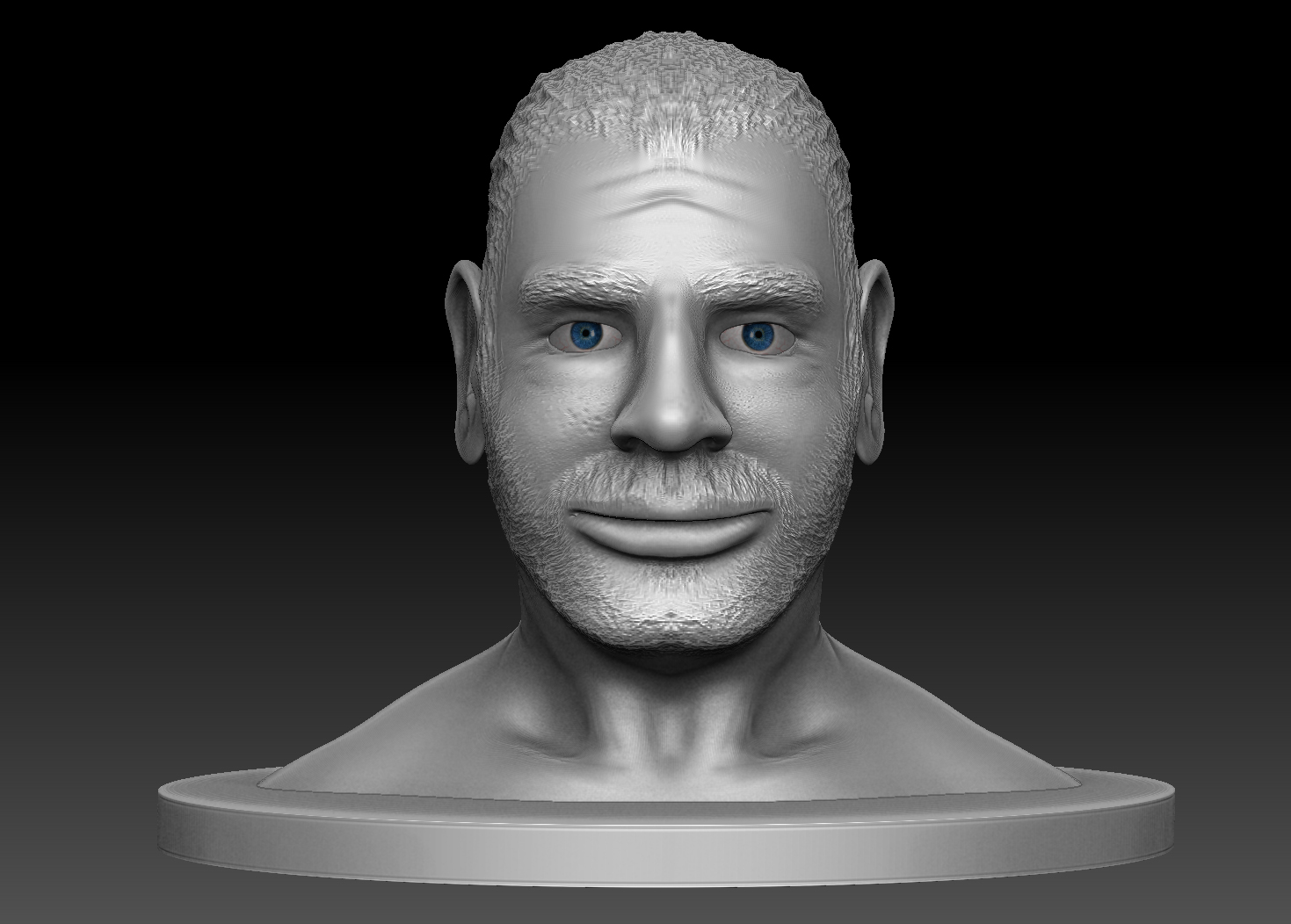

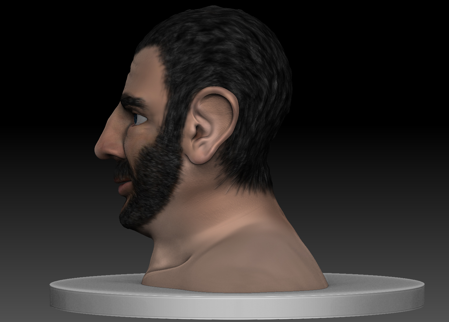

Textured with V2 beard
C and C welcome and needed
I think you’re jumping to texturing and polypainting waaayyyy too early man. It looks alright, but there is a ton of work that needs to be done before you try pores, beard, skin color etc.
The most glaring thing that immediately jumps out is he has HUGE ears, almost cartoon ears. Also, you need to constantly rotate your model because while the ear detailing looks really nice from the side view, from the front it just looks like two holes in the side of his head. Take a second look at the sternocleidomastoid also, which is what your character has coming from his chin for some reason lol.
The best thing you could do is just google search for faces similar to the character you are trying to portray, study how prominently or subtly their muscles are visible, broad proportions etc and compare them to your model.
It’s looking better, but you should definitely put in a lot more work before painting :+1:
