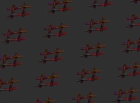

I’ve created 4 overlapping pipes and want to use this as a micro mesh but when I put on a plane the pipes do not touch each other at any point. I’ve tried all the buttons but none seem to fix my problem. how do I solve this please.

Select the mesh you are using as the Micromesh and enlarge it. You’ll need to re-apply the Micromesh when done. If you look at the Tool>Preview window you will probably need to make the mesh a bit larger than the window. Use the Tool>Deformation>Size slider. (If you Shift+click the sub-palettes titles to open them you can have both open together so you can check the size.)
