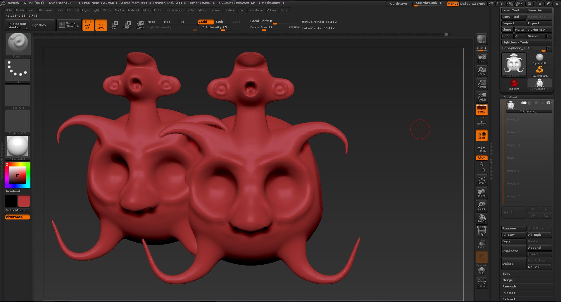

I have just duplicated my mesh accidentally and ctrl-z does not undo that so I have been trying to select the new mesh and delete it. The issue is I really do not understand ZBrush’s mesh/tool/sub tool management system. I did watch a video that went over the sub tool menu but that did not help at all.

Based on your screenshot, your duplicated mesh resides in the same subtool “layer” as the original… which is the normal result when making a duplicate through the CTRL key while you’re in one of the move/scale/rotate Transpose modes. (Duplicating a mesh with Transpose)
This is different than if you were to go into the Subtool palette and explicitly clicked the Duplicate button. There, it makes a copy of the tool (mesh) and puts it in a dedicated subtool “layer”.
When you have multiple meshes under a single subtool layer, CTRL-SHIFT and click the mesh you want. The other meshes turn hidden. CTRL + mousedrag on an empty part of the canvas to inverse it. CTRL + mouseclick on an empty part of the canvas to restore/reveal all meshes.
When you get some of the (unwanted) meshes hidden, go to the Tools > Geometry > Modify Topology palette where you’ll find a Del Hidden button. This permanently deletes those meshes you intentionally hid.
It’s also possible looking at your screenshot you made a 2.5D layer of your subtool (hitting Shift + S will do this)
To get rid of it, just press Crtl + N, or go up to Layers > Clear
If this isn’t the case then CarterTG’s solution will work.
Cheers ~°~
I don’t think it’s a duplicated mesh (it doesn’t show up in the preview window), but rather a classic case of stamping the model onto the document. In this case pressing Ctrl+N will clear the document and leave just the 3d model behind.

Thanks everyone for the replies. I’ve read each reply and figured out that ctrl-n is what I needed.
