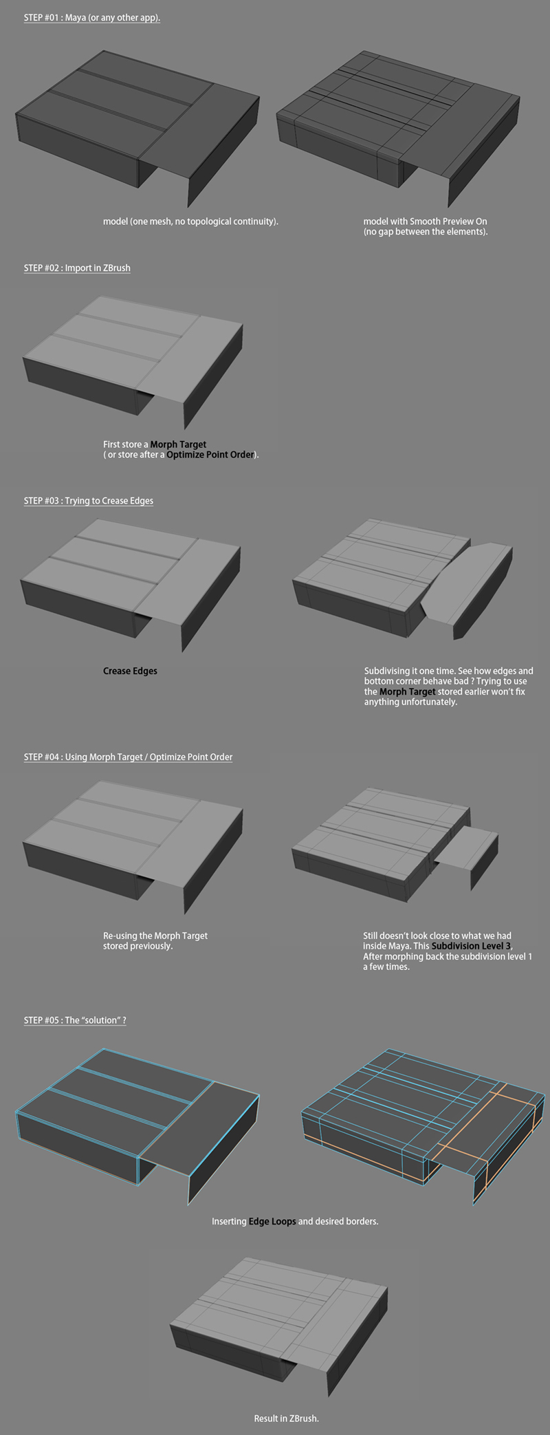

As I said in my first post, I already tried using Crease. I made an image with explanations to make my point more clear (see the attachment).
It seems the last technique used behave better, so the issue is mostly based on modeling more than a ZBrush issue, you have to know ZBrush will create these gaps and deal with it inside your external 3d editor. This is quite inconvenient if you have hundreds of meshes and want to import them inside ZBrush.
