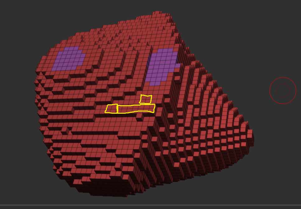

Okay. I should have detailed my question clearly.
Let’s say there are 9 square pieces of mesh arranged in a 3x3 grid. Now I want Z-Brush to merge those 9 pieces into a large square mesh. This is the main principle which should be applied on the entire volume with such arrangement of square mesh pieces.
Any quick method to do that?

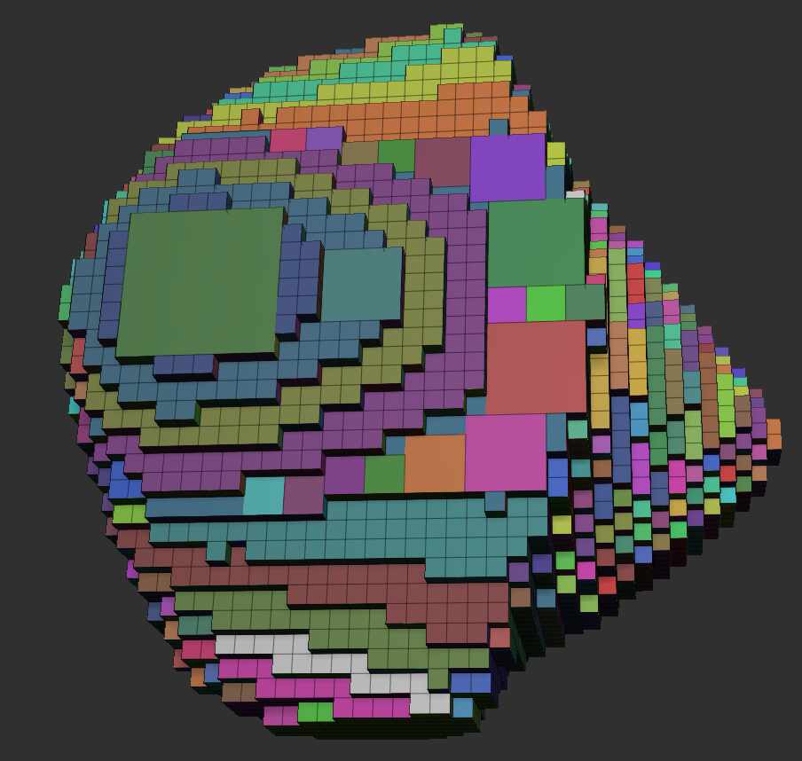

There is no automatic process, but you can do like that
  1. polygroup > polygroup by normal
  2. hide one group at a time and apply tool > geo > modify topology > unweld group
  3. use the zmodeler with alt key to quicly draw a selection of polygon that you will turn into a new polygroup.
  4. split the biggest islands/chunks to new subtool.
  5. use modifiy topology > unweld group border again.
  6. use tool > geo > edgeloops > delete loop with the angle set at 1 degree.
repeat the process with the other subtools.
then merge them all and complete by modify topology > weld points.

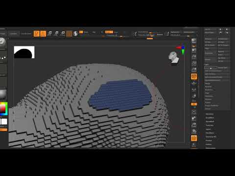

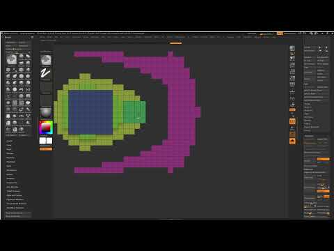

Okay. I tried. It didn’t work. I’m definitely doing something wrong that I can’t figure out. Here’s a screen-recording.
I made a short video to show you the process
hope this helps,
Nicolas
