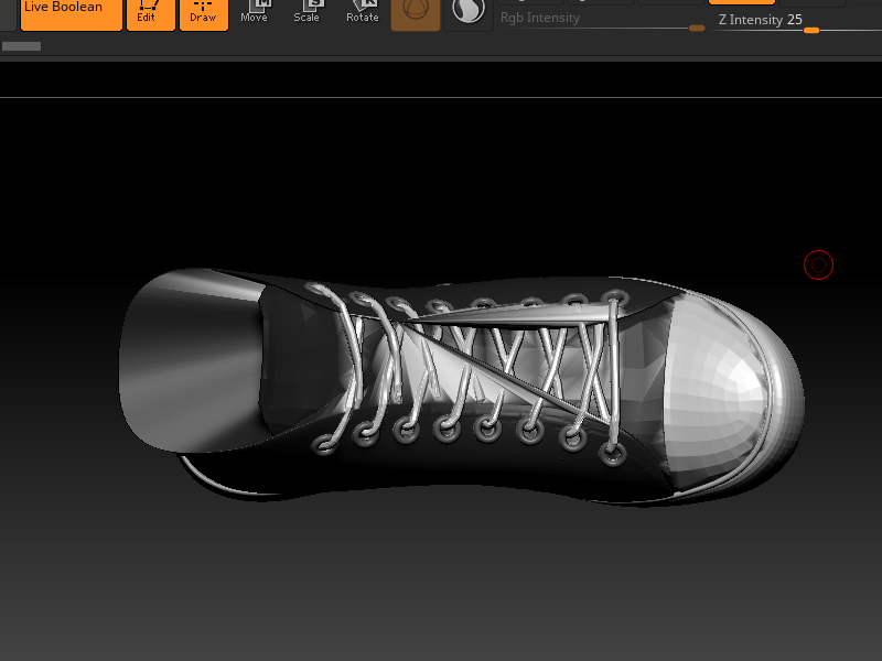

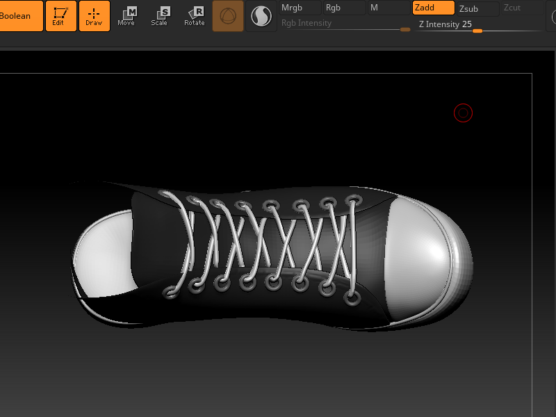

hi, i’m trying to export my mesh as a single subtool and if i do on the negative subtool: polygroup-group as dynamesh sub-mergedown the negative subtool become positive and doesn’t remove anymore mass… i tried also to use merge boolean but the mesh deformed norm def

i tried but doesn’t work, the mesh deformed like in the image
Try giving the different pieces some thickness, especially if you’re using dynamesh for the booleans (dynamesh prefers water-tight volumes)
