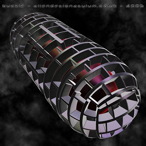

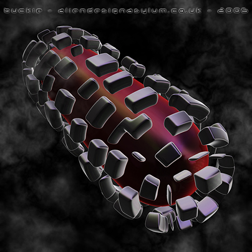

Not that mind blowing but they look kinda funky…
](javascript:zb_insimg(‘5262’,‘pill3.jpg’,1,0))
They really have a nice rendered quality to them. What material did you start with?
I used a basic metal but just changed the reflection map for an image I did a while back (which had quite a few strong colours in)
Then I just fiddled with the lighting/shadows & render settings…

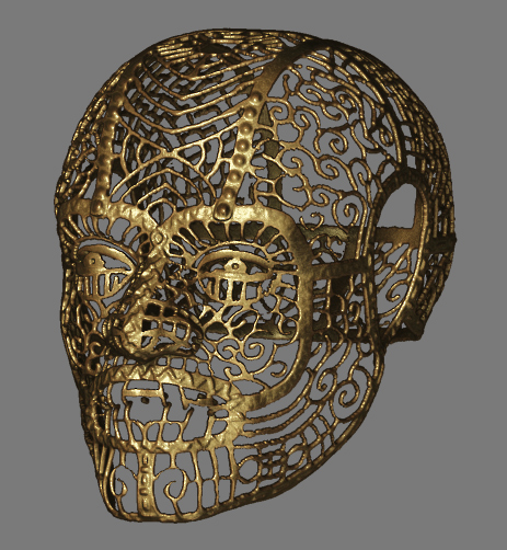

I have a question for Bas Mazur-
That’s a beautiful head you have posted up above- did you use ctrl as suggested by Meats to paint a mask… or if not how?
Incidentally, when I follow this tutorial mine also seems to come out reversed from what’s expected, but I just invert the texture in Photoshop and it works fine. I’m sure you can do that in Zbrish, but I’m just not there yet…
Dan
With the control the mask is made. In the Tool>Masking menu I inverted the mask. That’s all
Excellent sir! Thank you.
Gee… I drew a mask using ctrl, inverted it, but now the "int"button is not there…???
Dan
From th model you made you have to make a skin-object first!
It only works with this kind. After this paint the mask. Invert it or not.
In the maskmenu you will see the button HidePt, press this one.
Go to Geometry and push DeleteHidden. After this you can inflate the mesh!
