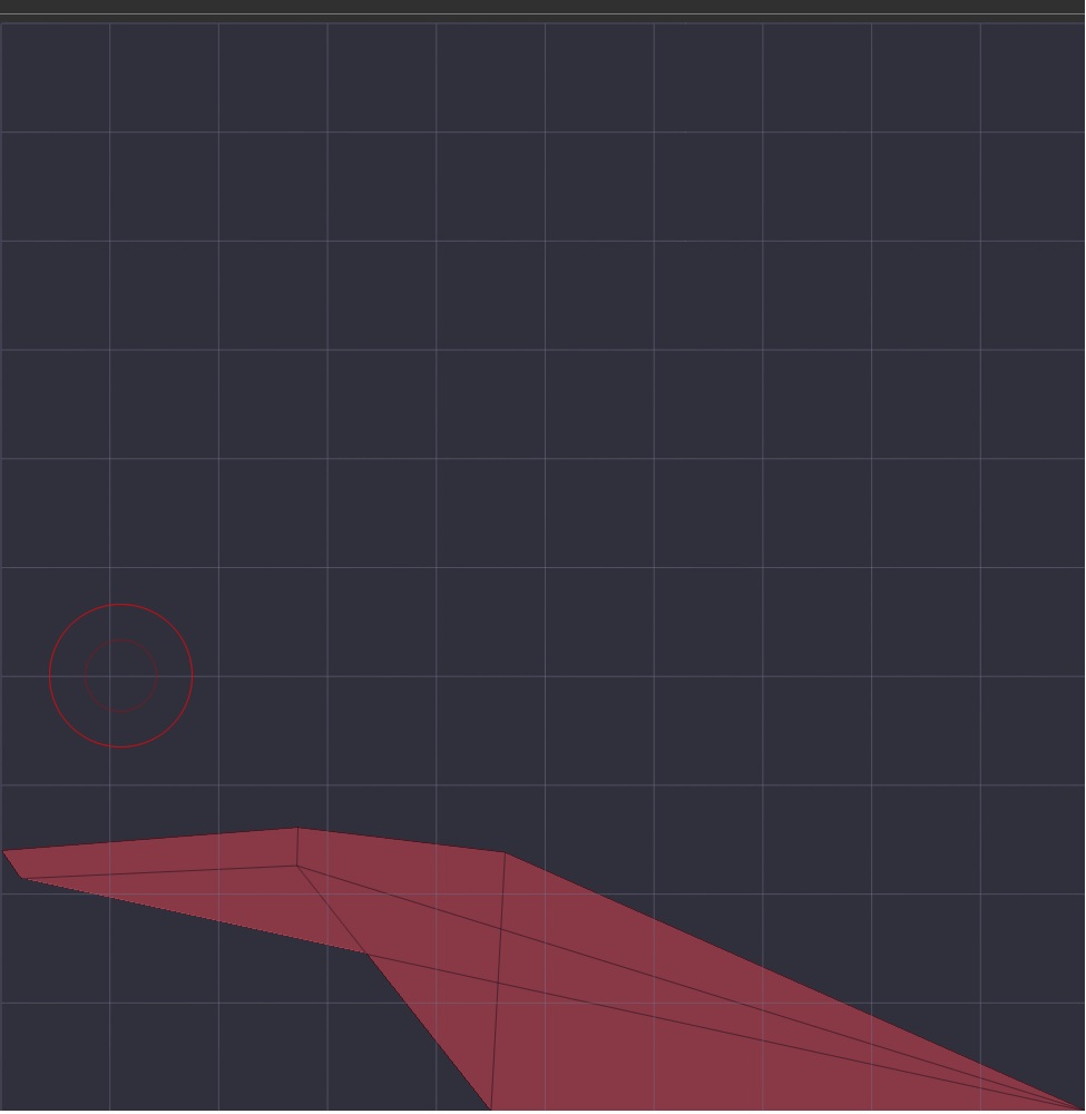

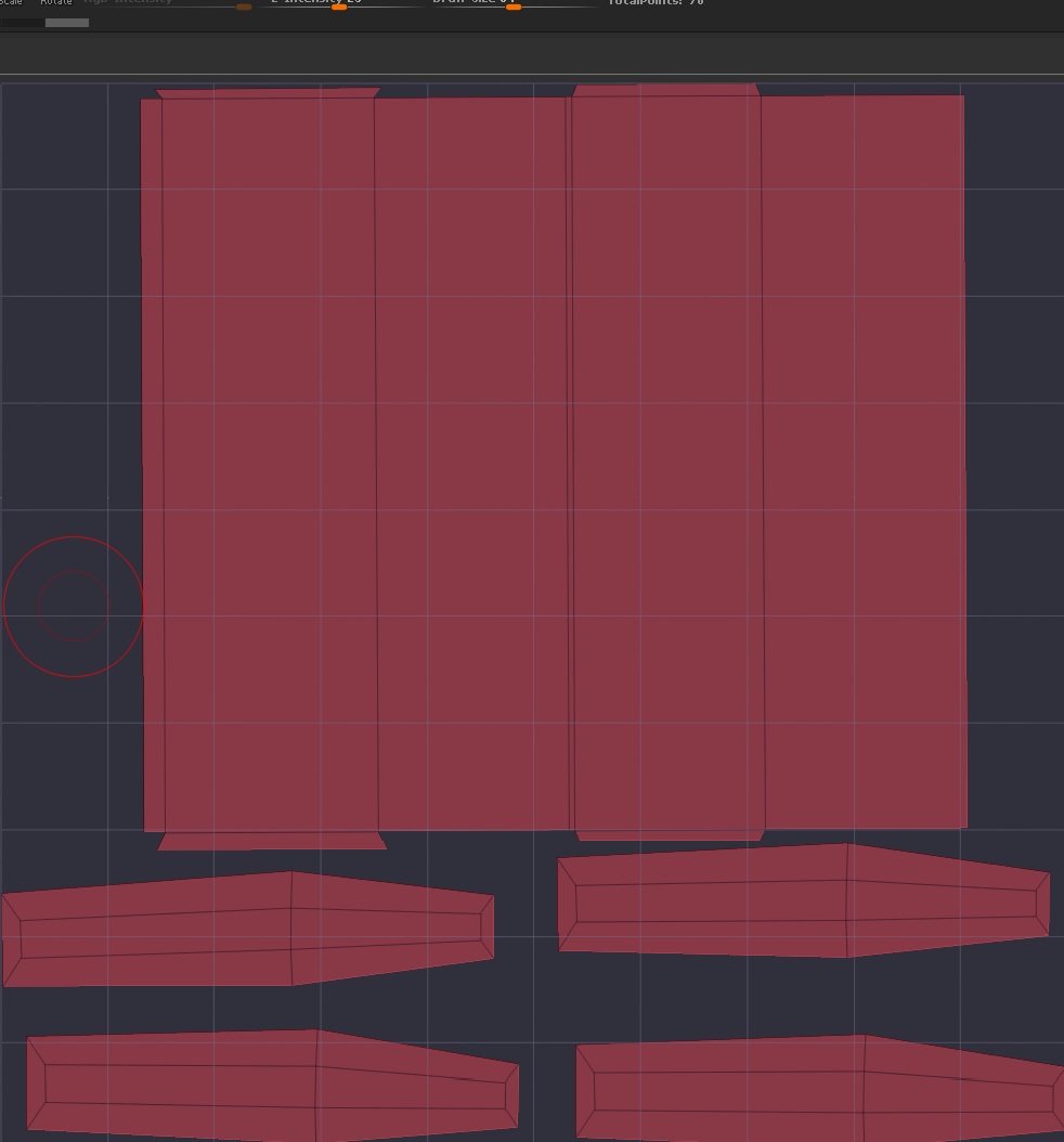

I am using Zbrush 4R4 with the latest GoZ version, Maya 2013, and 2012. I created a UV set for a simple cube to test the problem. UV looks fine in May. In Zbrush I flatten the UVs and they are all scrabbled. I have tried this with several different models but I end with the same result when using GoZ from Maya to Zbrush. Going from ZBrush to Maya seems to work just fine. Exporting as an Obj from maya seems to carry the UVs across to Zbrush. I used GoZ frequently before 4R4 with no UV issues. Anyone else seeing a problem with UVs when going from Maya to Zbrush? </SPAN>
You try checking/changing your UV export/import options? Sometimes it’s just a matter of UV getting flipped the wrong way.
Yeah, it’s not flipped, basically one side looks collapsed and the other side looks like the uvs are disconnected.l
Can you show some screenshots?
These are the two screen shots of the problem. On is with GoZ the other is with Obj Export from Maya. This is with Maya 2013. But i have also tried 2011 and 2012.

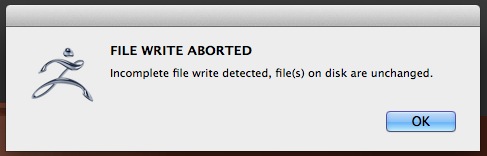

If I send a file back and forth more than once (unless I rename it in ZBrush) I get this error and ZBrush will crash on me.
Works great…thanks
So the problem I seem to be having with the script now is when I send it from Maya to Zbrush, the file becomes read only. This causes the UV to keep, but when I try sending it Zbrush to Maya, because the file is still read only Zbrush thinks no changes have been made and then crashes.
Any ideas?

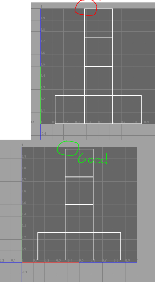

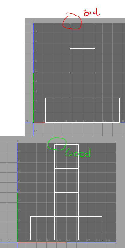

Has nothing to do with scripts. Basically Zbrush hates outside the 0 to 1 UV space. If your model’s Uvs are even near the outside borders of the space in maya it will fold the uvz in Zbrush using GoZ.
So in Maya
After you move the uvs in a little try GoZ and you will See (hey that rhythms).
Enjoy
