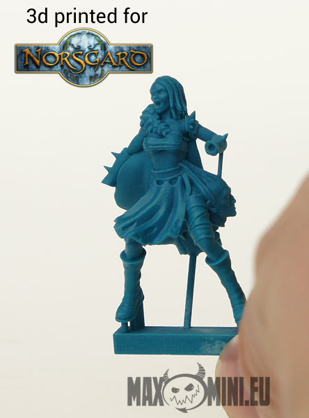

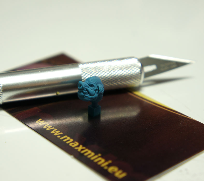

One of the ongoing projects we’re working on - and a pic of the print showing the scale
. It has turned out this head is too big and we need to scale it down

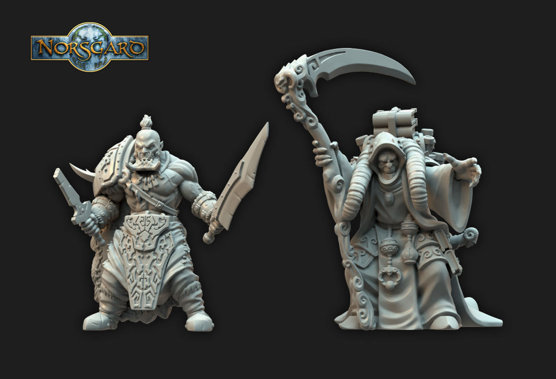

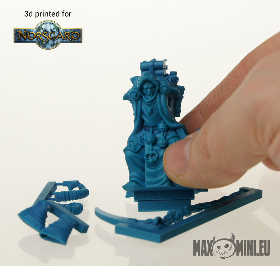

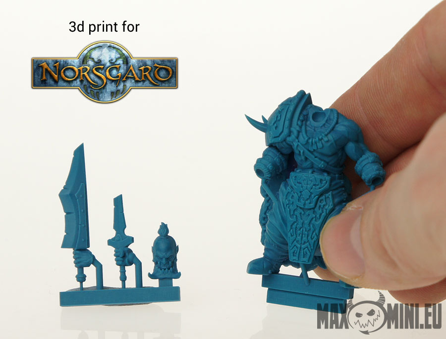

Recent prints we did for Norsgard Miniatures (used with permission, models sculpted in ZBrush, rendered in Modo):
To save the work during moulding we printed those with all the sprues/vents required.

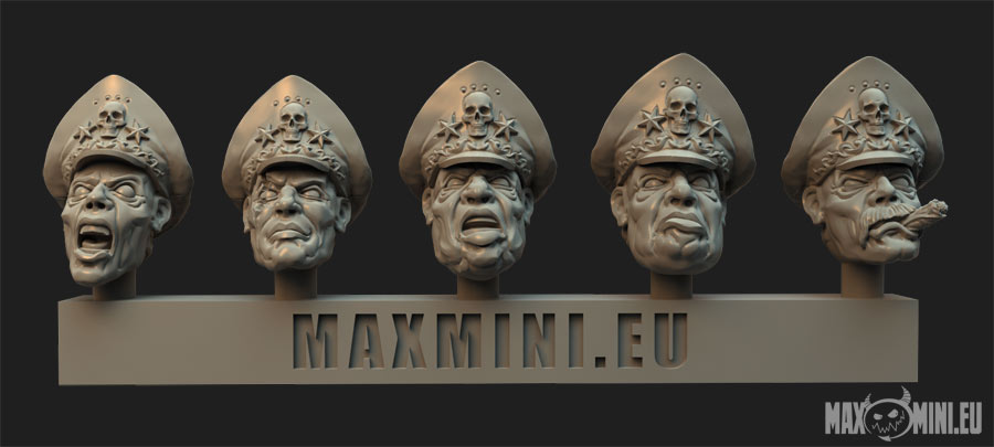

Konrad has been working recently on a set of officer heads:
Again he exprimented how much “overemphasizing” the details affects the look of the real small scale model. This time it has shown us how far we should go to get the scars right.

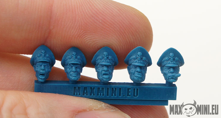

Photo of the print - hasn’t completetly dried up after dewaxing, so taking a pic was tricky:

So, on this last one it looks a little rough. Is that just the wax? Can you clean it up with heated sculpting tools or exactos/sandpaper? Carve or add to? It also look like you lose a little of the detail in the hats too, like the 4 studs above the skull and the details around the bottom. So, that seems to give you the amount of detail that you will get out of it, can you add those back? Or in casting would you lose that small of detail anyways? The skull looks like it could be pushed out a little more also to make it really pop and show up. Still, nice detail.
@Sigmund: look forward to it
@Grizzly Jake: as mentioned the pieces were still wet when I’ve been taking the photo (I couldn’t wait for them to dry), so it is not as good as usual (shine from fluid and fluid itself obstructs the details). As for studs on the cap - they were dropped during slicing. They had no sense - they are so small (check my fingerprints on the pic and imagine size of the stud :D) that simple thin coat of paint would mask them. SO we’ve set thicker layers for the part of the hat - removed the studs and saved us some time.
Other than that IMO the detail is fine - I’ll show you resin casts as soon as they are done (will propably make a vertical overcoat to show those even better
When it comes to cleaning - I’ve mentioned it earlier, as we sometimes print in lower res I found out that rubbing alcohol gets rid of the stepping effect. Also you can use all the other tools if you want - but I prefer to do that on a resin copy

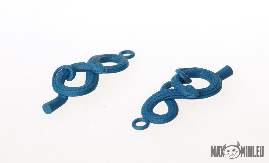

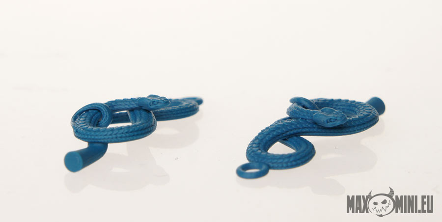

Recently we’ve been working on a 25mm “snakes” for a fellow jewelry maker (I think they’ll be used on earings). Kuba did base model in Rhino (with my little help - as I knew we had to be careful about volume/weight) and then Konrad did the sculpting in Zbrush. The render and some minor tweaks were done in Modo.
Snake looks good… 25mm in total height? I think I am on the right track then, the local guys must just get their printer sorted… in the mean time Modo/ZBrush have to continue with sculpts…
