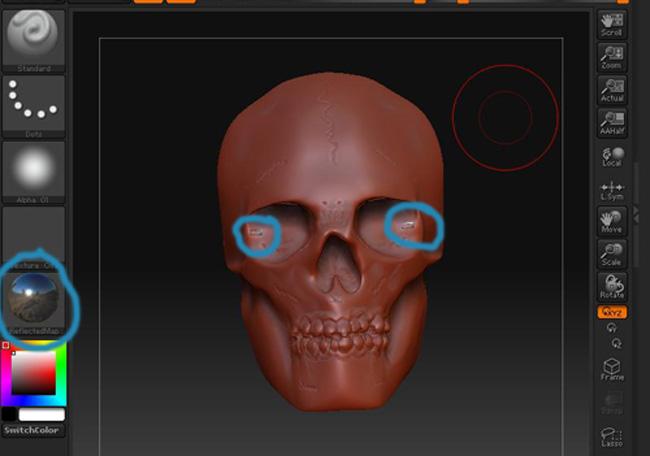

thanks for the reply. It is in edit mode when I go to change the material. It mainly seems to be on this skull I did in this tutorial. Here’s another kind of odd thing though. It seems the material is changing on it. However there is only seems to be a portion of it. I’m uploading a picture of it to kind of see what I’m talking about. Nevermind the skull not being anything of perfection. It’s my first sculpt. sort of. I was following the tutorial best I could.
you probably have a very small mask in that area, or that area had the material filled on the object. simply make sure the mask is off, then change the material, or fill the material with the “flat shader” and that will remove the material.
still didn’t work. I went under mask pressed clear. I don’t have a flat shadder it don’t seem. Only thing I seen Was “fast Shadder” So I pressed that and then tried to apply a different material. After that I tried “flat color” still got nothing. Only thing either seemed to do was just make those little areas a different color.
clear all masks> select flat shader under materials pallet> use subtoolmaster> fill material>the flat shader (it looks all white)> then select a new mat. and wahla. ps have all other subtools unchecked (the subtool eye is off) that you don’t want filled.
