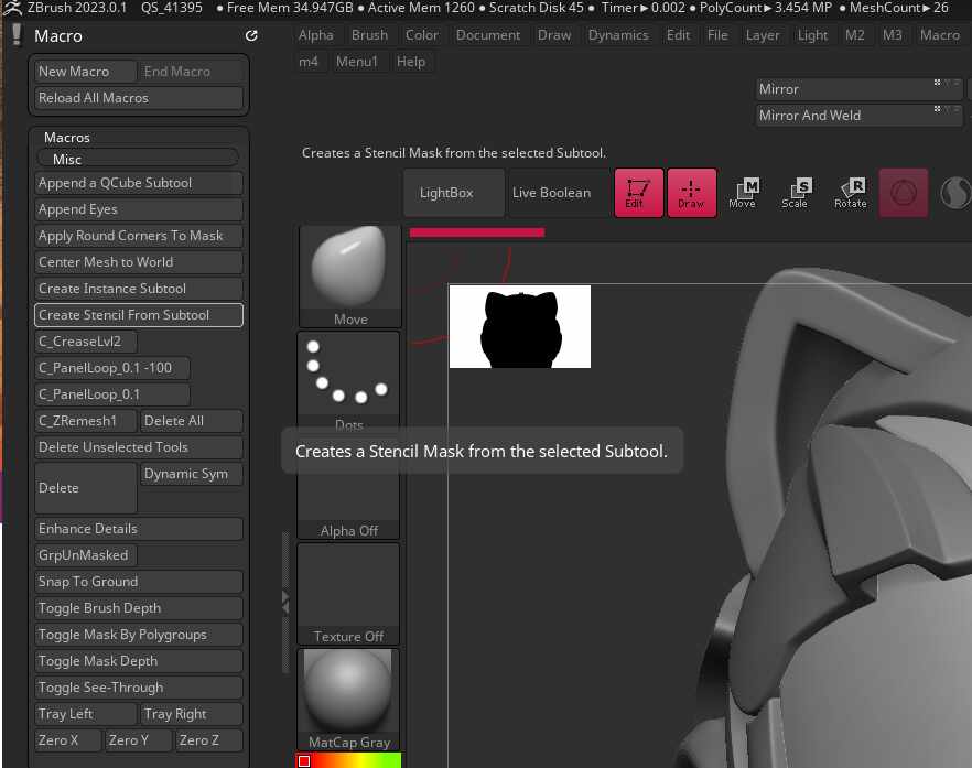

There is similar way to do but by stencil, and use it as a mask in a way. It’s in “Macro” tab, “Create stencil from subtool”
image|882x697
