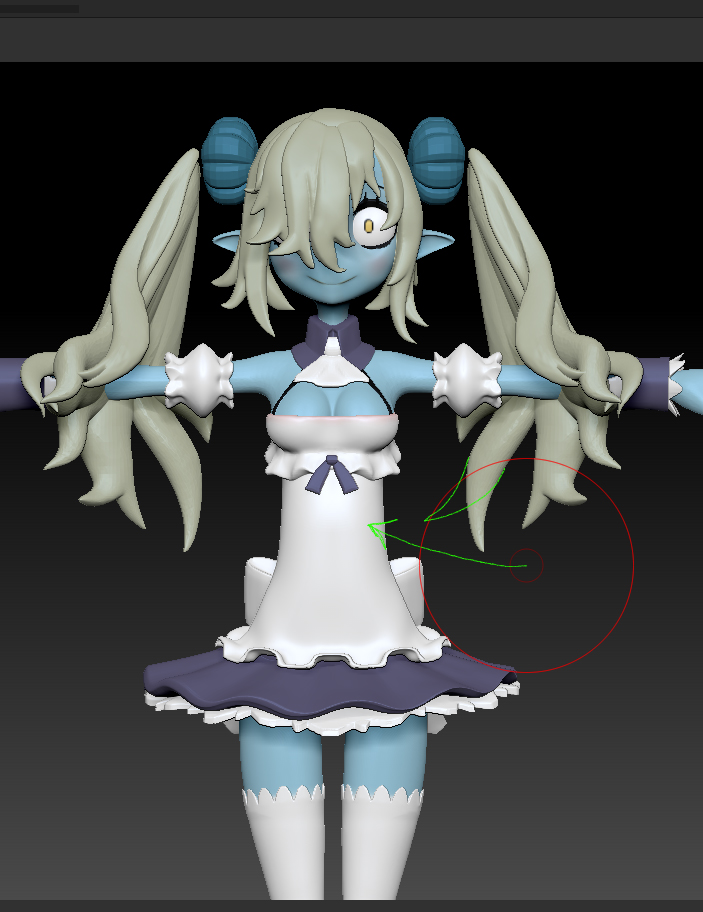

Here’s a scenario, I want to left click and drag from where the cursor is to the left and theoretically bend the hair tip like the outline with the move BRUSH, but instead the program enters view rotation because I clicked into the void instead of on an subtool surface. I could always mask and then rotate the spike tip, but that’s rather time consuming.
A solution I just thought of could be to make a flat plane a subtool and then move the plane to align it with the area I want to move in such a manner.

Ah, then there is no way around using a subtool surface to manipulate.
I’ll try using my flat plane technique instead. Thanks.
