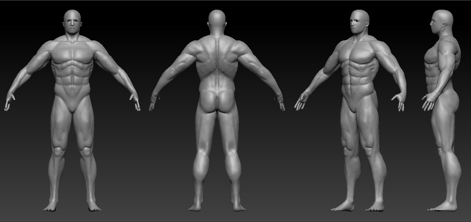

Since long i have wanted to start zbrush and make my sculpts…but things kept coming in my way.Finally i decided to just start with it…and came up with this…Male Anatomy.I want to sculpt perfect male anatomy and want you guys to please guide me.
For this i have taken male base male model for zbrush3.5R3 and tried to just sculpt upon it the various muscle groups.I am looking for making beefy-ripped muscular male guy.Palms and face are still not sculpted and will update this thread as soon as i sculpt them.
looking forward towards your critics and comments.:slight_smile:

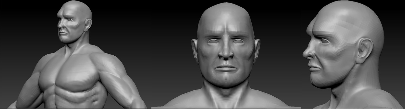

here is a little update, worked on its head and neck.

But I’ll make a couple of comments for you that might help you.
The sternomastoids are way over pronounced and off in proportion for a “muscle” guy. It looks like a tendon running from behind the ear to the sternum, and not muscles.
The pectoral majors do not connect correctly, and are out of proportion and shape, they should tuck under the deltoids, no matter how well built they are.
The biceps need to thin out before hitting the bend in the arm
The top abdominals come out as far as the pecs, no human bodies do this, they should be roughly aligned with the “6 pack” below.
In general I think you might be making a fundamental error of “drawing what you know, and not what you see”… that just means our mental images of anatomy and other things can be easily distorted if we are not focused on real world examples. Really get in and pay a lot of attention to that anatomy while you sculpt and he we will start to look awesome I’m sure.
Best of luck!

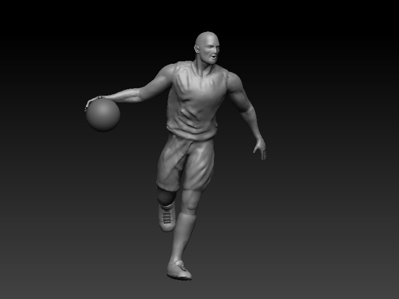

Ahh, finally was able to upload my recent work with zbrush…
let me know what you all think.
I made it in 8 hours and used zbrush default male basemesh.
Updates on my male anatomy will come soon.
