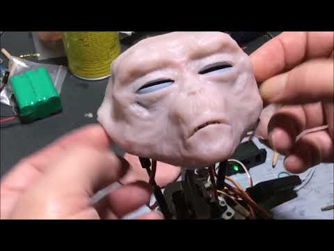

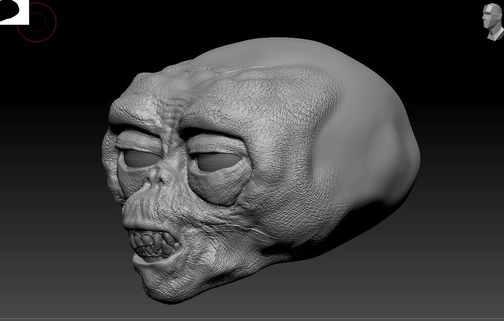

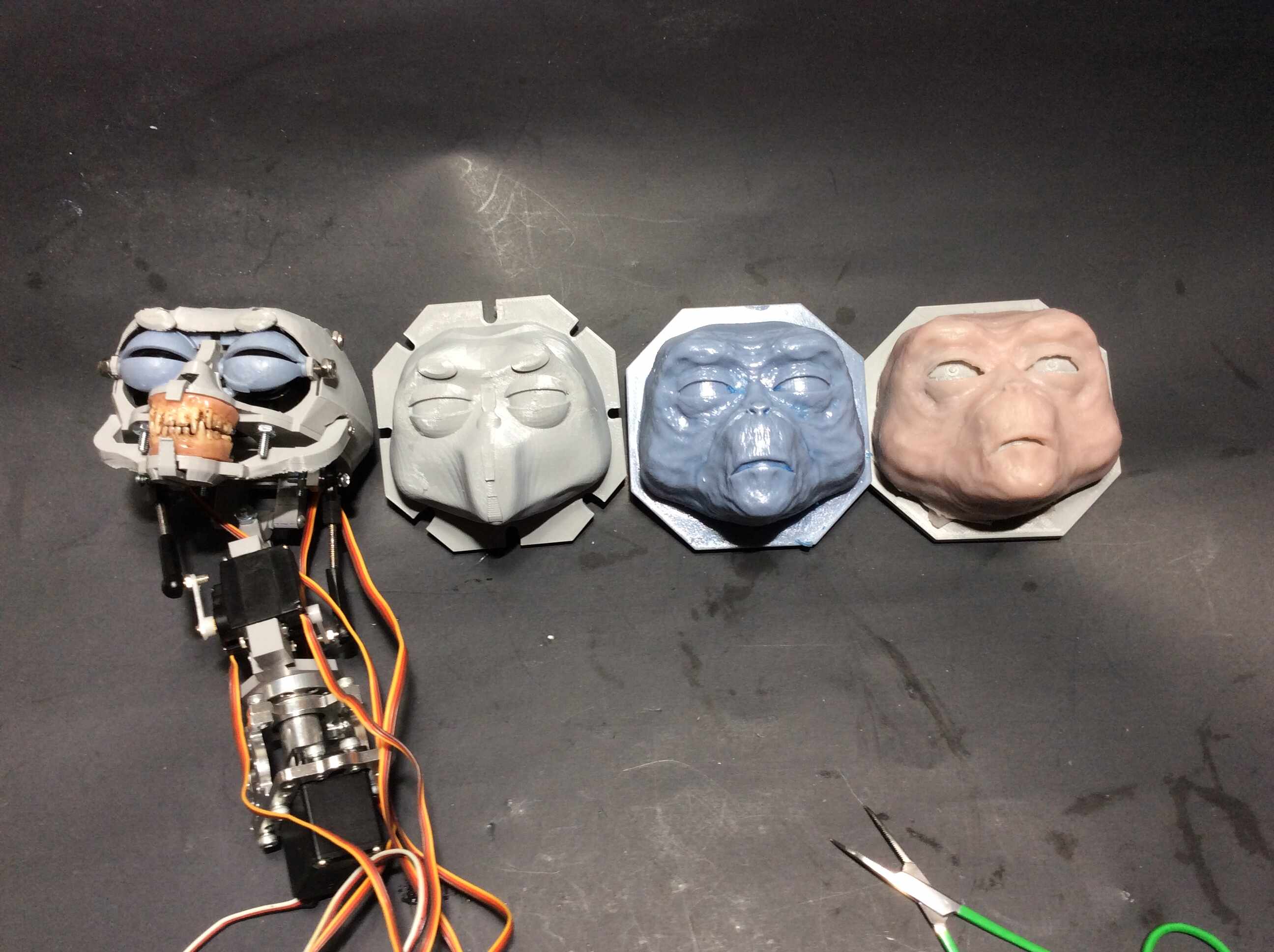

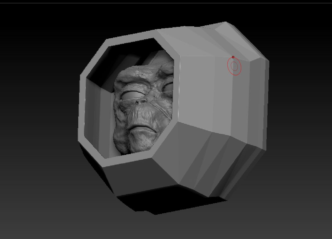

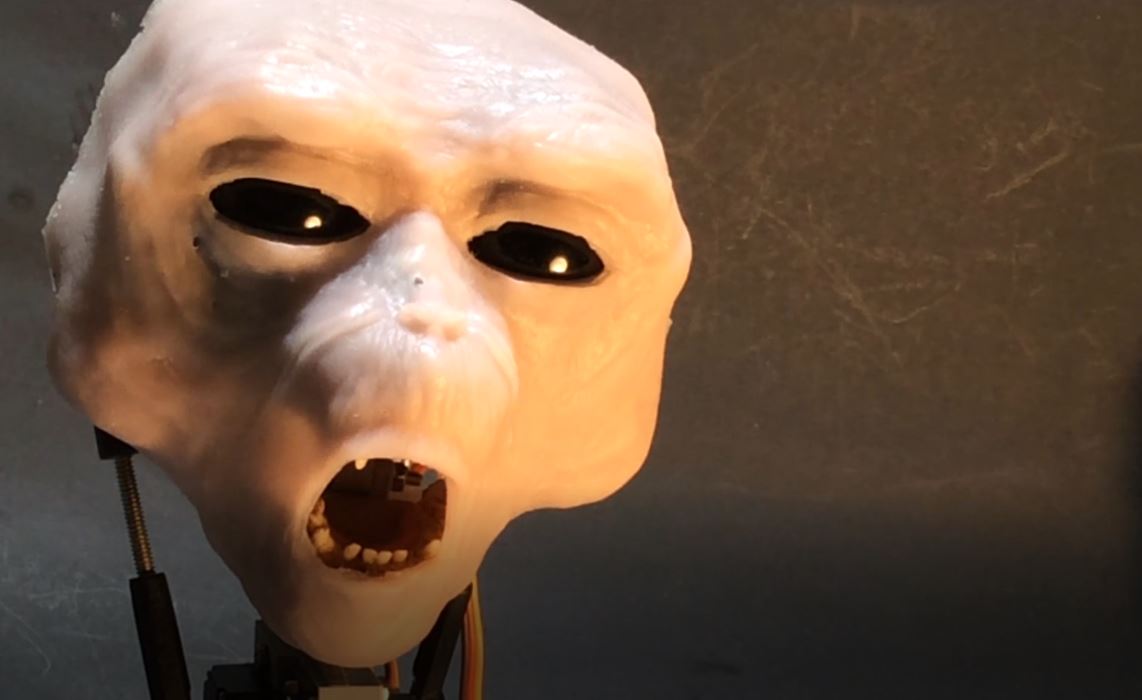

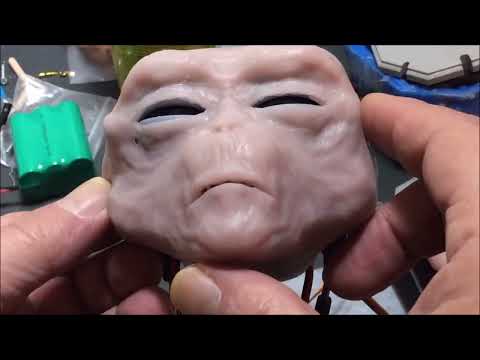

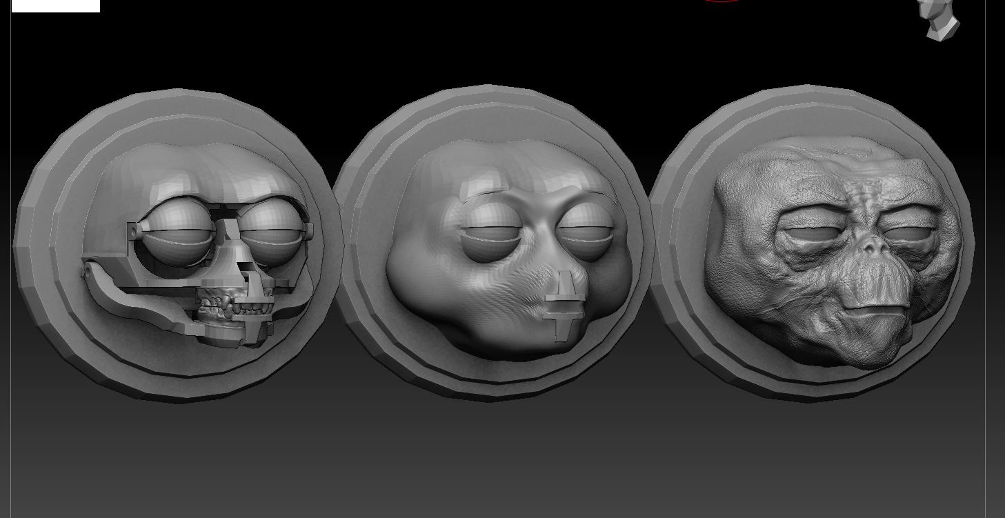

Making zbrush skin 3d printed with FDM and Resin , 6 servos total, 3 servos inside head 3 gimbal .lids and teeth resin printed. #3dprinting, Sketchup design and sculpted in zbrush ,my research of reverse engineering into a digital animatronic process and my resin printer is 90mm wide because of build platform sculpt printed flat. round plate concept digital core blockout design . I Designed the animatronic , made digital core to sculpt on in Zbrush, Molding box for sculpt and using silicone and after curing removed from mold and a mold release was added to the mold, pour skin silicone into the mold and place core into the mold socket, Which this gave me a skin thickness to fit animatronic skull prefect.

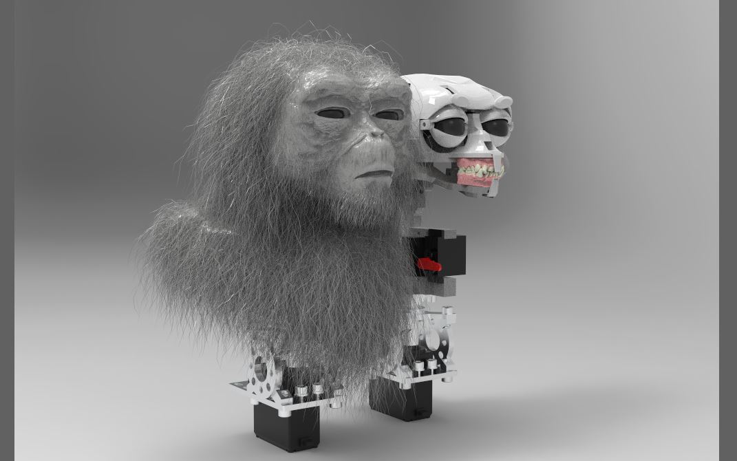

Hair test keyshot render
