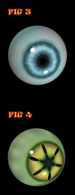

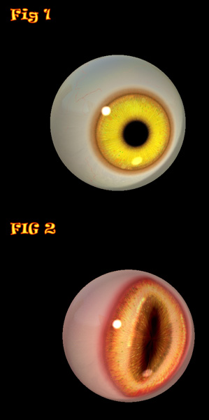

I have included two scripts that will produce the two eyes below. I suggest you turn SHOW ACTIONS on in the script menu and set the delay speed up really high if you have problems following along. Unfortunately I am not a script guru otherwise I would have attempted to annotate the scripts for you. The next step in the process will cover placement of the eyes and the prep/post work I do during that process. The third and final installment in this series will cover lighting and its affects on the other two preceding steps and how I accomodate the image to make it all work.
This file Eye Script.zip will create the eye in figure 1
This file Monster Eye Script.zip will create the eye in figure 2

Ok tried to run the Blue eyes script and it tells me
“to enable sculpting please convert this primative to a polymesh 3d”
I’d love to have this working. any help? :confused:
Dustbin, that’s a Z2 script…this thread got started in 2002 and you “bumped” it.
I had the same problem, thinking Mentat had returned from a long absence.:o
Woops! Sorry to get your hopes up! :o :o :o
Zbrush 2 ya say! no wonder it failed!
But if someone does have a decent method of making say, blue eyes, could they possibly zscript it for us in 3.1?
I had the same problem. I’d love to see this script, but am running 3.1 on 2. Anyone have this running in 3.1? I’d be your BEST friend if I could get this from you! :slight_smile:
