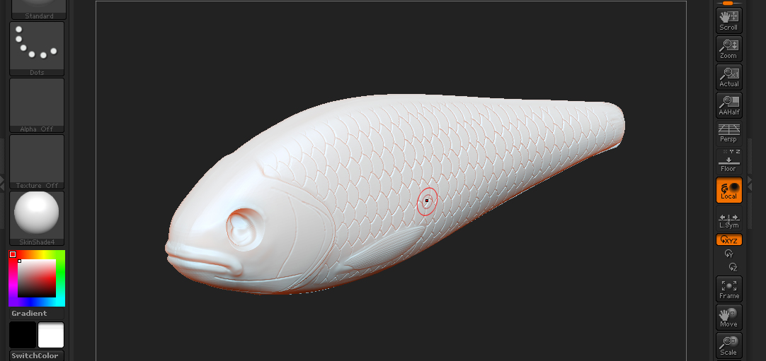

I’ve got a small problem. I’d like to printing my object in 3d printer. The model is full inside and I need to prepare the body model to a suitable thickness (4-5 mm).
Does anyone know any tricks to do this? Can I do that in Zbrush or other program/soft which is special for this task?

Extract. Look in subtools panel.
Yes, I tried but it distorted the outer layer. Either I’m doing something wrong.
I use Zbrush for 3D printing and i do with creating shell. But may be you can find this other free app very usefull for that purpose.
Hereyou can read and watch some videos about it and download

I use Makerbot’s Makerware for my prints and the slicing software will automatically create hollow fills to a given specification.
You could try duplicating your model. Go to deformation and select a negative value from the Inflate slider. Where the mesh gets messy use the selection lasso to hide broken areas. Once hidden go to Geometry > Modify Topology > Delete Hidden > Close Holes. Add a connection to the outside surface and then it is a matter of using the DynaMesh functions to boolean subtract the parts together. All a lot of work, you may be able to achieve what is require from a freely available slicing engine (depending on 3D printer).
