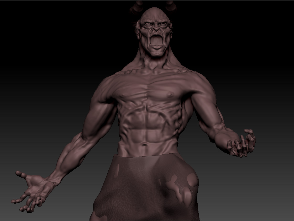

Hey all,
I wanted to do a real dark lucifer sculpt, so here are the beginning stages prior to creating the skin textures. I will eventually add some bat wings after I get the muscles and skin and position I want. C&C are welcome.

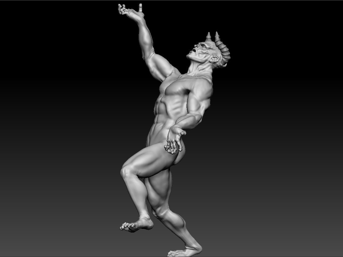

Here are some updates on my model. The balls will of course be rocks later. I changed the position a lot so it looks more natural. I still need to work a lot with the teeth, horns and skin textures. Let me know what you guys think?
Wow, that’s impressive! :+1:
Thanks Eric.
As I work further, what’s a good reference for facial cracks and textures as well for the body? I want to try and make a pretty weathered look, but keep the muscled fresh look, if that makes any sense.
nice start, personally id like to see it more evil :wink:

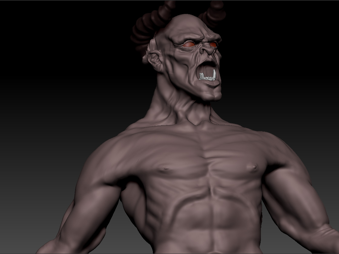

Hosch, Thanks for your comments. After going back to make adjustments, it just started looking better and better. Here are some updates. I haven’t posted his back yet. I know it needs some work, so thought I’d post it and see if I get any feedback before I fine-tune it up. I made him much bonier than he previously was. Haven’t worked completely on the fingers yet, and removed the teeth.
I am honored you took my critique so seriously. I see definite improvement, but there still seems to be some slight “bubbling” of the muscle and skin flow (forearm, stomach/rib area) - I have had this happen on the guy I am working on currently and it was normally from one of two mistakes I was making:
  1. Sculpting in one view for too long - I try to make sure I am constantly rotating the model to get a true 3d perspective - also turning perspective on and off helps me get the objects appearance from more than one … perspective
  2. Also, trying to work too early on a model at a subdivision level that is too high - it seems the more I work at the lower levels the better my work looks when I get to the higher levels - another way to do this is when you want a wrinkle - go down a level from where it looks smooth - create it there - jaggies and all - them move up a level to smooth it - gives a more subtle approach - of course this is not always the goal, but it seems to help my work
By the way - I really like the direction you took the palm of the hands.

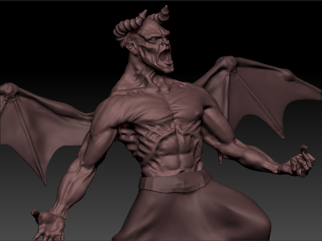

Here is the latest update:
I like it very much but may be the wings are too short larger wings and more look like filled with wind ( some bended wings ) would look more impressive.
I say much bigger wings. The wings can really bring this piece together.
Blaze, Dali - Thanks for the comments. I agree with you both, the wings need to be much more grand. Probably a little booken and torn in some wing areas. I will work on this aspect.
I would agree on the wings - either much, much larger or much smaller and obviously dwarfed for a reason - like he “lost his wings” when he was cast down or something, lol. Never do anything in the middle on a character like this - extremes all the way I am thinking:).

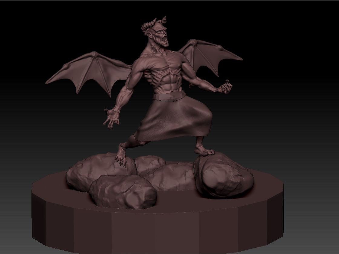

Thanks Hosch. I created some larger wings and smoothes out my character a little bit more…I included some veins on the body, just for some effect.
looks much better with the larger wings. Good work :+1:small_orange_diamond:+1:small_orange_diamond:+1:small_orange_diamond:+1:

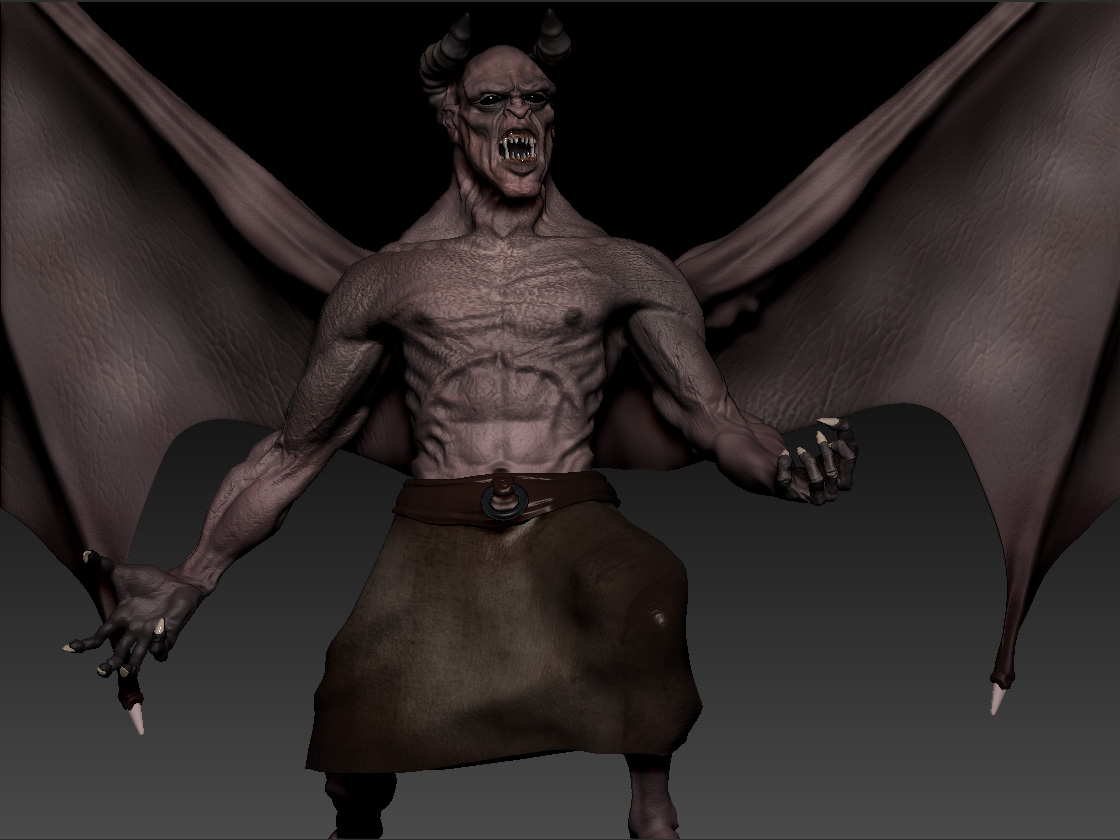

Thanks Nubus. Here is a colored version of my model…I may make some changes, but would like to get any feedback about it. I have not yet spent the time to compose the image in PS, but will work on that shortly.
Hope you all enjoy
