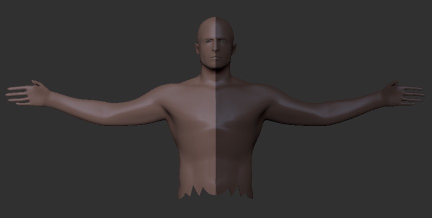

Hey guys… I’m new to zbrush and I started my first sculpt, a human.
Now after a while I somehow lost my symmetry. I know there’s the ‘smart resym’ option but that doesn’t work. I tried all axis. I don’t know what’s happend but it seems like the humans centre isn’t in the centre anymore. I don’t what to do.
Could someone please help me to get my symmetry back?
thnx in advance
remon_v
Try this and see if it works. Mask the half of your mesh that you like and want to keep then do Smart Resym. Also, you might have moved your mesh off center. Press the S.Pivot button in the Transform menu to put it back on center.
thnx alot! I did do a smart resym like you discripe but it didn’t work. After clicking the s.pivot button and then do a smart resym I had succes.

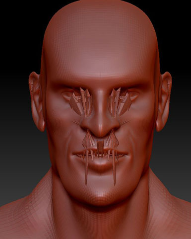

OK… so I still don’t have what I want. But I’m close though. I have 1 high poly mesh and 1 low poly. Now I want to project the detail from the high poly to the low poly and this is what I did:
First I loaded the highpoly model.
Then I loaded the low ploy model and append the low poly model to the high poly model. Now I divided the low poly model a few times and hit the ‘ProjectAll’ button. This worked almost perfectly and I got this result:
Now As you can see where holes used to be theres now spikes :confused:
How can I fix this?
thnx in advance
