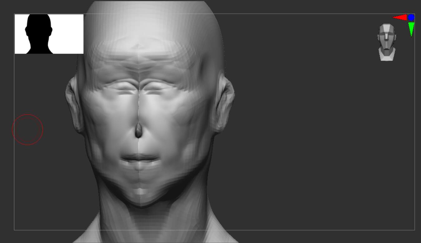

Hi! Thanks for your response! When I mirror and weld this happens:
Make sure that you don’t have symmetry enabled when moving the mesh. The head was not centered. Make sure the head is centered before you click “Mirror And Weld”. When using Mirror and Weld, everything left of center will be mirrored on the right. Just keep moving the head left or right until your satisfied with the outcome of Mirror And Weld. If you still can’t get it, zip and upload the tool (before the mirror and weld) here and I will fix it for you. Just drag and drop the file into text editor you use to post.

I couldn’t nudge the face into the correct position where mirroring wouldn’t distort it. Thank you for offering to fix it but I’m a new user and apparently can’t upload attachments. :frowning:
