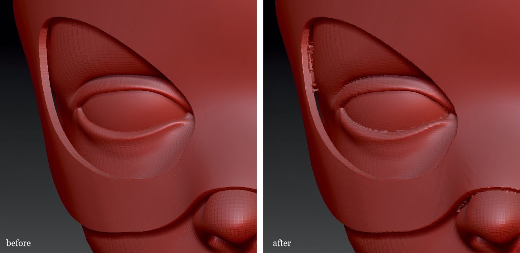

I sculpted a high detailed model and I want to make an 3D-print from this model. I made my model hollow using the ‘make shell’ option, but I had to convert the model first to Dynamesh to make it it hollow. Well, in Dynamesh I set the silder to it’s highest resolution, but it still takes away fine details and gives some unpolished artifacts and some ‘melted look’ on some parts parts when zoomed in close. Is there another way, is this the limitation of Dynamesh I am facing?

Thank you for helping me out. It did not work, but I write down my steps to show where my mistake might be:
-I duplicate my mesh
-Then turned on Dynamesh with project turned off, then I added an ‘InsertCylinder’ brush while holding the ALT key, and selected ‘create shell’. This made the object hollow.
-I subD the hollow mesh 1 time. I stored a morph tager from this hollow mesh.
-Then I selected ‘project all’. But the final results look not perfect. When I select the ‘morph brush’ and hit ‘switch’ I can paint in the details, but they never get any better than when I just use Dynamesh on the highest resolution. (Even when I scale the model 200% to give Dynamesh more detail). All the extra steps make no difference whatsoever…
It might vey well be that the lost in resolution will not show-up on a 3D-print if it is just a smaller sized print. But when I want to make a large object, my concern is that they definitely will show-up. It seems that every attempt to make a high-res model hollow is sacrificing detail with little errors on the mesh on top of that. It will take a lot of time to clean up.
Please tell me where I went wrong. Any other suggestions to retain the exact same detail level when making a model hollow?

I tried the DynaMesh master plugin and it does not result in any better quality than the ‘standard’ Dynamesh’ option. Quality does not get any better than the max 2048 resolution. I am trying for days now, looking for all sorts of solutions, but I just don’t understand why I can’t make a high-detailed sculpt hollow without loosing quality and details… I want to keep the exact level of quality I have.
Very frustrating.
I am working out a solution in Blender to make it hollow, with the help of their Solidify modifier to add wall thickness, but this option intrudes/extrudes my object… Not sure how to solve this.
