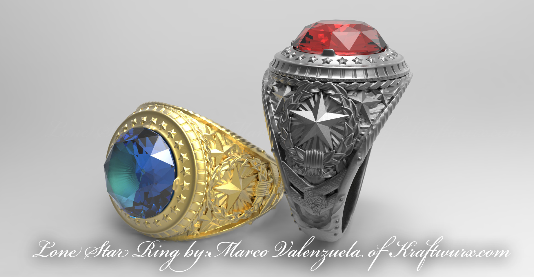

Hello. I do not post as often as I should. But occasionally I can find time to expose some of my design work I am doing for Kraftwurx.com. We are a 3d print company and provide many services for the jewelry industry. This is a peek at a ring I modeled in ZBrush4r4 today at work. It is a Texas themed Lone Star ring. (Texas is the Lone Star State) This model can either be 3d printed directly in metal via DMLS or as we are going to do. 3D printed in casting wax. The wax model will then be used to create an investment cast. In order to cast the ring in gold or another fine metal. Finally a jeweler will polish the
right and set the stone.

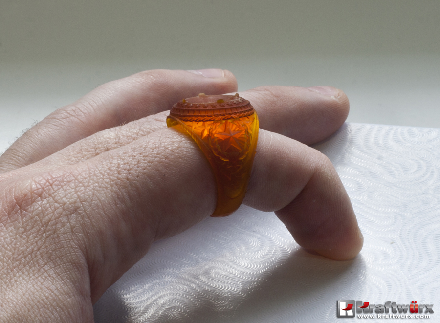

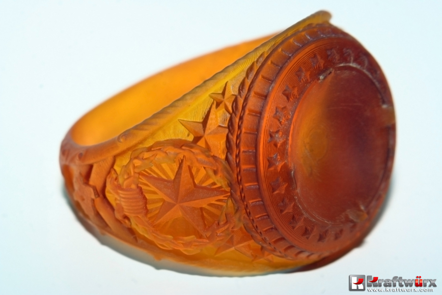

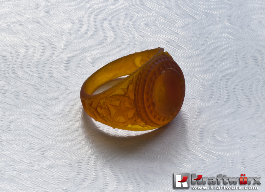

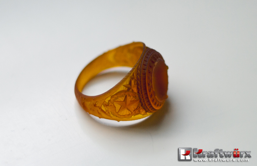

Well I have had the Lone Star ring I modeled earlier 3d printed at Kraftwurx.com. I used “Nano-Detail Amber Resin”. (PIC 100) This material is fully cast-able. I will most likely have the ring cast in stainless steel. Here are some photos of the 3d printed casting pattern.
This Nano-Detail Amber Resin material on Kraftwurx.com is very durable and perfect for final parts such as scale model parts and casting into metals such as gold, silver, etc.
