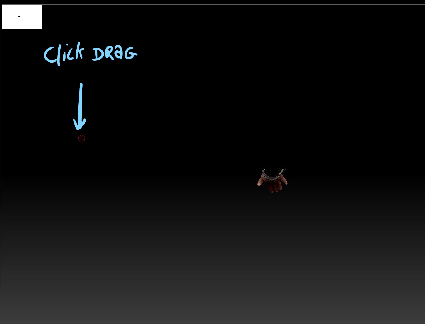

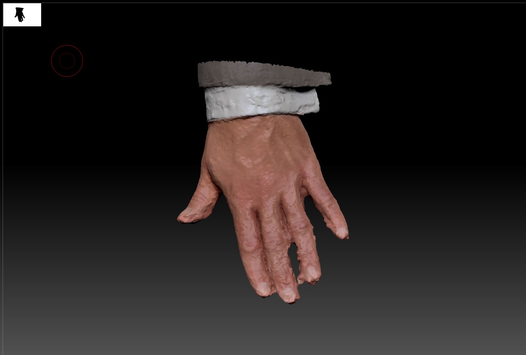

I work with local transformation and I don’t understand what’s happening,
Why it is zooming out when I rotate it ?
I click on the hand to focus camera on it and it work but It zooming out and do weird move …
And this what happening when I do Zoom (it’s work but it’s like a super fast and uncontrollable zoom)
Edit: It is uncontrollable when i’m really close to the model even I disable “Local” transform

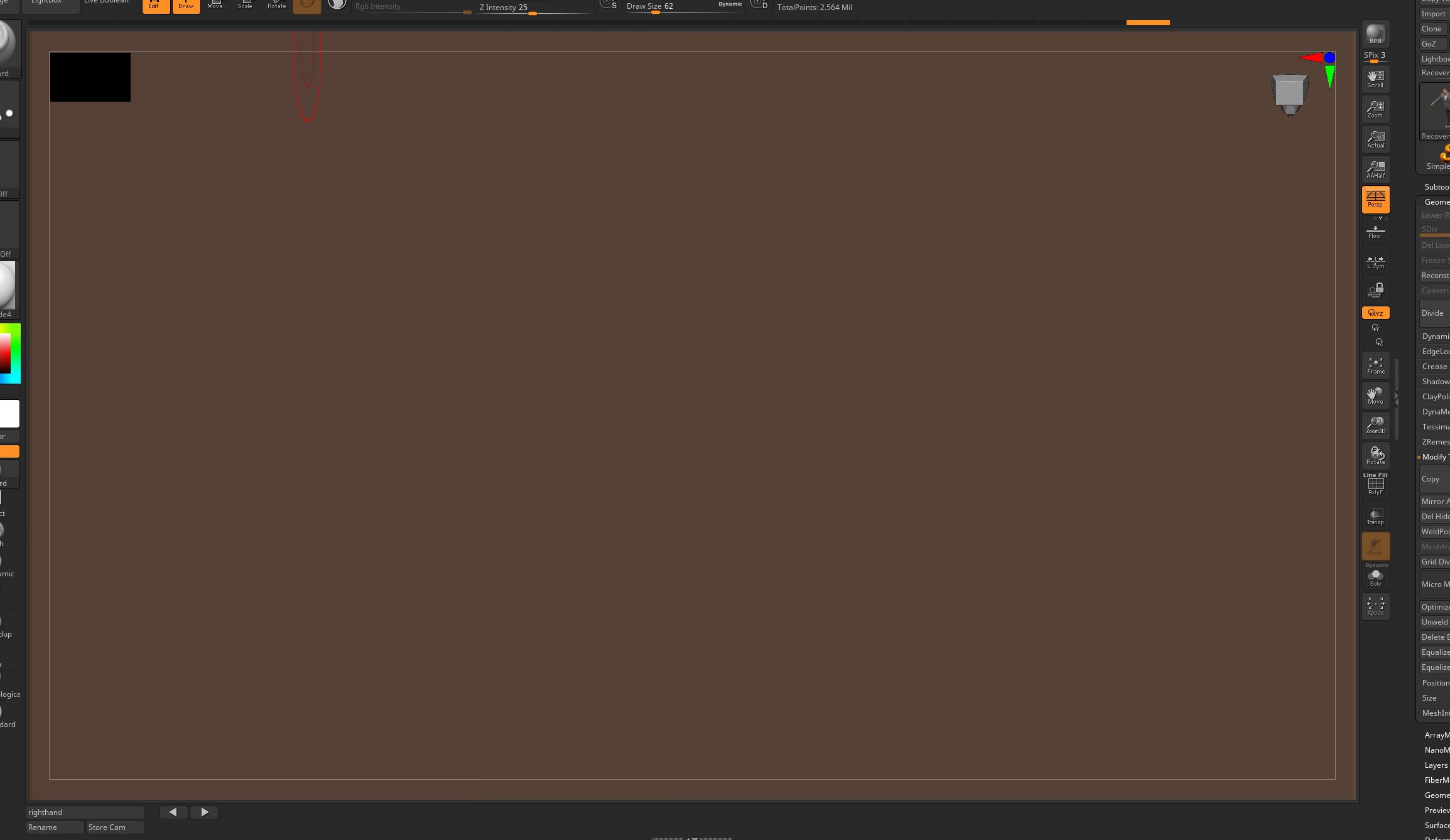

Edit: It’ works a little better BUT if I’m close to the wesh and I rotate it, It disappear.
I press (F) And the mesh reappear so it still here, but with a certain inclination, it doesn’t display anything. Same thing if I zoom in certain part of the mesh.
