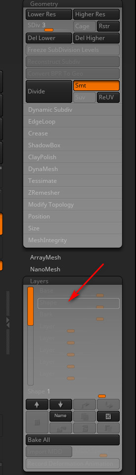

Running latest ZB.
Created 3 Layers.Built model in Layer named “Shape”.
Suddenly I can no longer turn on REC or change anything in it except Rename and delete.
Have I pressed a setting without realising it?
Running latest ZB.
Hello @embalse
Have you changed subdivision levels? Layers “live” on the subdivision level on which they were created. You would have to return to that subdivision level to make it active again.
Hello @Spyndel
Thanks for pointing that out. Returning to the correct  subdivsion level corrected the problem.
