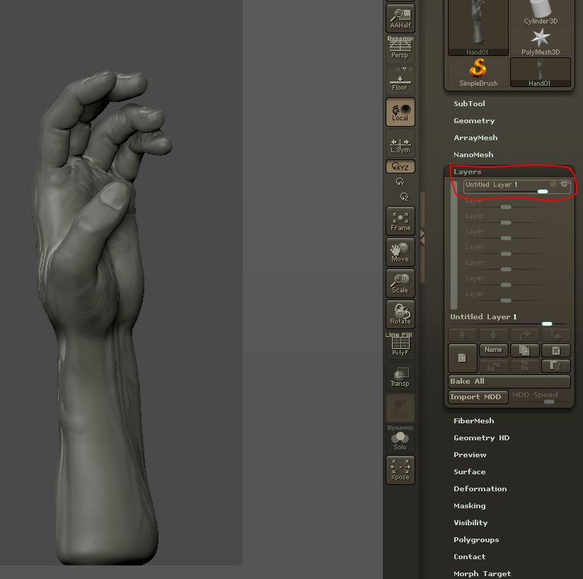

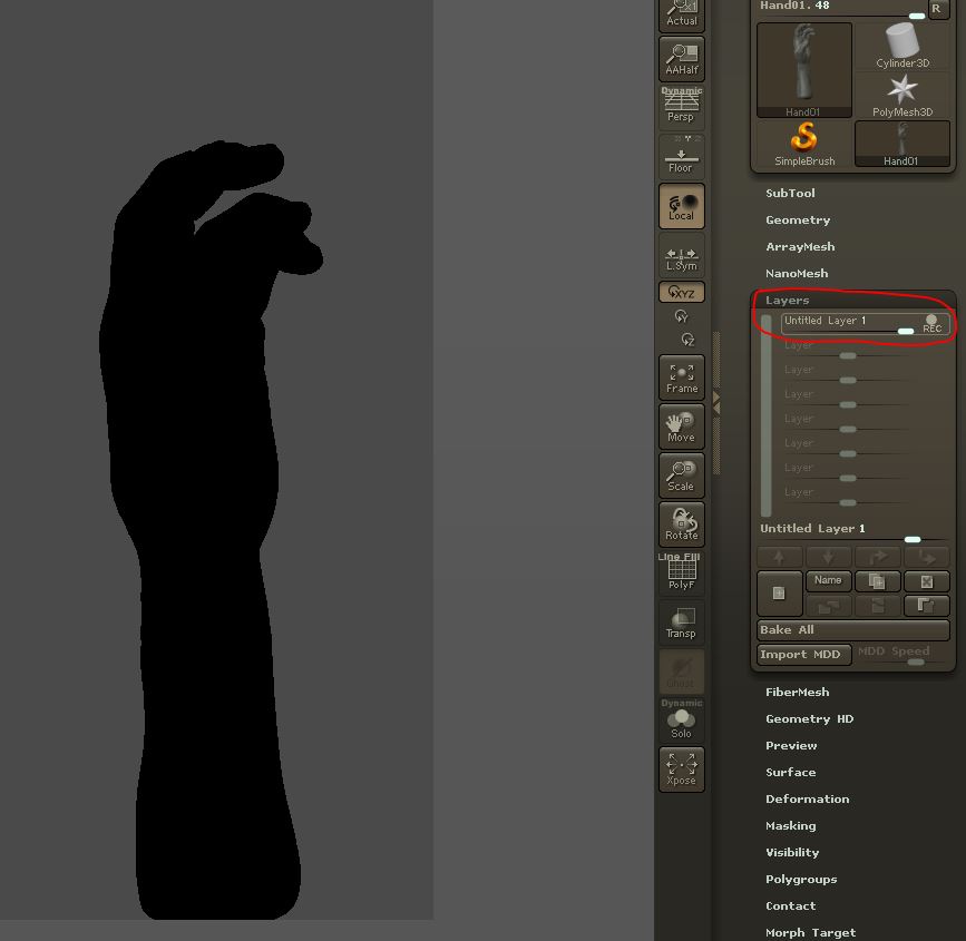

Layer recording makes subtool turn black
Hi, in my file I have just one subtool, when I set a new Layer in the Layers menu under Tool the subtool turns black (a silhouette), so I can’t see any detail or sculpt any more. When I stop the layer recording or delete the layer it turns back to normal.

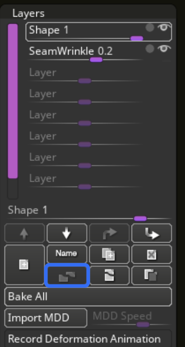

Hello Mike, It’s pretty easy to fix it:
  1. cancel layer’s Record mode
  2. click ‘Split Layer’ in Layers’s panel
  3. delete color paint layer we just seperated.
It’s because there is a ‘paint layer’ inside your layer, so you can not change the model’s color from subtool panel, from now maybe it’s the only way to fix it, and maybe it’s a bug in Zbrush :frowning:
